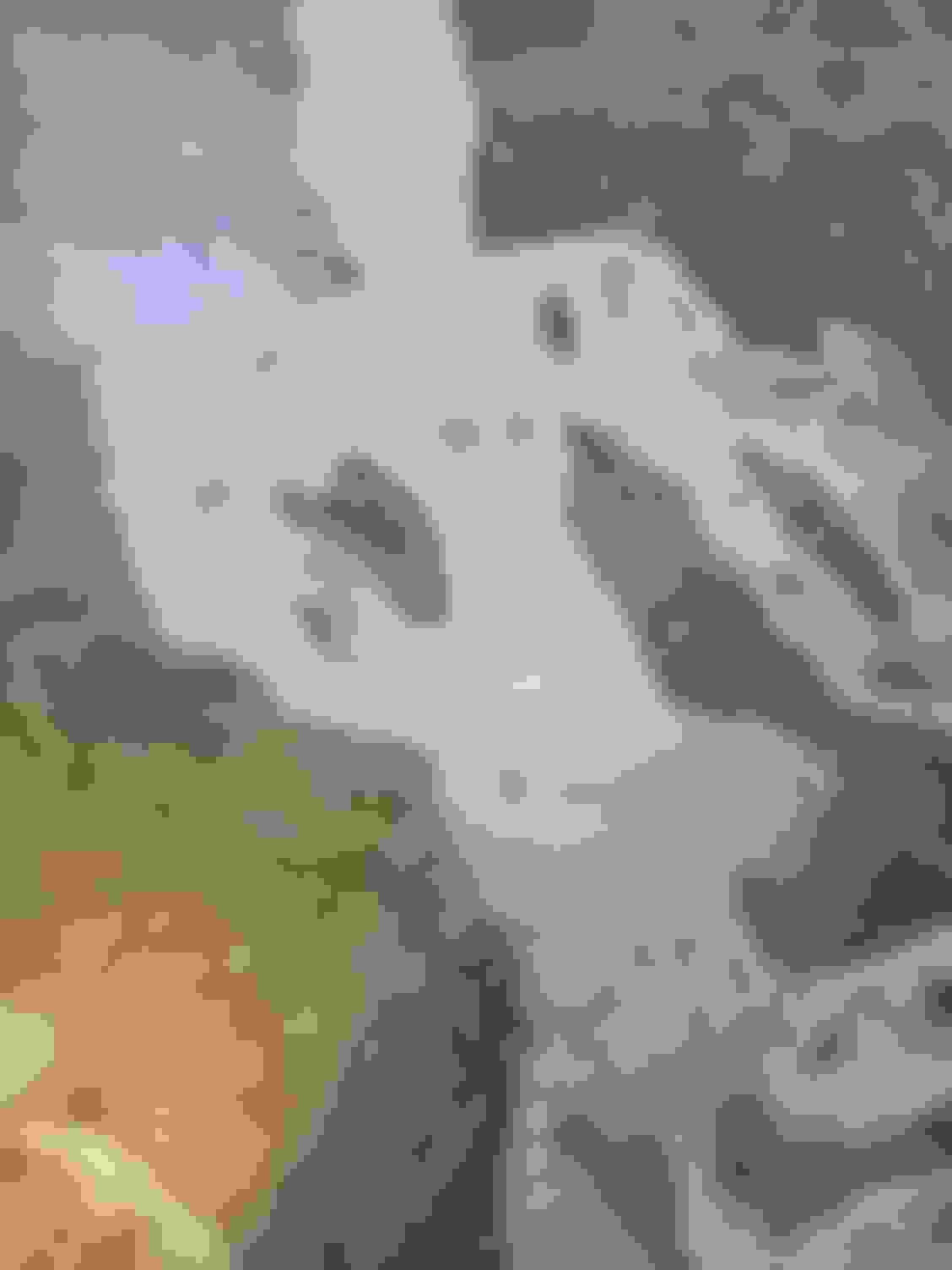

My wife bought a "green" pet / kid friendly alternative to RoundUp that ate through the packaging and ended up etching my garage flooring. How do I repair my floor?
First figure out if your floor is sealed or coated. Put a few drops of water on the floor. If it beads or sits on the surface for more than a minute it is probably sealed. In that case you can thoroughly clean the affected area. Let it dry and then apply new sealer.
Eh, first thing, go back and see what the active-ingredient is, and what else is in the formula. That LOOKS like it's from either an acid (which removes a miniscule amount of concrete) OR a soap / surfactant (which removes the seal / coating.
Worst case scenario, have the kids / nieces-nephews / grandkids / color it in with sidewalk chalk, sign it and don't worry.
Best case? Order another batch of the stuff, get a sponge mop, and wipe the entire garage floor to get a light color. Then rinse and add a sealing coat.
I looked at several products. They all contained a soap product to break down the coating on the weed. Some had salt most had some type of acid.... like vinegar.
Vinegar is probably what ate your floor.
Oh, a follow up- getting back to your INITIAL problem- environmentally friendly weed killer.
"South Philly weed killer" aka "Italian / Sicilian Round-Up" IS incredibly effective.
When you make pasta, as you drain the pasta, pour the salty boiling pasta water into a teapot / kettle, then pour boiling salty water on any weeds in the cracks of the pavement. The weeds die instantly, all the way down to the roots.
When the solution started leaking out of the container, we threw it out. I am pretty sure that the active ingredient was concentrated vinegar.
The garage floor was sealed when the house was built. I am not sure what the builder used to seal it. Is it possible to simply reseal that spot and have it somewhat matched to the existing sealant? Otherwise, it would take me a while to reseal the entire garage...lots of stuff to move around.
Hal, thanks for the note about the Italian Round-Up. I'll try that. Sounds cheap and effective.
The "active" ingredient in vinegar is acetic acid. Just because it can occur in nature or a food doesn't mean it's not a chemical.
The problem is an acid actually eats the Portland cement in the concrete. If you look closely you might see that the concrete is rougher in that area. You can thoroughly wash and scrub the area to remove any loose material and any residue from the weed killer. Let it thoroughly dry. Then coat that area with a sealer. There are different sealers and yours looks like it might be a high build, or wet look type sealer. It won't match perfectly but it could come out looking better and you'd have that area of concrete sealed to help protect against future staining.
