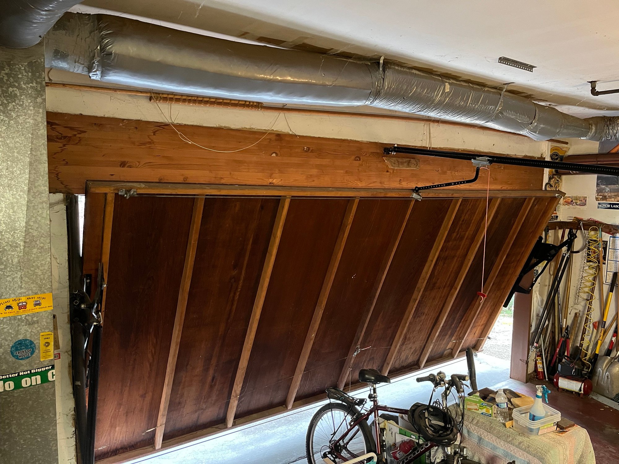

My garage door just before it fully closes is rubbing against the side door frame near the top. There is a brace as pictured running horizontally across the top and bottom of the entire door.
Each end of each brace has a nut to tighten or loosen the brace.
The hinge mounts and the structure of the door all seem tight.
Can I tighten or loosen the nuts to move the door away from where it is rubbing?
How do I go about this without making my problem worse?
Thanks!

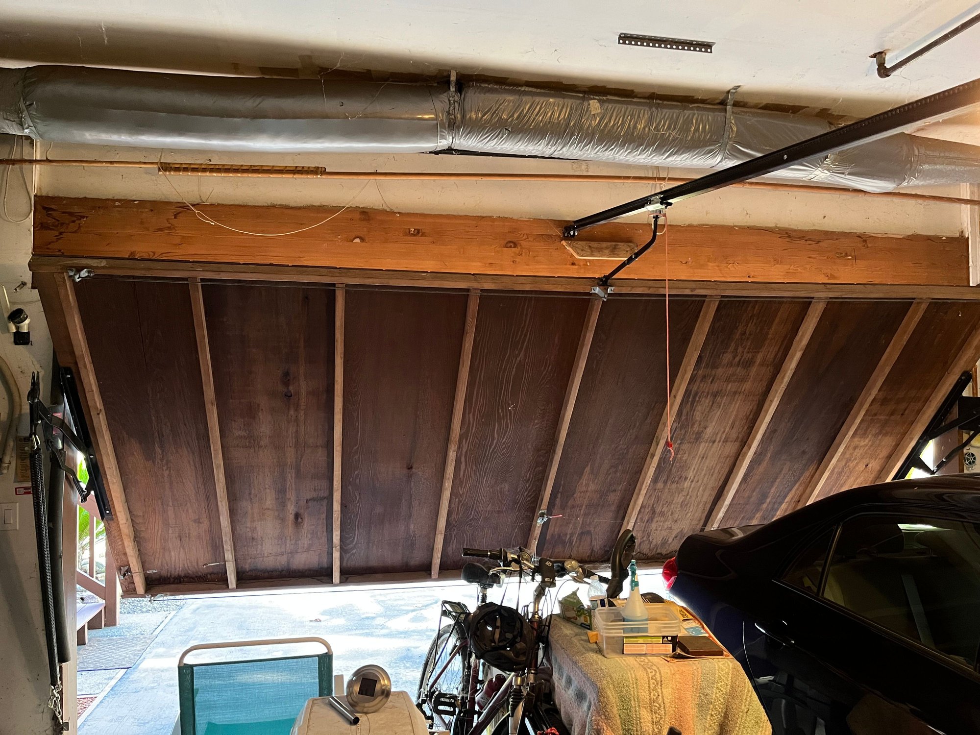

Here are photos of my garage door
Center of door top and bottom has a bridge supporting brace rod.
Hinge assembly and springs
Door open a few inches so you can see top and bottom brace
Open a few more inches

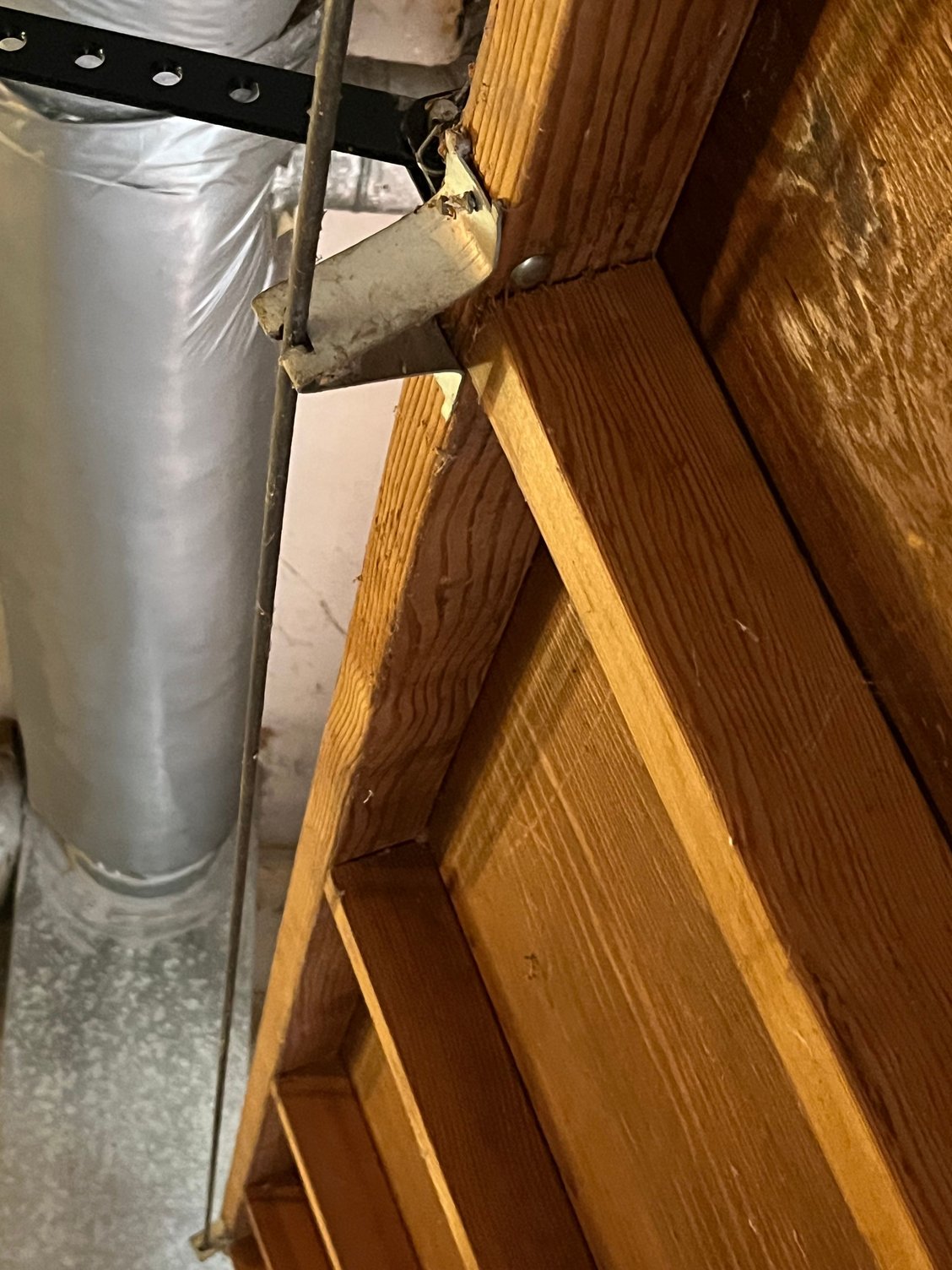

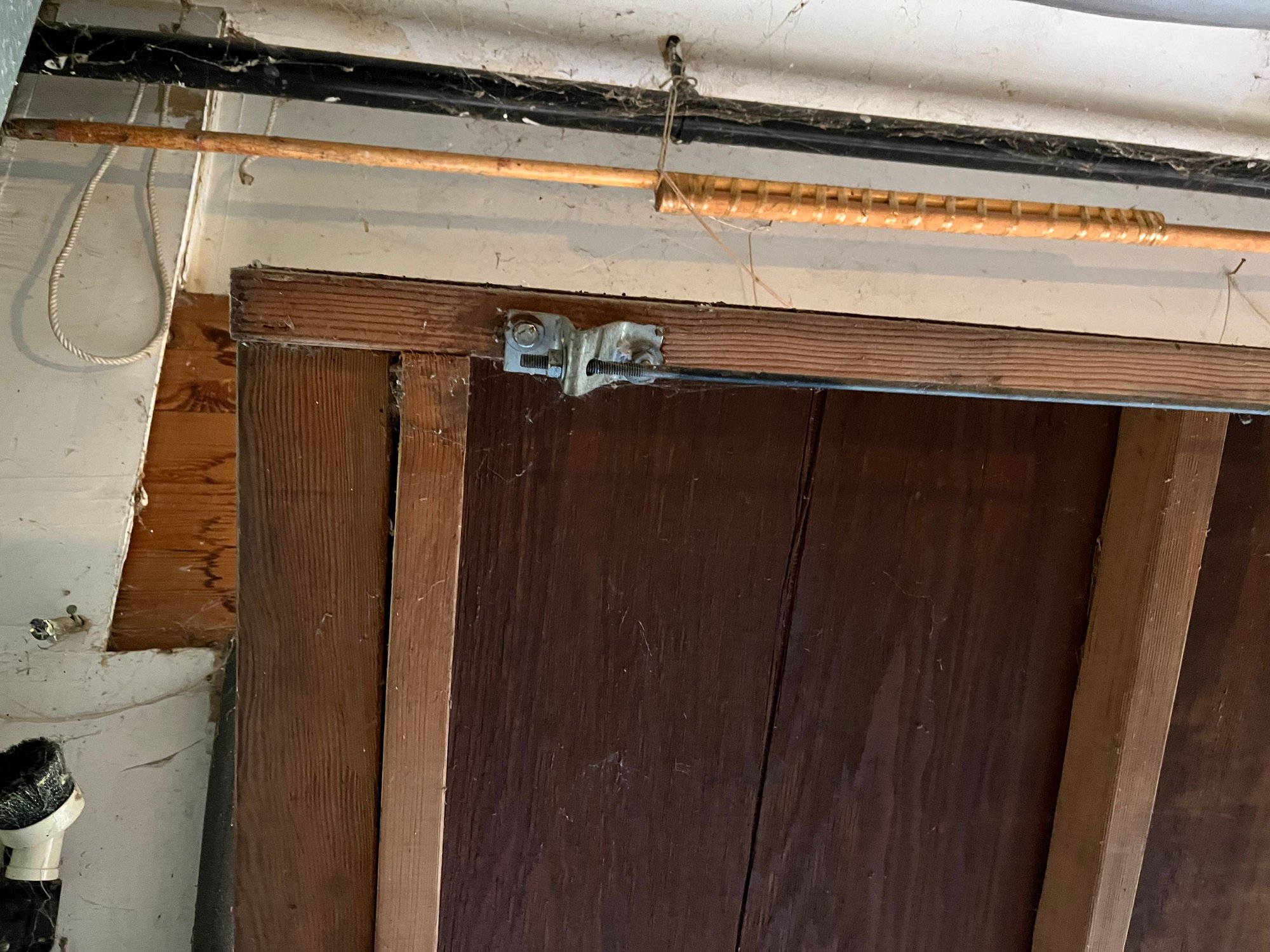

Close up of threaded brace rod, anchor, adjusting nut
The door is scraping the frame on the upper left corner when viewed from the inside. It used to close smoothly. I think I can use the adjusting nuts on the braces to get the door back to perfectly square, but I don't want to just start turning things and making it worse.
The door, the frame and the hinges are all very tight and secure.
I looked at Google and YouTube and didn't find anything that talks about the brace rods.
Thanks again!

The adjusting nuts on the truss rods do not square the door. They provide tension to keep the door straight while laying flat, in the "up" position. If the gap is bowed when it is in the closed position or is floppy when it the up position, that is when you would adjust those nuts.
Your door is either square or not square because it was built that way. There is no adjustment to the door itself, aside from cutting it or planing the edges. Instead, what you likely need to do is square the door within the opening. If your cement heaves, the door will get out of adjustment. Or perhaps the hardware is loose on the door or in need of adjustment.
It looks to me like you have Holmes E-900 hardware. For the best advice that you can both see and hear, I would suggest you watch the video "Installing Holmes E-900 Hardware & Springs", which you can find on youtube. At about the 18 minute mark, he is raising the door off the ground, shimming it up so that it does not sit on the concrete. At the same time he is observing the gap along the sides of the door before mounting the hardware to the door. This is what you need to do.
See if there is more room on the right than on the left. It's likely that you need to lift the door a little higher on the left side, which will move the top left corner of the door to the right. Or it could be that you need to loosen both sides and shift the entire door to the right. Hard to say when I can't look up and down both sides to look at the gaps and see if they are equal. Because it sounds like you have a tapered gap on the left... wider at the bottom, and tight at the top. The right side is probably the opposite... or maybe it's straight. Either way, the top left needs to shift to the right... but not so much that it hits on the right, or hits the header on the top of the door.
Since the door has springs, you need to disconnect the springs to make any adjustments, so be sure you watch the entire video so that you do this safely. You will be loosening the lags that hold the door itself to the hardware. Then you will adjust the position of the door within the rough opening. Then you will retighten the hardware.
You might also want to add a brace on each side (as he does at about 16:30) to help support and strengthen the hardware.
