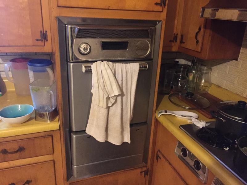

Hello - have been browsing the forums to try and find the issue but no luck so am posting for the first time. I have an old Caloric in wall oven that is currently not heating up. Basically will not start at all. I turn the knob but there it seems there is no ignition at all. I'm trying to at least determine the model number but nothing is listed anywhere on the oven. Does anyone recognize this model from the pictures I've taken?

That oven is from around 1960. I had the same one in the home I grew up in.
The model number should be behind one of the doors but be advised..... Caloric went out of business years ago and there are very few parts around for them.
That oven should have a pilot light in it. You may find it in the bottom of the upper oven or in the top of the broiler section.

If memory serves me you have a "flame switch" type pilot. Take a look and see if the pilot flame heats what appears to be a little bar with a silver tube that goes back to a switch with 2wires attached. Don't you pro's laugh at my description.
