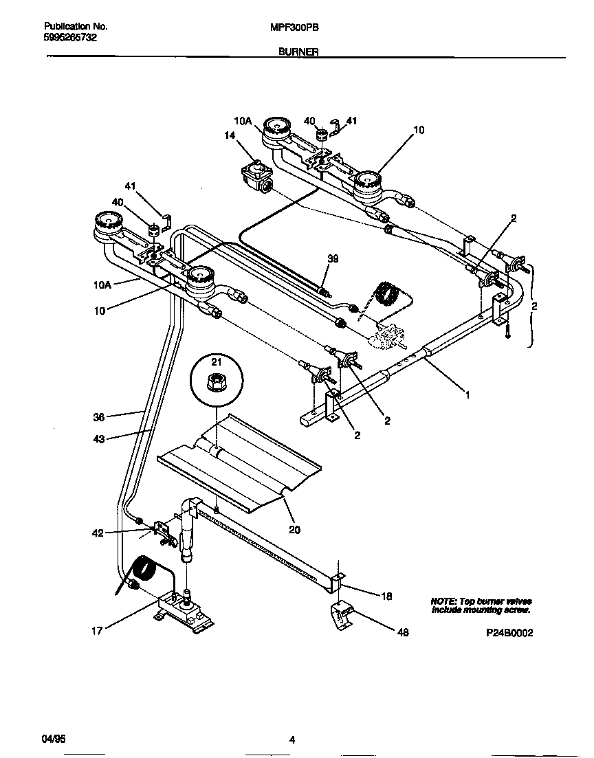

The on/off and temperature control knob of my gas oven became harder and harder to move. I was unable to pull it off to clean it so I tried using pliers to pull it off. This caused a whoosh of flame underneath the stovetop. I was able to shut it off, finally, but a few days later I found the center of the front of the top of the stove, just above the oven control knob, was very hot. I could see a small flame, like a pilot light, under the stovetop.
By turning the knob "more off", whatever was leaking under there stopped leaking and this unwanted "pilot" was snuffed out. Another few days went by with no issues (aside from being unable to use the oven), then I found that flame on again, bigger and hotter. It had caused the control knob to soften enough that it was easy to turn, and I turned it past "off" and again the flame was extinguished.
Well now I am not comfortable having any gas going to that stove at all until I can fix whatever has gone wrong under there. What should I be looking for under there?

Start by looking for a brand name and model number.
I don't know what stove you have so I can't offer specific advice. But... stop using the appliance. Pull the stove out so you can get behind and shut off the gas supply.

I did shut off the gas but first I opened the lid and sniffed around where the unwanted flame was. There is definitely a leak there. Unfortunately the way this house was configured, shutting off the gas to the stove means also shutting off the only source of heat. So I will have to disconnect the stove from the gas line altogether and put a plug in that line for the time being. Then I will photograph the apparatus from which the leak was coming and upload that here.

Here is the defective part. I can't tell precisely where the leak is coming from... I tried using soapy water, spread the juice all over the thing but couldn't see any bubbles forming. The top of the image shows the extension going to the control knob. It was covered in black soot which I cleaned off. Incidentally this stove has not been moved away from the wall since it was put in about 20 years ago (and it was already old back then), nor have I removed the stovetop in at least 15 years. I have tried to move the stove but it will not budge.
The long wide tube running horizontally underneath is the gas supply.
Sorry.... I service these appliances but cannot recognize yours from that picture.
Does this range have a pilot light ?
A larger picture may be a little more helpful but without a model number I can't offer any replacement parts.
It looks like the oven valve is a part of the manifold which means it may not be replaceable.
The entire manifold with valves would cost more then a new stove.

There are two pilot lights for the four burners, plus one pilot light under the oven.
What are the "A" and "B" called in the image you posted?
I will try to get you a photo of the whole underside of the stovetop.
There is actually an A, B and C.
A looks like the oven pilot.
B looks like the oven burner.
C looks like the top side pilot(s).

I need just the model number. I can't read it off that.
I can also see manufactured by ????? for White Consolidated.
I corrected your model number. Your second guess was correct.
That is a Frigidaire stove. Built in 1995.
Not seeing an oven thermostat available...... OEM 5303935014 P1

part #5303935014 oven thermostat is no longer available but maybe an aftermarket part is, or maybe it can be repaired?
There was one listed incorrectly on ebay. A substitute would not be available as that's a custom valve.
Rebuild may be possible. I'll check.
