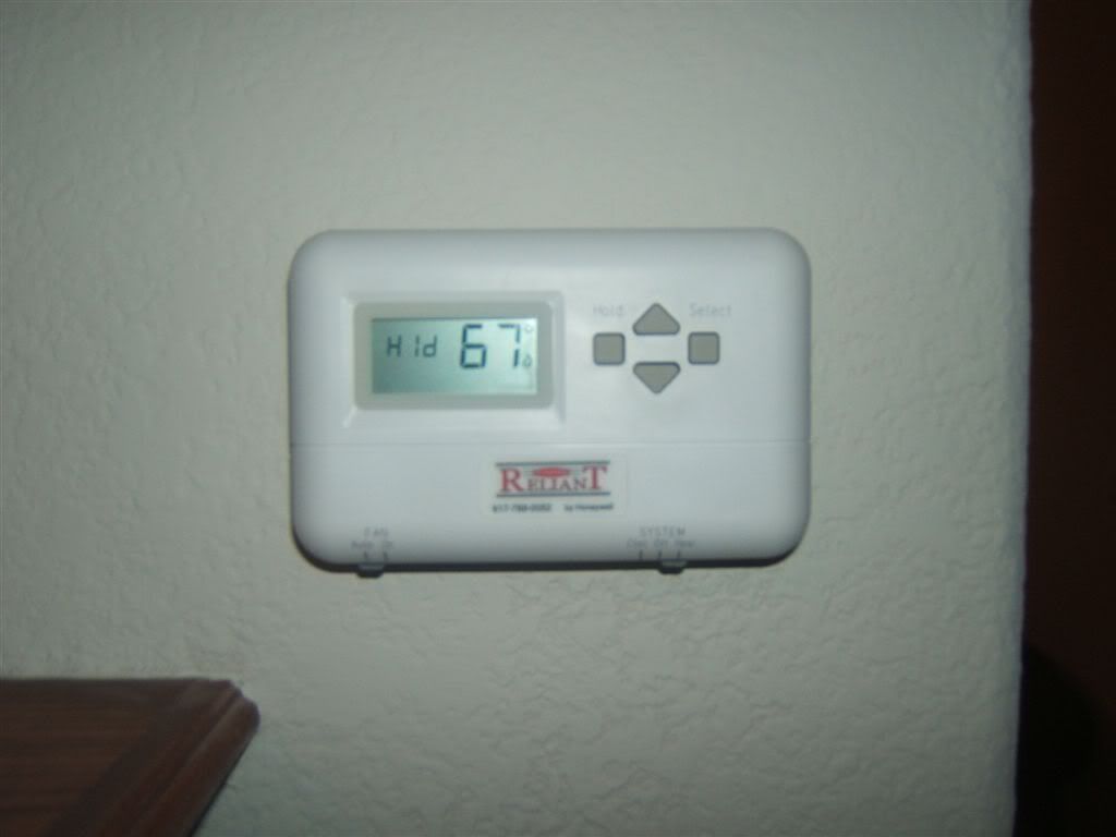

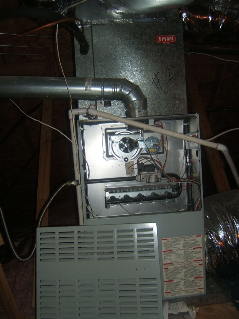

I came home from work and noticed the house was cooler than usual. I checked the thermostat and it was indicating that the heater was on (see the little flame icon on 1st picture). I switched to AC mode and it was blowing the cold air. I switched back to the heater, the flame icon shows up on the thermostat but heather didnít start. I have followed instructions on the unit to star it, however it didnít work. Please let me know what else can I check or how I can troubleshoot. Thanks for help.

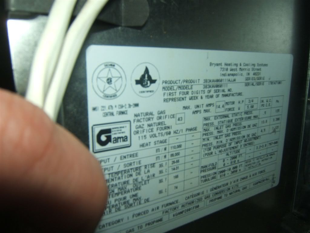

Manufactured by Bryant Heating and Cooling Systems
Model 383KAV060111
Max unit amps 14.4
Motor HP 3/4
Please let me know if you need additional information

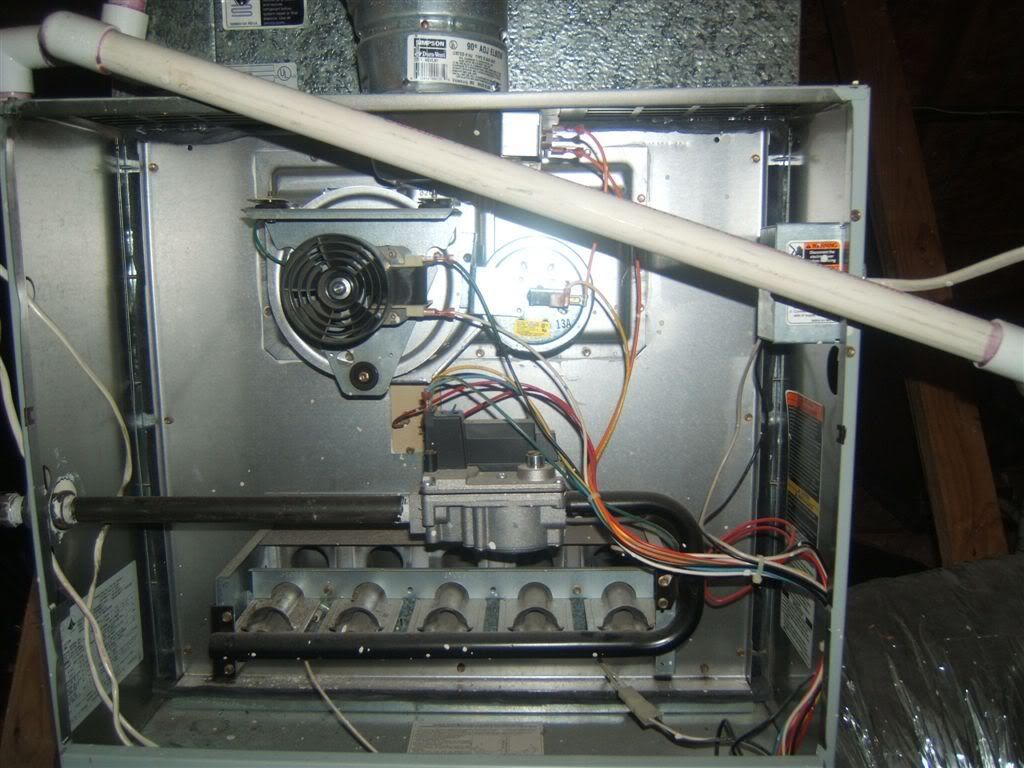

3 short and 4 long blinks: code-34, which for this unit means Ignition Proving Failure.
Most common reason for such is a flame sensor with a build-up of oxide. Simple to solve, remove the sensor, gently clean with steel wool (or very fine-grit sand paper) so it gets back its shiny metal look, and re-install.
In your furnace (see pic below), the flame sensor is at the center of the red circle I have drawn.
I hope this takes care of your problem. Else, give an update in the forum
