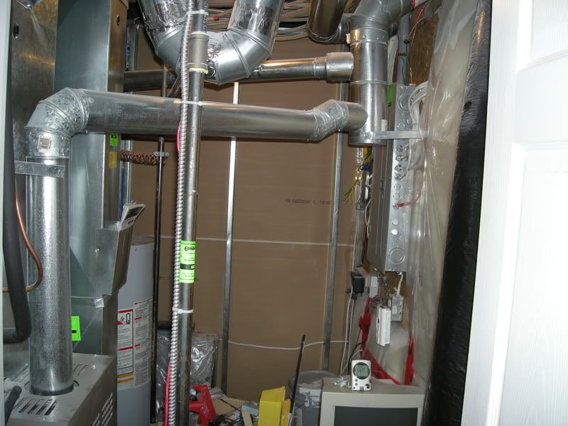

I recently finished my basement and closed off my furnace room. There is a single bi-fold closet door(not louvered) to allow entrance into the furnace room. The room gets very warm as there is a natural gas furnace and a gas heated water tank. There is fresh air intake from outside into the room. The city said my setup was ok, but I would like some other opinions. My carbon monoxide detectors have not chirped yet(1.5 months since project completion). However, when the A/C runs(fan is on high), the bifold door will open up from pressure...?

I had my basement inspected by the city and from what he could tell everything looked ok. One concern I do have however is that I built on the office to the furnace room. You have to enter the office, which is 7x7 feet(roughly) and has a 30in door. To get into the furnace room from the office, there is the 36in bifold door seen above. I placed the return air in the office in the furthest corner away from the furnace.
If I close the door to the office and open the bi-fold closet door(not a likely situation but it could happen) will there be an issue with the return air duct sucking in anything? I've read that you should not have a return air duct in the furnace room. Essentially its not, but with the doors closed/open in that order, its kind of making the office part of the furnace room. The return duct is approximately 8 feet away from the furnace and in the ceiling.

Seeing your photo you got fresh air on the right side, and I can't see what you have for furnace, do you have a newer 90% furnace? (use two PVC pipe going outside)

The home was built in 2004 and its a Goodman furnace. The manual says its "high efficiency" but I'm not sure what percentage. Here is the best picture I could take to show you the ducting. Please ignore the junk in there(the paint cans.... ugh) I'm cleaning out the room today. The funny looking U pipe with the thermal tape is my hot air run to the office, it was the only way I could make it work and since its such a short distance I wasn't too concerned with heat loss.

That an 80% furnace.. I am kinda suprised to see that in that new of home and that far up north.. Here in Minnesota, 90% has to be in new homes, and been like that about the last 10 years.
Couldn't see much of the main duct in the photo, but run your hands on the joints/seems, and feel for draft.. If there's a major leak, then get some duct mastic to seal off the leaks.
Also, you could add a dummy return grill between the furnace and office room to allow the pressure to get out of the room.

My only real question left is - with a fresh air supply that goes into the furnace, and another that dumps to the floor with a 6" pipe, is it really necessary to cut grills in high and low to the furnace room? My city says no, but from reading online some cities in the states say yes.

I would cut it high, that way you won't get the cold spill from the floor.

Your 6" is enough.. The grill is use to let the pressure out of the room so the door don't open up on you.

I've spoke with some other people and they gave me this calculation:
If your total btu's are 126000 and you are bringing all air from outside using 1 opening then it should be located within the upper 12" of the enclosure. For 126000 btu's and 1 opening you would need a minimum opening of 1 sq. inch per 3000 btu/h (126000 divided by 3000= 42 sq. in.) To provide 42 sq. in. for proper combustion you would need a 8 inch round opening ( a 6 in. is only adequate for 28.27 sq. in).
Now my furnace is 90,000 input BTU and the hot water tank is 36,000 input BTU. What do you take on this quote?

If your furnace and water heater has been running fine for the last 4 years with this fresh air set up, I wouldn't worry about it..
Chances are, you have air leaking into your home else where, otherwise, You would of had a reading on your CO alarm.
