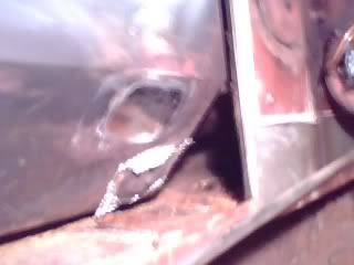

Well, I was sort of joking about searching for more holes, but then I thought why not? Now I think the joke is on me. Here is a pic of the back of the furnace.
That panel is held on by six screws. Guess where two of them are?
That's right. The one place where it's nearly impossible to get at 'em. I think you've helped me inspect this furnace more thoroughly than any tech has since the day it was installed.
While I'm at it, let show you my nice, shiny metal repair.
This will have to suffice since a new furnace this winter is out of the question. And while I'm at it, here's a shot of the path to the chimney. Over or under? After the first two pipes it's knees and elbows all the way. The chimney is behind the cinder block.
I haven't even cranked up the "little" furnace yet. Will keep you posted . Thanks again.

The biggest thing about venting is trying to keep the slope as uniform as possible & NEVER any dips which create a "trap".
Of what is the patch made? If you must use this furnace, get a piece of ceramic fiber (Kaowool), cut a few inches larger than the hole, cover with a piece of sheet metal (24 gauge minimum) cut an inch or so smaller than the Kaowool sheet, & attach with self drilling sheet metal screws spaced about 3/4 to 1" apart. Check the patch frequently.

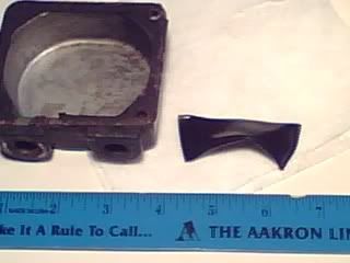

Have you seen one of these before?
Hi Grady:
Sorry I haven't posted in a while. You said I could ask questions about the "little" furnace on this thread, and boy do I have questions. I've been having trouble getting the furnace to run for more that a minute or two. Last night I got ahead of myself in the process of elimination dept. when I thought I saw a dirty strainer in the pump. I pulled the cover and there wasn't any strainer, but I did find this.
It's a piece of flexible plastic about 2 1/2" long and about an inch wide. I think it used to be filled with air or liquid but has now collapsed and become somewhat rigid. It came out of a single stage, 1725 RPM pump made by Webster Electric/A Sta-Rite industry out of Racine, Wisconsin. I found a good pdf file on their website that mentions a noise suppressor being in the cover, but not a picture of something like this. Have you ever seen one of these before? And where did the strainer go? Thanks.
  #54
Old 12-12-09, 05:30 PM
Grady's Avatar
Join Date: Jan 2005
Posts: 14,247
Received 23 Votes on 21 Posts
Webster Pump
Websters don't have strainers. They have blades which are supposed to chop up particles so they will pass thru the nozzle, yeah right . I'd suggest replacing the pump with a Suntec A1YA-7912 (presuming right hand rotation as viewed from the shaft end).
Patriot Supply - A1YA-7912
Webster makes some very good commercial pumps but their residential stuff leaves something to be desired. I suspect that piece of plastic used to be a 'pillow' used to quiet the pump. Websters can be noisy.
In case I don't hear from you before, have a Merry Christmas.

Back in the saddle again
Hi Grady:
Happy New Year. I hope you and all had a nice holiday season. I finally got new parts and the furnace is running. And the culprit was . . . the air bands.
If you'll recall, I had a problem keeping the burner running. I had to resort to using cleaned used nozzles, and actually got longer burn times, but the cad cell measurements were always too high and the primary would eventually lock-out. I hoped the new nozzle would solve the problem, but it didn't.
During that long down time I found a helpful Wayne site. It said as long as the cad cell measured 1600Ω or less the burner should stay on. With the new nozzle I got 2KΩ and it got higher the longer the burner ran. I had already gone through everything on their check list, but I kept coming back to the air bands. They had very little adjustment and the tabs with the bolt would bump up against the burner box if I tried to close them more. I took the outer band off to get a better adjustment and the inner band promptly jumped out of place. But, with a little bit of trial and error, I think I have them on correctly. Now I get measurements between 1000 -1500Ω on the cad cell and the burner stays on. Good thing too, since the temps are now dropping into the teens overnight. I still can't get a measurable overfire draft, stack temp is high, and breech draft is just under 0.02". Sound familiar? I'm not going to worry about that too much now since I'm just happy to feel heat.
One last note. Remember that picture I sent you several posts back of the "pillow" I took out of the Webster pump? I put in a new coupler and the pump started clicking like crazy. You were right, Websters can be noisy. After several attempts at adjustment, I put the old coupler back in.
Sorry it took so long to post. I look forward to hearing from you soon.
