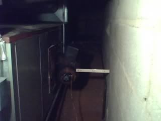

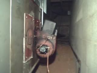

Ok, let's see if I did this right. These pictures were taken with a low res cell phone in a photographically unfriendly location, but I think they'll give you an idea about what I dealing with here.
This first pic should be of the flue. After the second angle it travels horizontally (no rise) for another 12 or so feet before taking a 90 degree turn and entering the chimney. Notice the little bolt near the furnace. That's where I drilled a hole to take the manometer and temperature readings.
The next two pics should be of the burner. That's a ruler propped in there in one picture. Yes, the burner is actually mounted 11 inches from the wall! And the access panel for the air filter - the part you're supposed to replace every three months - is on the other side of the burner.
Let me know if these make it and are any help. Thanks again.
Old 10-26-09, 05:04 PM
Grady's Avatar
Join Date: Jan 2005
Posts: 14,000
Received 11 Votes on 10 Posts
Angry What A Mess
Anybody who would install a piece of equipment like that should be shot with s*** & hung for stinking.
Thermo-Pride makes (or made) that same furnace with the burner & flue on the same side.
About all I could suggest to improve the draft is to install a draft inducer. FIELD CONTROLS, LLC - CONTRACTOR PRODUCTS
The only other option I can think of is sidewall venting via a power venter like this: FIELD CONTROLS, LLC - CONTRACTOR PRODUCTS SWG and POWER VENTING SYSTEMS

Old 10-27-09, 03:30 PM
Grady's Avatar
Join Date: Jan 2005
Posts: 14,000
Crude but effective test
Don't sweat the manometer. It looks like a hole in the pipe (white spot 6"? from the furnace). If that's where you checked the breech draft, that's fine.
After the burner has been running 3-5 minutes, remove the round flame observation door cover & gasket (left of the burner). Take a lighter, match, candle, incence stick, or heaven forbid, burning smoking material, & hold it up to the hole. If the smoke or flame is drawn in toward the oil burner flame, you have draft. Repeat the test after the fan goes off. If you still have draft, you're good as gold.

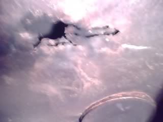

Unhappy From bad to ... the worst
Hi Grady:
I pulled off the inspection cover from the burner side today, and when I did my heart dropped. I didn't even try to open the clean-out port.
I'm going to pour myself a stiff drink and weigh my options.
  #29
Old 10-31-09, 06:42 PM
Grady's Avatar
Join Date: Jan 2005
Posts: 14,000
Unhappy Worst indeed
I don't know if Thermo-Prides of that vintage had the lifetime warranty on the heat exchanger or not but it's worth a call to them to find out. (800) 348-5130
If there is an upside to this, at least you found the problem before serious damage to your life & home. GOOD WORK
I would wager serious money that furnace is WAY oversized for your house & climate. Maybe Thermo-Pride will give you an allowance toward a properly sized furnace instead of a new heat exchanger. Certainly worth a try if the heat exchanger is still under warranty.

You were certainly right about the exchanger. Huge difference in stack temp. Down to 425 or so degrees before adjusting for ambient temp. But, for some reason I still can't get draft at the burner port. Any thoughts?

Some of the exhaust instead of going thru the heat exchanger is coming out that rust hole.
Have you called Thermo-Pride yet? You will probably need the "furnace number" which is on the data plate, I think.

Here's where things stand at this end. The heat exchanger should be under warranty. Unfortunately, the warranty also contains a clause about "reasonable and necessary maintenance". I think that ship has long since sailed. It also mentions the owner pays for shipping and installation costs for a new one and possibly shipping costs for returning the old one for inspection. I think your suggestion about asking for an allowance on a new furnace is a good idea and I will look into it.
Since we have now entered the land of the theoretical, I hope you don't mind if I ask a few more questions.
1) If I plugged the hole in the heat exchanger with a rag (FOR TEST PURPOSES ONLY) and still couldn't get draft at the burner port, where should I look next?
2) I got lucky, if you can call it that, when I removed the inspection cover and immediately found a hole. I know from all the time I spent cleaning the exchanger that some areas are completely inaccessible. How would a tech search for a hole?
Thanks again for your time and help. I plan to start working on the second furnace tomorrow. Wish me luck.

With you and Thermo-Pride both being in NC, shipping shouldn't be too bad. I can't remember exactly where their factory is (Denton comes to mind) but maybe you could pick up the heat exchanger. Just checked, the old memory bank isn't completely broke. They are indeed in Denton.
I wouldn't use a rag but you might try foil tape. Strictly for testing purposes. If you still can't get draft, there are a few possibilities. (1) There is another hole. (2) The heat exchanger is still plugged. (3) With that long horizontal run, you may need a draft inducer.
Horizontal furnaces present special problems when looking for a defect in the heat exchanger. Often it involves virtually un-installing & disassembly. Sometimes a swivel head mirror with a long handle will help us find a defect other times not.
