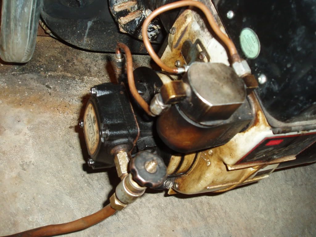

What's the chance of getting some pictures of the the burner & fuel system?
Here are the pics of the burner and oil lines;
Please let me know your thoughts.

The pictures didn't make it. You can post the shots on photobucket.com or similar site & link to them from here.

Hopefully I did it right this time.

Presuming the oil line never goes above the level of the oil in the tank, my first suggestion would be to replace the copper line from the tank to the burner. As crazy as it sounds, I've seen corrosion cause the burner to pull air yet the line would not leak oil. When replacing the line also replace any fittings & make sure the flares are perfect.
If that fails to cure the problem, the next step would be replacing the Firomatic valve at the pump followed by the pump itself. These suggestions are in order of probability & cost.
Keep me up to speed on your progress.

Can't tell from the pictures, but is the fitting on the Firomatic valve a flare or compression? Compression fittings are bad for air leaks.

Good observation, it was a compression Firomatic valve and I replaced with flare one.

Compression fittings are certainly a source of air &/or oil leaks. A flare is a far better seal but making good flares takes practice. Just be sure the edge isn't rolled, cracked, or jagged. Also clean out the end of the tubing & the flaring tool to insure there are no copper particles to damage the surface of the flare. With luck you may have found the source of your air leak. Good catch pfd27.
