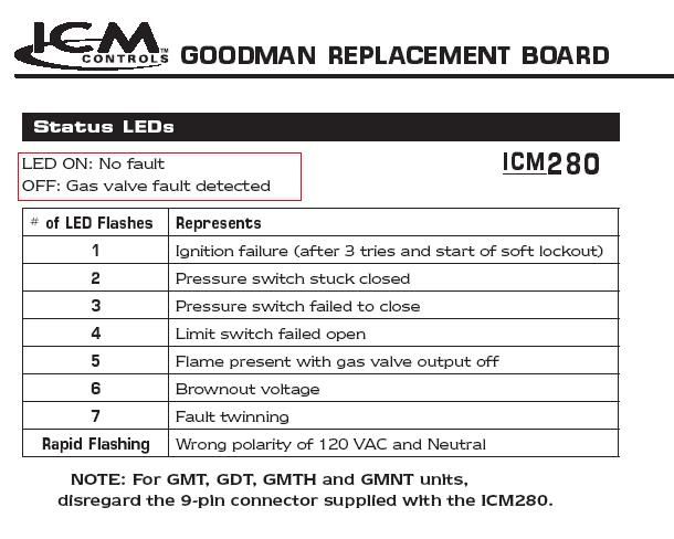

I am back on here again far too soon with another problem.
I have a nearly 7 year old natural gas furnace located in the attic of my 2 story home. It's a builder-grade furnace made by Goodman. I have other gas appliances (water heater, stove) that work fine so the house's gas supply is ok.
The problem is that my furnace does not light up at all. There does not seem to be any gas flow to the ignitor.
* control board status light is ON (normal operation)
* thermostat calls for heat
* inducer blower kicks on
* HSI glows bright
* blower and HSI turn off and status light turns OFF. No gas ignited.
The status light does not blink any failure code. It's just OFF.
I read the York furnace thread which seems to describe the same problem.
Because of my previous problem I had a spare gas valve on hand. Swapping the valve did not change anything. While it is possible that both are bad, I think that is unlikely, especially since the status light did not have 1 or 5 blinks which would tell me to check the gas valve.
Is there any reason to think that my problem may not be a bad furnace control board?

Steady “OFF” - No power or internal fault
Steady “ON” - No fault found unit functioning properly

status light: 3 blinks
equip. problem: pressure switch failure to close
check: venter pressure switch; vent blockage
So it looks like the control board got that one right. The sequence never progressed to sending power to the HSI.

http://www.icmcontrols.com/downloads/ICM280-ig.pdf

I was surprise to see that no LED could indicate a gas valve error with this board. I wondered if an error would display without the valve connected or if it would blank out again.

Yes --- with these ignition controls most of the diagnostic lights are checked with small currents to see if various witches are open or closed.
So--- if a limit switch opens a diagnostic code is generated.
If the flame sensor detects a flame when the gas valve isn't energized --- ditto.
If the gas valve fails to open, the flame sensor isn't going to detect a flame when there should be one, so you'd get a diagnostic code for that.
But the gas valve isn't tested directly, only indirectly as just described.

What does the diagnostic code chart on this furnace list for no LED is what I'd like to know. I see what this ICM replacement board is, and I know what it commonly is.

Got a link for a furnace circuit diagram that uses that ignition module? I'd like to see it.
Thanks for pointing something out to me I've never seen before.

Do you know what's being tested by that diagnostic code and how it's being tested? I could certainly imagine a small current being passed through the gas valve coil to verify that it hasn't burned out.
But turning the light OFF sound pretty non intuitive. Why not add more blinks?
If you turn the power off to the furnace, aren't you going to get no light which then suggests replacing the gas valve?
Just doesn't sound like a good diagnostic code. But there it is!
I'm guessing that I've seen that list of codes but never noticed the additional codes at the top which you point out.
Again, thanks for an education.
