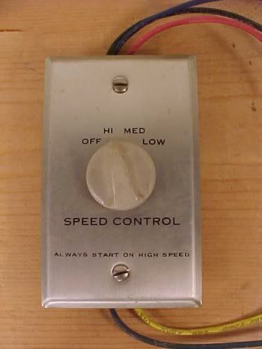

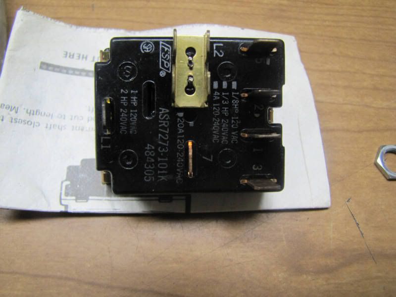

I do have a question about fan speed , my fan can do 3 speeds but only one wire is hooked up medium fast.
Can I use this Carson Speed Control Electrical Switch
or
this NEW FSP ROTARY SWITCH 484308
to make a manually changeable speed controller for my furnace fan motor to vary speeds winter summer?
thanks
