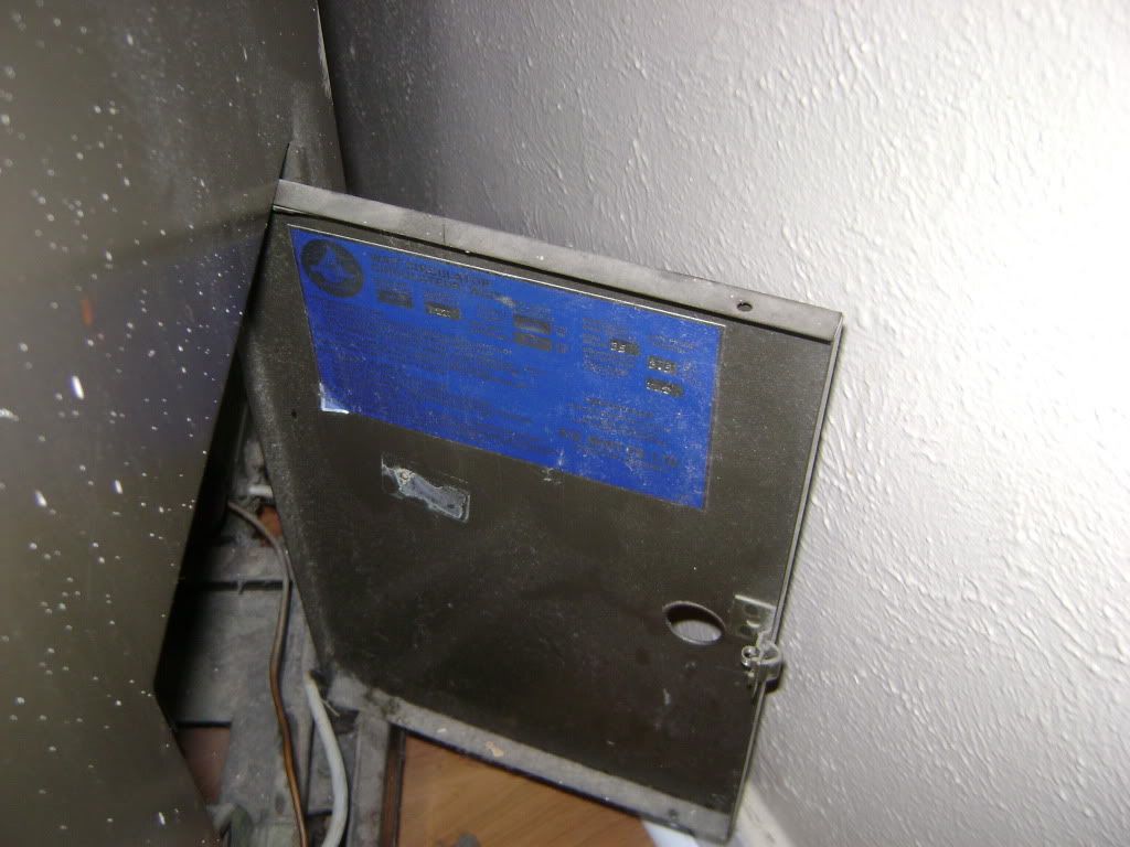

Okay, so my girlfriend and I moved into an apartment earlier this year with a B. D. Wait Co. NW-35 Circulator. Recently the temps outside have been dropping off slightly, so we've wanted to heat the place up a little. We called our landlord to find out how to light the pilot, but he had no idea (the long story made short is that he inherited the building a few years ago from his father-in-law without any real instructions); he said that the local gas company always lit it for him. So we called the gas, and they flat-out refused to send someone down, saying that they haven't provided that kind of service for at least ten years. After that, we broke out the phone book to look up a contractor, but being that we live in a rural area, the closest heating/cooling agency is at least 45 minutes away, and would charge some astronomical service fee. So I'm hoping you guys can talk me through this.
Like I said, the unit is a B. D. Wait Co. NW-35 Circulator; I'm not really sure how old it is, but I know Wait has been out of business for at least a few years. It's been pretty chilly lately, about 0-10 degrees during the day and about 5-10 degrees colder by night (Celsius, I'm not really sure how that translates into Fahrenheit). It's a natgas heater, and it only has a 1-10 dial on the back of the unit to use as a thermostat. There's a panel on the right side of the unit that has some pretty vague instructions on it, but nothing on how or where to actually light the pilot.
If there's anything else you guys need to know, just tell me. Thanks a lot! =)

Anyway, here are some pictures:
the front of the unit, not much to see really; we tried fiddling with the front panels, I don't think they come off.
This is the famed side panel with its oh-so-vague instructions: "1. Turn knob to 'pilot' position, depress knob, light pilot.
2. Keep knob depressed for one minute, and release. If pilot is burning, turn knob to 'on'. If not, repeat no, 1 and 2.
3. Set thermostat, if fitted, to desired room temperature.
NOTE: If pilot goes out, wait 5 minutes to relight."

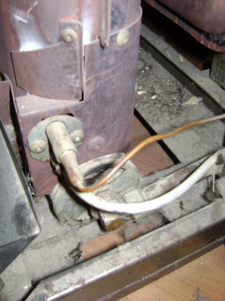

The guts.
This is a closer shot of the base of the heater. The little hole down there is where we were trying to light this thing earlier, to no avail.
The aforementioned "knob" and dial-thermo. Being that the unit is placed so close to the wall, managing the lighter AND depressing the knob can be pretty tricky.

Are you at ALL familiar with gas heaters, even gas water heaters, and know what the gas valve looks like, and if you can see about a 1/4 inch aluminum pilot tube come out of the gas valve and head into where the heater fire is made? If so, you could look to see if there is any access hole/opening to reach a "long match" into where that pilot tube goes.
If you see such a place, do not attempt to light it yet. I am curious if you see any old matches in there. Often, if people have to manually light a furnace or heater, you will find spent matches down inside where the end of the pilot tube winds up.
If you do not see something like that, it is possible you have a piazzo ignitor or some other sparker device, or some electronic device that fires it up. Burners that have sparkers to set off the fire usually have a taller(maybe 1 inch) cylindrical shaped push button either attached to the side of the gas valve or remotely attached to the heater in an easy spot to get to. This push button is different than that of say a lower profile red button that sits a top a gas valve.
With pictures, as Furd mentioned, then everyone familiar with gas valves in general, could maybe identify how yours does light.

Ah ha! You do have an old fashion standard, light it yourself, pilot system with a thermocouple. Go to your picture number 3. You will have to remove that one screw above the pilot tube to remove that little tiny 2 inch? panel to reach in there with a "long match", and do what the instructions say. Do not depress the gas valve button for any longer than it says, and if unsuccessful lighting, allow 5 minutes between re-lighting attempts, to allow the built up gas inside to ventilate.

ECMAN51!!!! You are a genius!!! It lit on the first go!!

Some more info, only because you may find it interesting too: the reason the instructions say to keep the knob pressed during the lighting process is to allow the thermocouple to warm up. When heated, the thermocouple allows electrons to flow, and the furnace "knows" the pilot is lighted and permits gas to keep flowing- it's a safety feature to prevent gas flow if there is no pilot. Keeping the knob pressed allows gas to flow during the warmup.
