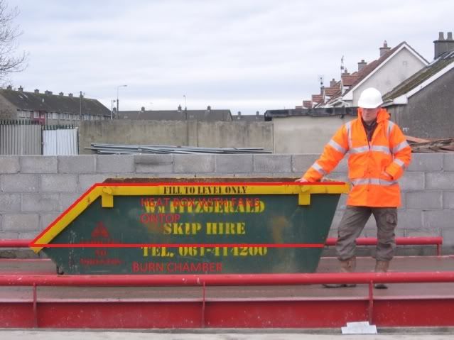

The workshop is away from home some miles away, it is steel and corrugated construction and stands on its own.
The owners of the building (I rent it out) are very easy going when it comes to what you do in there, next door has a furnace he has made himself from a small skip (its a monster furnace) he uses to heat and heat his paint spraying booth.
This is the type of skip next door used for his furnace, he welded up straight along to form the burning chamer and put a seperate chamber on top with two big air movers pumping air out the top seperate chamber, heated by the fire below it.
Let me see... find a picture
Skuse the mess thats when we just started to move in as you can see its got a very high roof, and takes alot of heating. Since this was taken a tarpaulin has been secured off the raffters and loads of bubble wrap layed on top (10" in some places) So the roof is fairly well insulated.
If you look on top of the cupboard on the left, you'll see the propane heater I have... It does naff all
BTW ignore the 2CV, its not mine! I own the Capri
The workshops about 12Lx10Wx14H? (its a long way up)
Unless that tarp is SEALED to the walls around the edges it is doing almost nothing. With no insulation on the walls, no real insulation in the overhead and the high ceiling it is like trying to heat the great outdoors. Hopefully the air leakage through the building is somewhat controlled.
Honestly, what you need in there is RADIANT heat, what you get from a glowing object. The radiant heat will warm the people and objects without being wasted on warming air. (It doesn't have to be glowing hot but the hotter the object the more heat it radiates.) I would be more inclined to making a stove that was placed in an area where it could radiate heat throughout the shop. That may not be entirely possible but it should be investigated.
As for the stove itself...successfully burning wood requires a fair amount of air and a grate on which to burn the fuel. Just tossing the wood in a barrel will NOT result in an efficient fire. You need a grate with the majority of the combustion air (which must be controlled) coming under the grate and through the fire. You then add sufficient "overfire" air to burn the gases liberated from the wood as it burns. Anything else WILL result in a fair amount of unburned fuel going up the exhaust stack as smoke. You also need a pretty decent draft (draught, for you, being British ) which means either a tall chimney or some kind of mechanical draft fan. Burning wood efficiently is not as easy as it first may seem.
