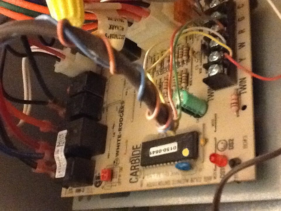

My Honeywell circular non-programmable thermostat went blank the other day. It would not display or turn on the AC/fan. After initially just thinking I'd have to change the tstat, I did some googling and realized that is probably not the issue. I pulled the face of the tstat and used a multimeter to test R-Y, R-G, and R-W, and all read 00.00. However, I have very little experience with a multimeter. I have a horizontal mount gas fired high efficiency furnace in my crawlspace. I seem to remember that when it was working, there would always be a light that I could see through a little glass circle on the blower enclosure. That is no longer lit. Can't find manufacturer on unit, but may be a Goodman. Any help would be much appreciated. Here is a list of things that may help you help me:
- Checked 5 amp fuse on control board and it's fine
- it does not have a float switch. It was emptying onto the rock in my crawlspace, until I encapsulated the space and ran the condenser and furnace drains into the sump pit.
- I reset all breakers
- The local power control (light switch) for the furnace is turned on.
- The furnace is about (8) years old

In the pic below I have drawn two red arrows pointing to the leads on your transformer.
Using your voltmeter..... you should measure 120 vac on the white and black leads (left side) and 24 vac on the orange and looks like brown wire (right side).

Thank you for the clear instructions. I'm getting 124V on the left side and 00.00 on the right.

blown transformer....................................

In your hijacked pic below..... you'll see I circled the brown cable that goes to the compressor. The red and white wires go to the compressor thru that cable. Check for 24 VAC right there.
If good.....go out to compressor and find where that brown cable enters the unit. The red and white conductors will probably be connected with wire nuts. Check again there for power.

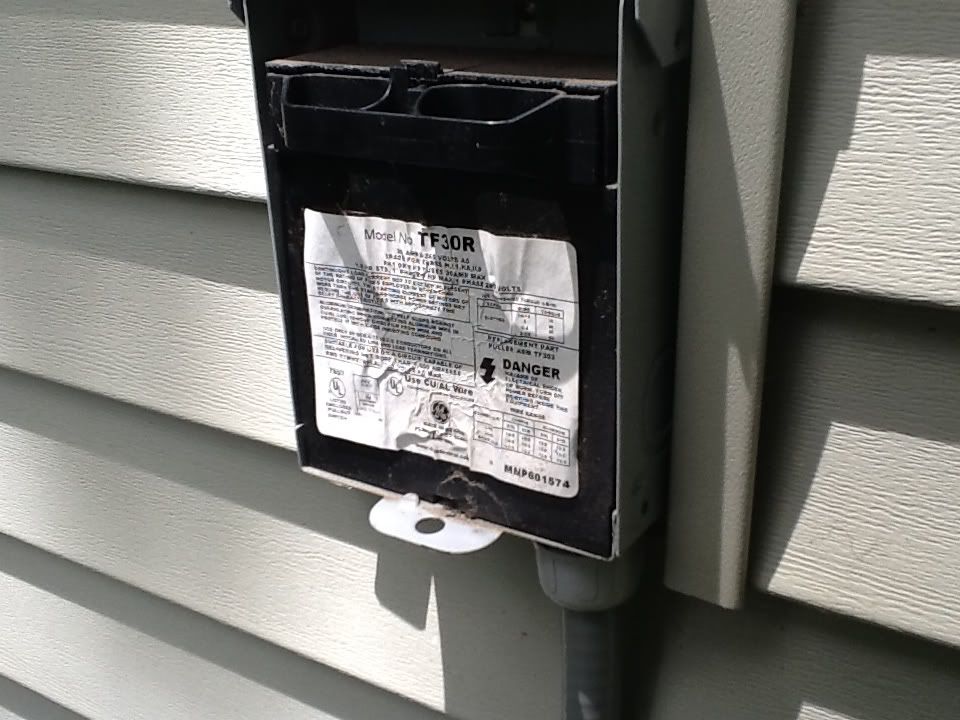

On a related note, the contactor area in the AC unit had a lot of spider webs and bugs in it. I wanted to give it a good cleaning, so I tried to pull the cut off switch mounted near the unit. I ended up pulling the enclosure off of my house. Is there a technique to pulling one of these out? Also, it would be fairly easy to change out the red/white wires that go from the control board to the AC unit. Should I just change those out?

Thanks for letting us know. I would replace that fuse with a 3A one.
It appears that the vinyl siding is fairly new on the house. That floating service disconnect is a common site. The workman pry the unit off the wall and then allow it to float there. The screws are usually just laying around inside the box. I would try to remount that box or have it done. Power must be turned off at the main panel before opening that box.
