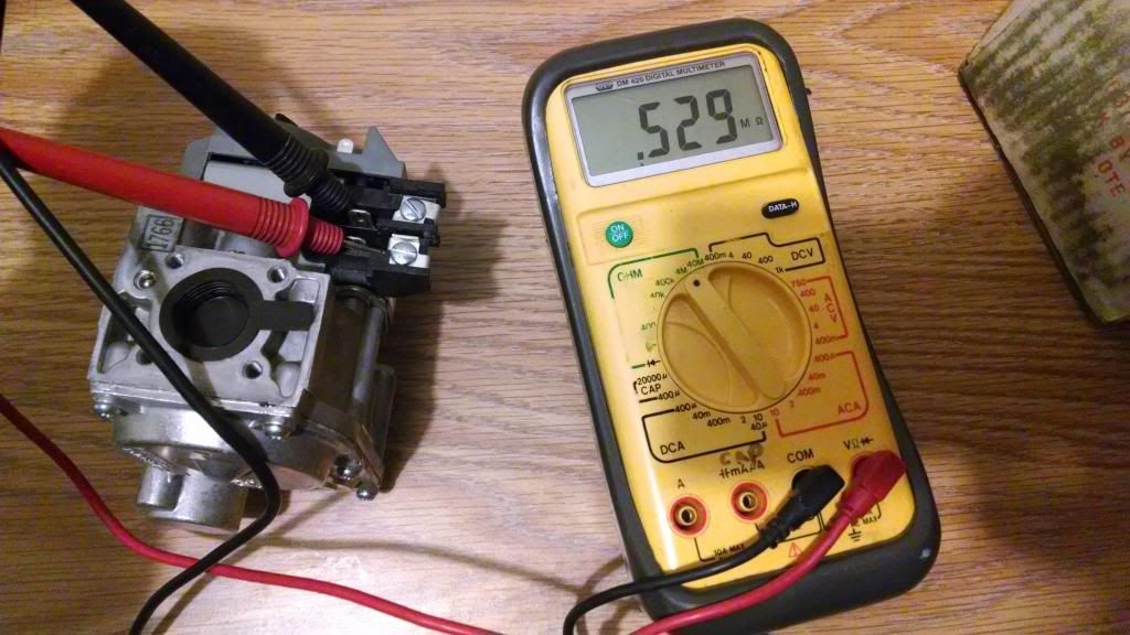

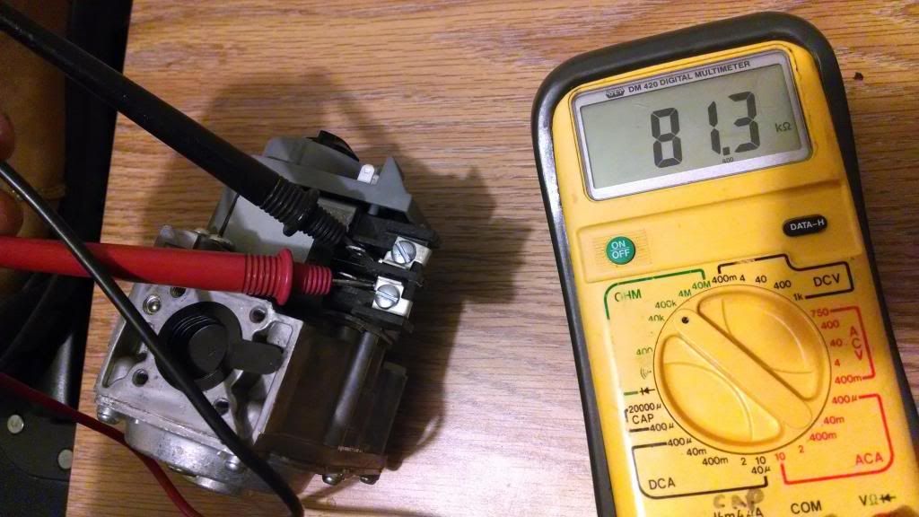

ohms 20k is 0.1 - 0.09 for the spades on the valve control screwed into the gas box . the wires read 0.9 ohm both on ohms 2M and 20M.

I only want the valve readings.

okay, ohms 20k is 0.1 - 0.09 for the valve readings like in your pic. is that good or bad?

Our readings are very far apart. I am leaning toward a bad valve as well.
The valve that I am reading is a standing pilot model.
Tomorrow I may be able to get a reading from a Carrier 58PAV or a 58RAV.

I just checked with Gray furnace man and he says that the gas control valves that use HSI won't give reliable ohm readings because of the electronics inside. so maybe mine is okay. but I'm worried about the 14 volts that have been constantly going through it. I will disconnect a lead for now.

do you agree with Gray Furnace Man that it might not be possible to get a reliable ohm reading off of my valve control switch
I can believe that your valve would have a different reading that the standing pilot valve that I measured.
