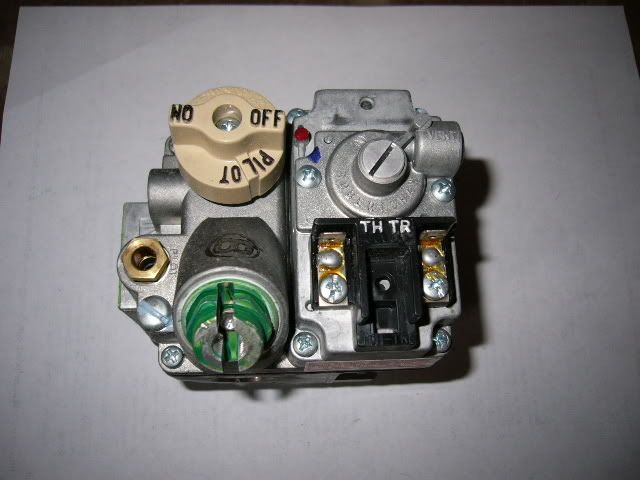

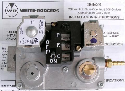

where's the gas valve? on the gas box with the blue knob for gas on/off or is it the silver diaphram located higher up to the right? (that might be the pressure switch). please advise.
Old 12-15-13, 10:49 AM
Houston204's Avatar
Join Date: Oct 2009
Location: Texas
Posts: 6,521
Received 94 Upvotes on 87 Posts
The gas valve has the blue knob. It looks like valves either have a knob or switch, not both.
Here are some gas valve examples...

the control valve is the black unit screwed into the gas box right? that's where I've been working with the wires..............

Actually, if you are in millions that is probably a good reading. Is Ohm 20K an option on your meter?
