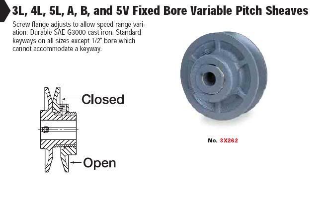

Received 95 Upvotes on 88 Posts
It did not have a load on it before.
You can lower the amperage by opening the pulley with belt drive motors.

If you have a seven amp load and install a 6 amp motor it will still pull 7 amps.
You can reduce the load by opening the pulley 2 turns.
You would need to adjust belt tension afterward.
You want 1 inch of belt play. Do not over tighten.
The inlet and outlet temperatures should be measured 2 feet from the furnace to verify that we are not exceeding the rated heat rise listed on the furnace nomenclature.

Thank you Houston204!
I think it's FIXED.
