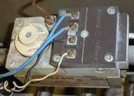

The reason I've come here is to get advice on replacing one or both of our 36-year-old Lennox G8 series natural gas furnaces which, amazingly, are still functioning well. (We also have a 36 year old John Wood natural gas water heater which, at least in part as a result of my replacing its anode every few years, is also still functioning well.)
First some background information.
We moved into our 1950-ft2, well-insulated, nearly-square bungalow (with 1950 ft2 mostly-finished basement) 14 years ago. Most significantly, in order to conserve natural gas (lower our bill) during a period of unprecedented high natural gas prices, 7 years ago we bought, and I personally installed, in our fairly large main-level TV room, a Rinnai 1004F, 38,400 BTU/hr, 80% AFUE, direct-vent natural gas heater. It vents to the outside environment via an amazingly small concentric intake/exhast. Neither the heater or its vent have ever caused us any trouble whatsoever.
I have never regretted purchasing the Rinnai. We set the theromstat on the Rinnai to heat our 9'-ceiling TV room to a very comfortable 76 F. There is an overhead paddle fan in the middle of the ceiling which circulates the air in the room to a uniform temperature. This sunken TV room has slightly above it our fairly large kitchen. The kitchen and TV room have no wall between them, so they are essentially one large room on two slightly different levels, so the Rinnai also keeps the kitchen nice and warm.
On the main level, off the kitchen, there is a dining room which leads to a pretty large living room, which has a large, floor-to-ceiling double-pane bay window that is probably ten feet wide. Also on the main level there is a master bedroom+en suite bath, a main bathroom and two spare bedrooms. Amazingly, even when the outside temp is -20 F, the Rinnai keeps these “peripheral” rooms at between 62 and 65 F while we sit bathed in 76 watching TV or eating in the kitchen. Of course the bedrooms and bathroom have their entry doors open at all times during the winter.
Normally, even during the coldest cold, the furnace for the main level never runs. Only when we have guests and we want the whole main level warm do we run the main-level furnace. For peace of mind, however, we keep that furnace's thermostat set at 60F just in case the Rinnai should fail which, again, it never has.
Again, 80% of our basement is finished with drywalled ceilings and walls and carpeted floors. The walls against the foundation have 3.5” fiberglass insulation. The furnace room has unfinished ceiling and about 13 feet of exposed concrete foundation wall. Two small storage rooms have about the same state of finish.

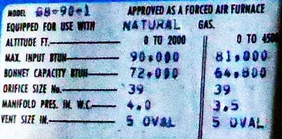

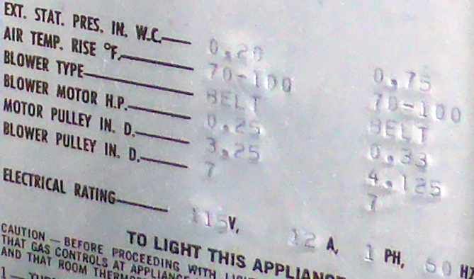

The basement furnace specifications are as follows:
The main level furnace specifications are as follows:

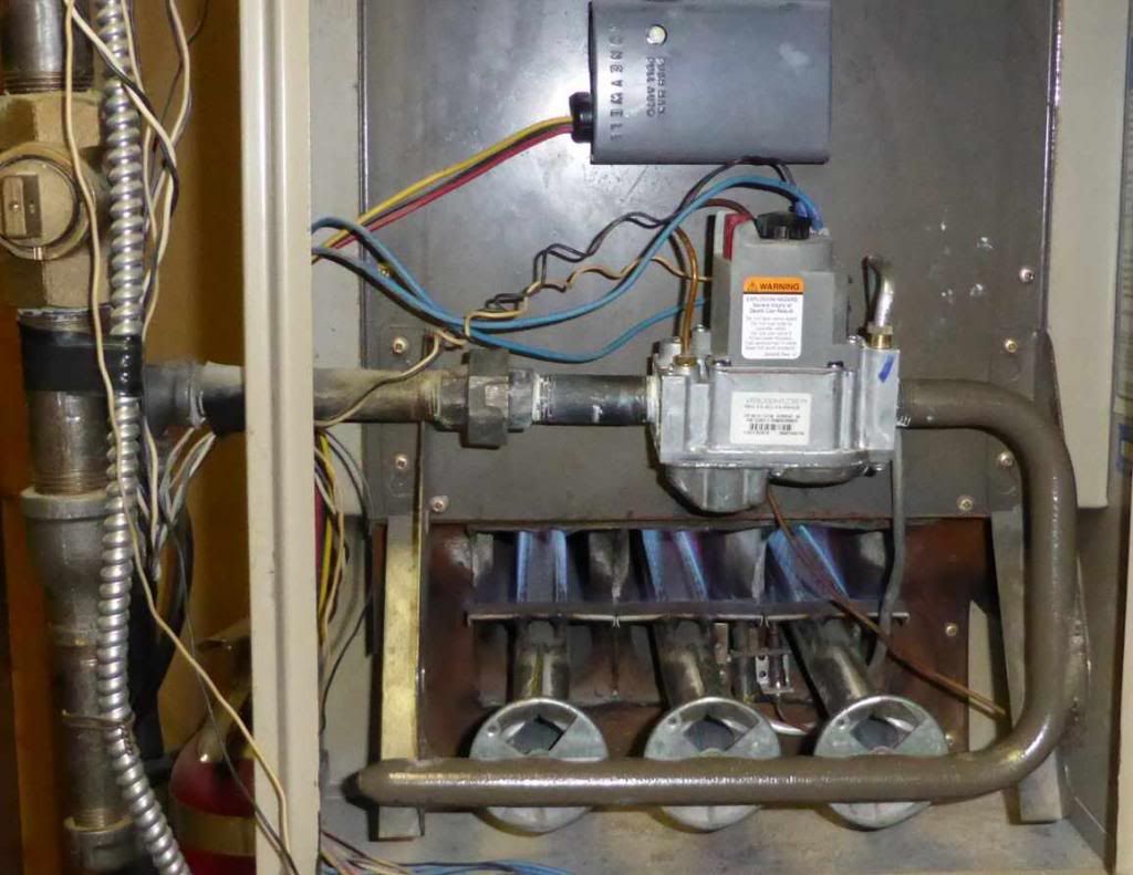

Finally to why I'm posting. At some point, almost certainly sooner rather than later, it will be necessary for us to replace one or both of our Lennox furnaces, as well as the John Wood water heater. I'm thinking that this coming summer would be a good time to do that.
I'm waffling back and forth between a do-it-all tankless hot water system with so-called hydronic air handler that would heat the house via the existing duct work, or going completely with “separates”, just as we have things now – two funaces and a hot water heater.
Part of my attraction to the do-it-all is one intake and one exhaust, but it “puts all our eggs on one basket”, if you will.

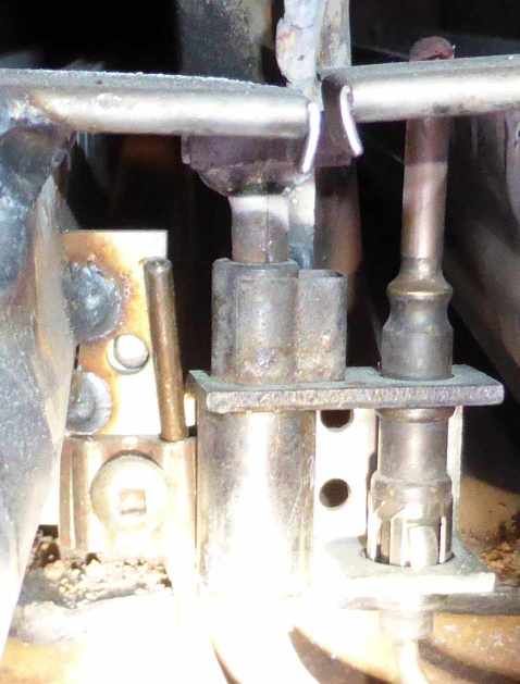

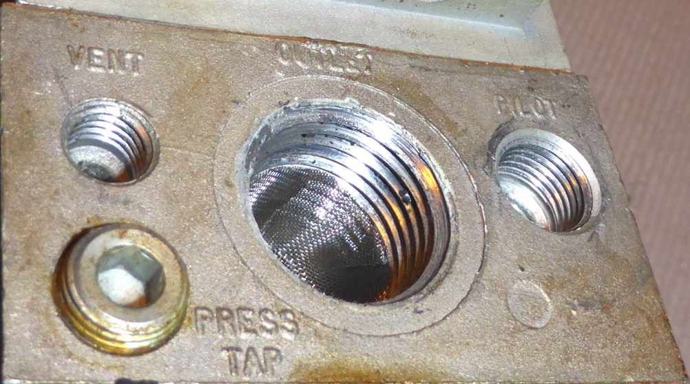

Over the years I've replaced the belts, cleaned the burners, pilots and thermocouples on our Lennox units, as well as done all the maintenance, including timing belt changes on our vehicles, so I'd like to do as absolutely much as I can in the installation and ongoing maintenance of whatever heating device(s) we choose. (Again, I installed the Rinnai heater, which required the installation of a new nat gas line to it. The inspector said I had done a good job on everything.)
I've studied the Goodman natural gas furnace installation manual and I figure that I could do much, if not all, of it myself, although I'd probably pay someone to create the transition between a new furnace and the existing plenum(s). I also think that I could do most of the installation of a tankless water heater with hydronic unit. Of course in either case I'd need building permits and, after installation, pre-operational inspections to determine that everything I've done is correct and up to code.
One thing I'd like some advice on is whether to go with two furnaces or one and, in the latter case, just have a zone damper between the main and basement systems. Considering our relatively low consumption of gas even durng the coldest months, I think replacing both furnaces with one should be given careful consideration, especially with the Rinnai still in service.
I believe that our present furnaces are both wildly oversized for our home. I think one or two far smaller units could heat our home very well, even without the Rinnai in service.

Not having any experience with the new Goodman equipment, I can't comment on that.
Personally, if possible/practical I would stick with 2 systems. I don't like dual zoned warm air systems at all. I've never seen one which worked well consistantly.
I would strongly suggest you download & run a manual J heat loss calculation. Here's one I have used & been happy with: HVAC Software, HVAC-Calc for Heat Loss, Heat Load Calculations
For the cost, it is probably the best money you'll spend on your project.

Well, a new turn of events.
As I was walking by the basement furnace I smelled a hint of gas. I removed the front upper panel and used my nose to determine that there is a very slight leak of gas around the stem of the slector knob. In short, I removed the valve and I'd like to replace it before our present above-freezing weather goes bye bye and old frigid man winter blasts in again.
Here is the General Control B57RBA601 gas valve that has served us well,
the outlet end view,
and the view of the vent line end, pilot and thermocouple, in that order:
I'm considering replacing the valve with a Honeywell VR8200H mentioned in the following pdf:
http://www.forwardthinking.honeywell...ll/68_0046.pdf
I'd appreciate hearing whether this is an appropriate valve. I'm a bit concerned that there is apparently no vent line on the Honeywell. What does that vent line do, anyway?
If you think there is a better replacement valve than the Honeywell, please tell me what it is.
BTW, I know that our furnace is old. I'm just trying to keep it chugging along until spring, when, as I said earlier in this thread, I will try to replace it myself with a new unit.
Thanks for any advice.

The 8200H would work well for you IF the end to end dimention is right & you have room to swing the valve while installing.

Anyway, the overall length of the new valve body is about 1/2" shorter than the old one. Because the iron gas line leading to the furnace sort of just flops in the breeze to a certain extent (when it's not connected to the furnace valve), I've tried giving it a bit of a nudge toward where the new valve will be and I think that a combination of this, perhaps sliding the furnace a fraction of an inch toward the gas line, and maybe not tightening the two sides of the valve to extra-tight will allow safe installation of the valve.
Specifically with regard to tightening things, with some thread dope applied, how loose can NPT threaded connections be and still be acceptably tight? I know there is a certain amount of leeway allowed, but I'm not sure exactly how much is too much.

Success!
To compensate for the shorter body on the new valve I bought a nipple that was 1/2" longer than the old one. Perfect fit and my nose tells me there is no gas leak anywhere with supply valve open.
In order to screw the valve onto the manifold line, I had to remove the manifold assembly from the furnace. No big deal and I had the opportunity to knock a bit of dirt out of the burners.
Getting the pilot line up on top rather than on the end the way it used to be was a bit of a PIA, but with a bit of creative routing I finally got the thing into the valve.
I then installed one thermostat wire and one blue wire on the TH/TR terminals on top, and the other thermostat wire on the TH terminal, and other blue wire on the TR terminal, on the side. Voila and ready to test.
The old thermocouple worked just fine right off the bat. I held the red button down for just a few seconds during and after lighting the pilot and the pilot continued to flow after lifting up on the red button. The selector then slipped right into the "on" position.
I can tell that the quality of construction of the new unit is inferior to the old one, but all the thing has to do is last until spring or summer and I'll be happy.
With tax included the valve cost us $130 and the nipple an additional 90 cents. Besides filters, I can't remember the last time we had to spend some money on Reliable #1. I think it was a belt maybe 8 years ago, so I'm not too concerned that this expenditure will be money down the drain when the unit is replaced. At that time maybe I'll remove the gas valve for somebody else to possibly use.

Looks like you did a good job. I do suggest picking up some leak "soap" & checking all the fittings, including the pilot tube. Even if the leak detector is listed as "non-corrosive" I suggest wiping the excess off with a wet rag then on the pipe threads , rinse well.

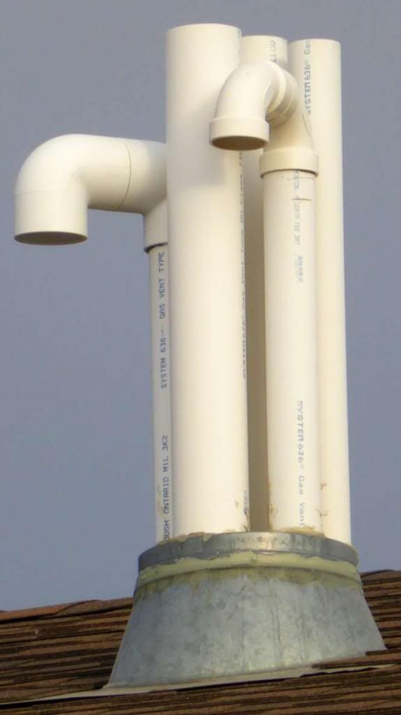

Before I made the first comment on this thread I called our neighbor to find out what furnace he had bought 3 years ago.
He said he had bought two HE furnaces (one for basement and one for first and second floors) and a HE water heater. I asked how the intake/venting was done and he said that the installers had "run everything up the old metal flue".
Today was my first opportunity since that conversation to have a good look at his roof and take what I think is a great photo of what comes out of his old flue.
I figure the distance from the neighbors basement up through the roof over the second floor must be close to 30 feet.
Because I think we have the same size flue, I'm thinking about doing the same thing, and on our bungalow with it's gently-sloping roof, installation should be a breeze compared to what the installers must have gone through with our neighbor's. I figure our pipes would be ten feet shorter.
Could someone take a stab at what is shown in that photo? Specifically, are the pipes with the elbows intake or exhaust? (I'm thinking they are intake because there are only two of them, versus three straight pipes which would be exhausts for the three appliances. The water heater must take its intake air from inside the house, but maybe I'm wrong on that.)
Anyone gone this route and, if so, how do you think it compares to the out-the-side-of-the-house routine? One potential shortcoming that I can see is if any of these lines were to get plugged, it's going to be a bear to get them open, especially when it's -40 C. But the installers are local and must be familiar with any potential shortcomings, I would hope.
Thanks.

I too believe the pipes with the U bends are intake, if not, they should be. It may be an optical illusion but it looks like the exhausts are larger than are the intakes. Usually that is a no-no.
I've used the old metal chimney on a mobile home. The furnace manufacturer has a kit specifically for the purpose. I've also used a masonary chimney as a chase. No problems with either application.

I've always been curious about just exactly how much our basement's Lennox G8-90-1 runs during cold weather, so yesterday afternoon I connected an old, small analog-movement, bedroom-table clock in parallel to the circulator fan motor.
I set the clock at 12:00 and put the furnace back into service. Sure enough, when the fan motor was energized, the clock's second hand started moving. When the motor stopped, so did the clock.
To make a short story shorter, over the next 16.5 hours the outside temperature fell from -2F to -16F and the latter held for the last 5 hours.
The basement thermostat was set at 63F, with the furnace coming on at about 62F and turning off at about 64F. The typical time it took the furnace to raise the temperature from 61 to 64 was about 9 minutes (0.15 hours).
During the entire period the furnace ran a total of 4.7 hours, so about 28% of the 16.5-hour time period. 28% of each hour would be just under 17 minutes of each hour.
Depending on the manifold gas pressure, the basement furnace is spec'd at 81,000 to 90,000 BTU/HR input and between 64,800 and 72,000 BTU/HR "bonnet capacity BTU/HR".
I really don't know what the real-world efficiency of the 36-year-old, natural-draft furnace is, so it is difficult for me to draw any firm conclusions from the above observations, but I think some reasonable guesses can be made.
First and foremost, whatever the real output of the furnace is, because it only runs 28% of the time in pretty cold weather when the thermostat is set at 63F, the furnace is wildly oversized for those conditions. (I'm now going to set the thermostat to 70F with the outside temp still at -8F and see how much the furnace runs.)
Second, assuming the actual efficiency of the furnace is say 70%, the output of the furnace would be between 45,360 and 50,400 BTU/HR and, again, because the furnace only operates about 28% of the time, this output is wildly oversized for the test conditions. 28% of output from a 50,400 BTU/HR furnace equals 14,112 BTU/HR from a furnace rated as such outputting for the entire hour (continuous operation).
Even IF the present furnace were 100% efficient, 28% of 90,000 BTU/HR would be 25,200 BTU/HR. That is, a 25,200 BTU/HR-output furnace would do the same running continuously.
Third, because our Rinnai (model 1004F, 38,400 BTU/hr, 80% AFUE, 360 CFM) direct-vent natural gas heater is able to maintain the temperature of the main level of our 1950-square-foot bungalow at 62F in the peripheral rooms and 76F in the TV room where it is located, I believe that the smallest two-stage furnace on the market will be more than adequate to keep our basement at between 63 and 70F in the coldest weather possible for our area. Even in that case, I very much doubt that a 2-stage furnace will ever get out of first-stage mode (except to raise temperature quickly to a new set-point).
BTW, while I'm at it, I've just been thinking about our neighbor's roof-top vent set-up as shown in the photo in a previous post. Does having all of those intakes and exhausts for three appliances so close together meet code (even in the US)?

Without having any reference material handy I'm obviously guessing on your neighbors venting system but my gut feeling is it would be legal. I recently did a dual furnace job & the venting spec on them was the vents had to be something on the order of they must be either within 12" of each other or separated by at least 3'. If this was a manufacturer's spec or from the National Fuel Gas Code, I don't know.

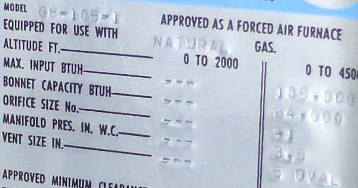

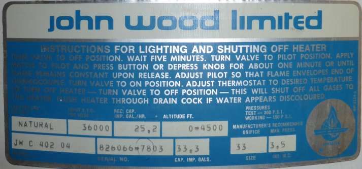

Here's a photo of the label on our hot water heater:
The previous owner told us the water heater was original to the house and the label indicates a date of manufacture of March, 1978, so he was probably right. As far as I can tell, the thing still operates perfectly.
The previous owner told us that the two furnaces were orginal to the house. I believed him. They're still operating and have required minimal, inexpensive maintenance.
