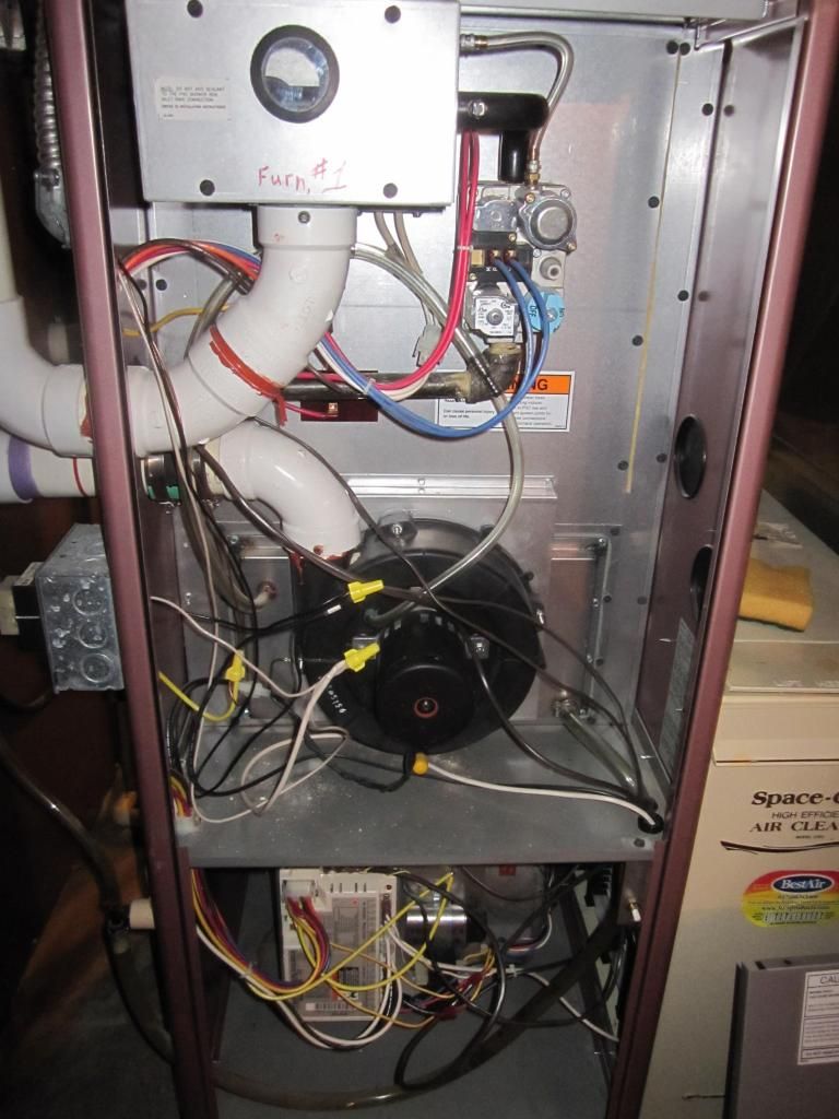

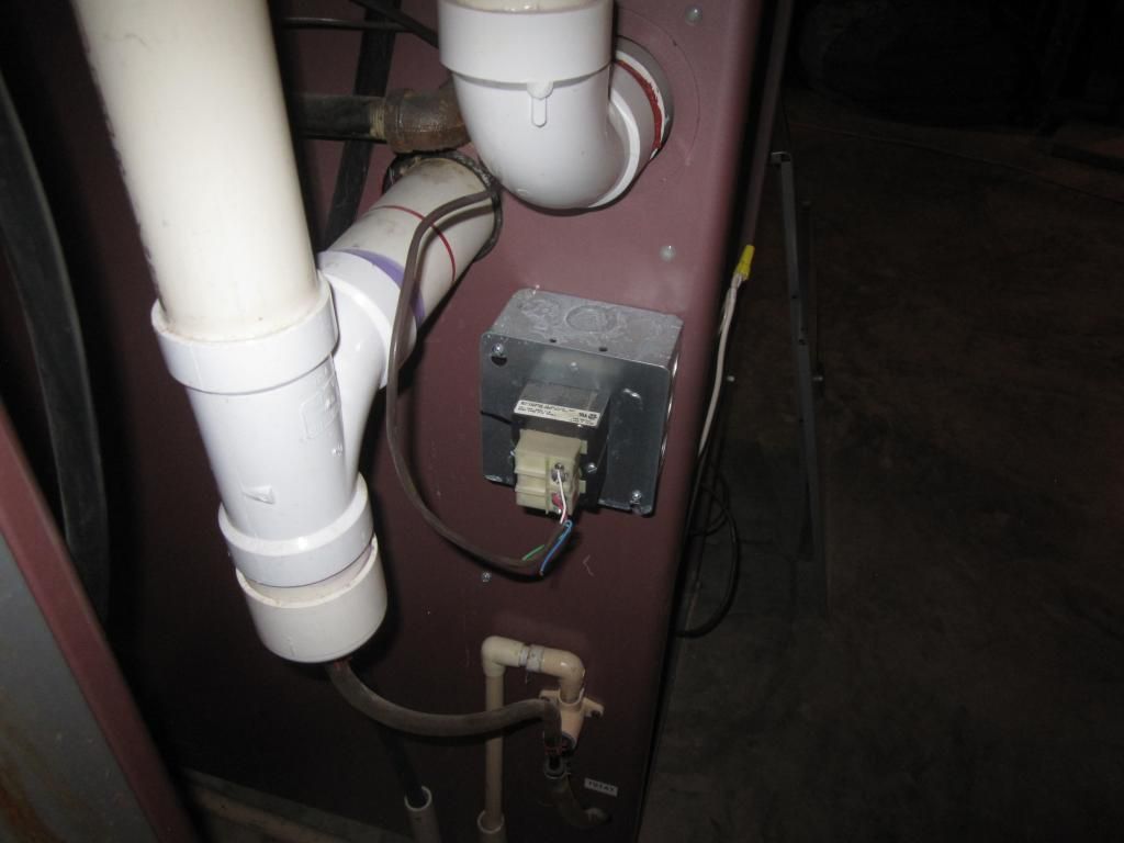

I purchased a foreclosed home (I live there now) with two identical furnaces and a/c units for each floor. The home, and I assume furnaces, are about 14 years old. They run on natural gas and are located in the basement. One is working great, the other is not functioning at all, and the Tstat isn't reading voltage/getting power (I connected an old Tstat (one that doesn't require batteries, and it didn't power up). At present, I am trying to turn the blower to 'on' and get that running.
Here is what I know:
1. This unit is in Wisconsin with wide ranging temperatures.
2. Furnace is a Thermo Pride CHB-50N.

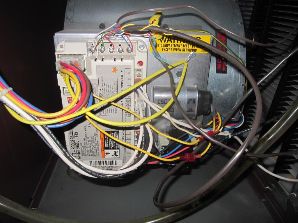

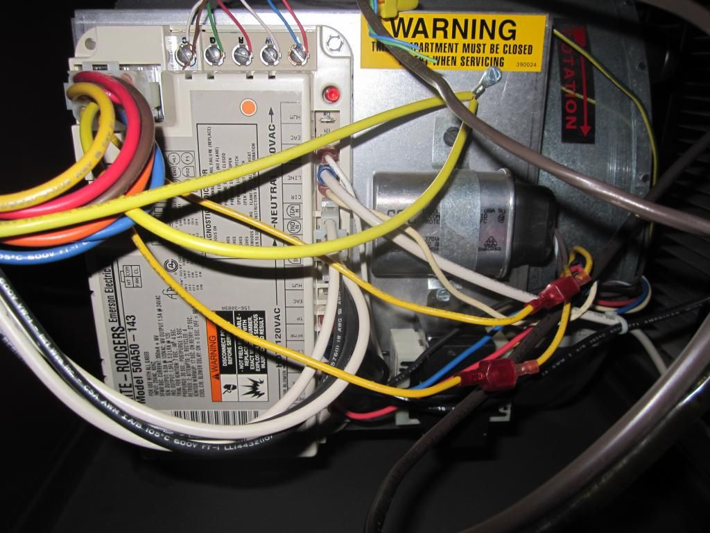

3. I have power at the control board (White-Rodgers 50A50-13) so when I push the door safety button the light goes on for a second or two and then remains off indicating no issues with the board.
4. I have checked the voltage on the control board at R and C and the read is 26 volts.
5. I have checked the voltage on the out-side of the transformer that sits next to the control board inside the furnace and the out read is 26 volts.
6. I have checked the voltage on a second transformer (does this make sense?) that is attached outside the furnace on its side and the out read is 26 volts.
6. I have checked the voltage at the Tstat at R and C and it registers between 1 and 2 volts. Tstat doesn't seem to be getting what it needs.
7. My furnace does not have a fuse on any line-in power wires that I have been able to locate. I have checked and checked a few more times out of frustration in trying to resolve this problem. This was based on many forum reads.
8. My furnace does not have any drain check-valves that I have been able to find that would cause the system to stop. This was based on many forum reads. The system has not run, to my to knowledge, for at least a few months.

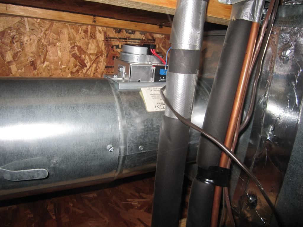

9. The furnaces have multiple add-ons: durozone multiline dampers/zone systems, a durozone comfort control system, Aprilaire humidifier, etc.
Any thoughts would be greatly appreciated. I have read many forum notes without success over the last few days and my head is spinning. Thank you in advance for your help!

Welcome to the forums.
You've confirmed the voltage between R and C at the control board and it's 26vac. That means it's not going to be a transformer or fuse problem.
If you have the voltage at the board but not at the thermostat then it means the wiring is defective, spliced somewhere or cut. You'll have to trace the wire and look for problems.
In the pic of your board below...... try a jumper between R and G and see if the blower starts.
If the blower works then it sounds like a Durozone issue which will require some equipment part numbers. Usually the thermostat connects to the durozone board and then that board connects to the White Rodgers board.

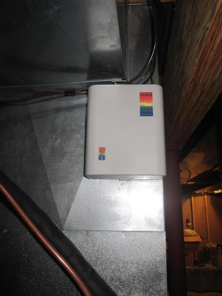

Your thermostat is going to be connected to your Durozone control board.
Do you see any fuses on that board?
Photo and image hosting, free photo galleries, photo editing
A picture of your zone control board would be great but the model number of it might be enough for us to offer more assistance.

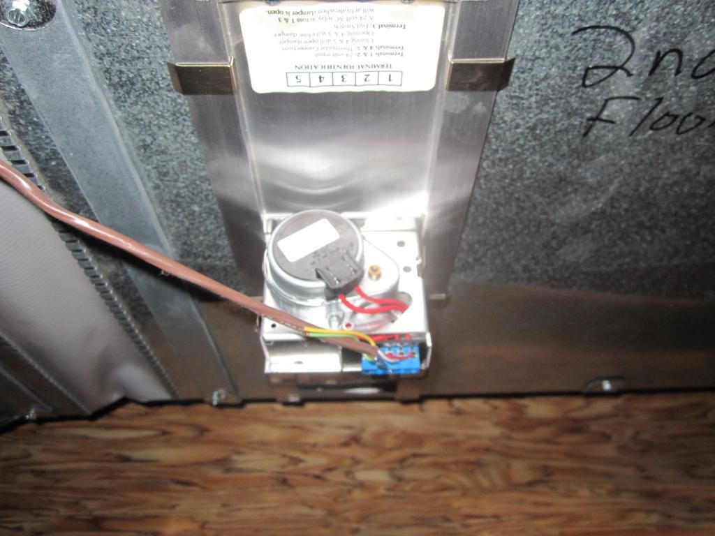

That Autotrol device sounds like a duct damper operator.

Zone control boards are usually near the furnace and have a dozen multi conductor wires connected to them.
The stats, dampers, furnace, a transformer and a duct sensor.

Durozone Control System and Functioning Blower Using Bridge
I should have noticed the sixth picture was a DuroZone cover. Underneath is a Model SMZ-SW Zone Control System. I don't see any fuses. I am adding a picture below. Anything I can check on this?
I bridged R and G on the furnace control board and the blower started.

DuroZone System Updates
The R and C on the DuroZone Control system that leads to the furnace (top left on diagram) read 27 volts. I included a picture of the wiring diagram below. The R and W for Zone 1 read 27 volts. The R and W for Zone 2 read 2 volts.

Looks like your zone control board requires a single stage heat pump with separate O and B terminals that runs on batteries.
Where is the stat C wire connected at your zone control board?
I only see 1 wire at furnace C and the 1 and 2 terminals.
If I were to guess I'd say the equipment terminals power the stats so stat C connects to the furnace C terminal along with the wire that is already there. You can disconnect furnace R then measure R to W at the stat to prove this.
What stat do you have connected to zone 1?

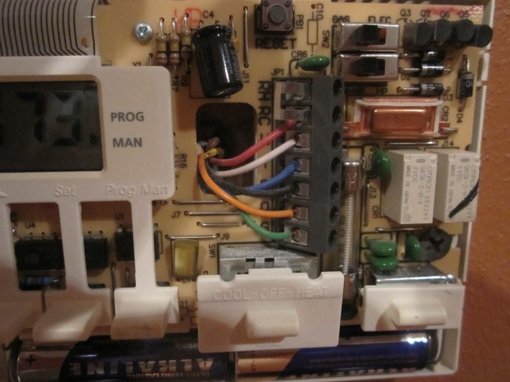

Yep, your zone 1 stat must have separate O and B terminals.
Post a picture of the connections at the stat.
What is the make and model of your stat?

That is a funny color code that your installer is using.
I would have wired the stat...
R = red
B = blue
O = orange
W = white
Y = yellow
G = green
C = brown (and connect stat C to the Equip C)
But...
At this point it would be easier for you just to connect the yellow wire to C at the stat and connect the other end to Equip C along with the brown wire that is there now and keep the odd color code.

The stats are both Robertshaw 9600.
First floor stat, which is working, is wired:
Second floor stat, which is not working, is wired (second floor stat has blue wire instead of yellow at the Y):
Can you confirm your advice regarding the yellow wire? Connect on the panel board to C and also on the DuroZone board to C under the Equip terminal strip?

No, I cannot confirm anything now.
It should not be able to work as you have shown.
The thermostat Y terminal controls the cooling compressor.
You have a yellow wire connected to Y at your zone 1 stat.
The yellow wire is not connected to anything at the zone control board.
How is it able to cool?
It is like finding out that Chuckie doesn't have his batteries after he has been speaking in that old movie.
Do you have a control board between the stat and the displayed zone control?
Do you have a third thermostat in your house that controls a second outdoor unit?
The zone control requires a separate O and B terminal and you have neither terminal on that stat.

I am very sorry Houston204. You are correct. I think Chuckie has batteries after all but I am no expert. There is a third stat in the basement that was blocked by items from the move. I am adding its picture below. Same make/model thermostat. Here's what I know now. This all started when I wanted the a/c turned on for my top floor (it was 90 degrees here a couple of days ago). The top floor stat did not respond and I found the second a/c unit not working. I now have that a/c unit working by turning the basement unit to cool AND moving the 'set temperature' setting below the actual temperature in the basement. I confirmed just setting the basement stat on cool and having the top floor stat on cool with a ''set temp' below the actual temp did NOT turn the blower or a/c unit on. That seems silly and I am wondering if something is wired incorrectly? At this point, I don't understand the zones in my house (I will read up on this) or how to get the top unit working without the basement unit receiving warm or cold air at the same time. It does appear, however, that all systems are able to function by using the basement unit. But it would certainly be nice to only use the top floor stat. It seems that it doesn't have an effect on anything. Sorry to have come around in such a wide manner. I am glad I found someone who knows their ****, ah, I mean stuff

#22
Your zone 1 stat is a different model than the zone 2 since it has an O and a B terminal as required.
The batteries should be changed annually.
That zone control only supports 2 thermostats.
You can flip the power switch to the furnace off to prove which 2 stats connect to that furnace.
I'd say that the stat with yellow at Y is not going to the zone control.

Thank you, Houston204. The basement (zone 1) stat is a 9610 (looked the same from the outside and should have paid more attention). The other two stats in the house are 9600.
So, top floor (blue at Y) stat 9600 is zone 2 of the zone control. And you are correct, the main floor stat 9600 (yellow at Y) is not going to the zone control.
Can you recommend a link to read regarding how the two two-zone stats communicate? I still cannot get the zone two stat to function on its own. It only seems that the zone 1 stat is working. I have air flow in zone 2 when the zone 1 stat is turned on and the zone 2 stat is off. I am not sure if that's normal.
I feel much better about the status of the system at this point in general though, so thank you again for your help. All the best!

Houston204:
I guess with all of the developments I forgot the original post and question: I do not have 24 vac at the zone 2 thermostat. Shouldn't there be power there, and if so, how do I fix it based on my setup? Thank you!
#25
Your thermostats do not have C.
What are you measuring R to?
When you give zone 2 a cooling demand do you get 24 volts between zone 2 Y and furnace C at the board?
#26
Join Date: Jul 2014
Posts: 12
Received 0 Upvotes
I was measuring R to W, R to Y and R to G. They all read about 2 vac. If I measured one of the three and closed the loop by asking the stat to engage that process, the read would drop to 0 as expected. The thermostat on its own zone reads 26 vac for all R to W, R to Y, R to G, so I expected the same on the zone 2 stat.
I will need to measure zone 2 Y and furnace C once I get the multimeter back. Unfortunately I had to give that back to its owner. Have a great weekend!

You can also verify that the dampers get the signal to open when a demand is present.
SMZ-SW SYSTEM CHECK-OUT PROCEDURE
The following check-out procedure requires a voltmeter set to read 24 volts A.C.. If, after the check-out procedure is completed,
the SMZ-SW panel and dampers are operating correctly, but the system is not functioning properly, check your wiring carefully.
The most common problems experienced are a misplaced wire, a bad connection or a broken wire. If none of these seems to be
the problem, check your thermostats and equipment. YOU MUST PERFORM THE FOLLOWING TEST PROCEDURES
IN THE ORDER SHOWN. DO NOT SKIP ANY OF THESE STEPS. Place all damper switches in “O”
open position .
1. You must have 24 volts across R & C of the SMZ-SW Panel Equipment Terminal Strip. (This powers the SMZ-SW panel
and your equipment).
2. You must have 24 volts across 1 & 2 of the SMZ-SW Panel Equipment Terminal Strip and every 1 & 2 of each SMZ-SW
Panel Zone terminal. (This powers the dampers).
3. To test the operation of the SMZ-SW panel, you must disconnect all thermostats. With the thermostats disconnected and
24 volts as described in #2 above, all dampers should be open. (If the dampers are not open, go to step 4).
3A. To test the heat mode, connect R & B at the SMZ-SW Panel Zone 1 Terminal Strip. (This sets the panel to heat). Zone 1 will
be activated when you jump R & W at the SMZ-SW Zone 1 Panel Terminal Strip. (All zone dampers, except Zone 1 will close
and the furnace will turn on). Zone 2 or Zone 3 can be activated by jumping W & R at the corresponding SMZ-SW Zone 2 or
Zone 3 Terminal Strips. If the furnace does not activate, with R & B connected and R & W, (or W & R of Zone 2 or Zone 3)
jumped, test for 24 volts across C & W at the SMZ-SW Panel Equipment Terminal Strip. If voltage reading is 24 volts, panel is
okay.
3B. To test the cool mode, disconnect the R & B connection made for the heat mode check. Connect R & O at the SMZ-SW
Panel Zone 1 Terminal Strip. (This sets the panel to cool and the indicator light on the equipment relay will come on).
Zone 1 will be activated when you jump R & Y at the SMZ-SW Panel Zone 1 Terminal Strip. (All zone dampers except
zone 1 will close, and the air conditioning will come on). Zones 2 or 3 can be activated by jumping R & Y at the SMZ-SW
Zone 2 or Zone 3 Terminal Strips. If the air conditioning does not activate with R & O connected and R & Y, (or R & Y
of Zone 2 or Zone 3) jumped, test for 24 volts across C & Y at the SMZ-SW Panel Equipment Terminal Strip. If voltage
reading is 24 volts, panel is okay.
3C. To test the Fan, jump R & G at the SMZ-SW Panel Zone 1 Terminal Strip. Be sure at least one Damper Switch is in “open”
“(O)” position. The fan should activate. If the fan does not activate, with R & G jumped, test for 24 volts across C & G
at the SMZ-SW Panel Equipment Terminal Strip. If voltage reading is 24, panel is okay.
4. To test the damper operation, perform step #3A, checking for 24 volts across 1 & 4 of every SMZ-SW Panel Zone Terminal
Strip when that zone is activated, and for “0” volts at 1 & 4 of every SMZ-SW Panel Zone Terminal Strip that is not
activated. (IMPORTANT: This test will work only if at least one zone is activated. If no zone is activated, all terminal 1 &
4 readings will be 24 volts). If all readings are correct, the panel is operating correctly. If a damper is not functioning but
the SMZ-SW Panel has checked out okay, check for 24 volts across terminals 1 & 2 on the damper motor. If you have 24
volts, disconnect the terminal 4 connection to the damper. Jumping terminals 4 & 5 and the damper should open. (It will
take 30 to 60 seconds for a damper to fully open). When you disconnect the jumper from terminals 4 & 5 the damper
should close. If the damper tested does not operate as described, the problem could either be binding damper linkage,
the blade movement is being obstructed, or you could have either an incorrect or a defective motor. (With multiblade
dampers, it is possible to connect the motor to the linkage 180º “out of phase”, which causes the damper to be open
when it should be closed and closed when it should be open). If this is the case, remove the motor and rotate the linkage
180º and then re-install the motor (this applies to Power Open/Close Dampers only-not the Spring Return Dampers).
