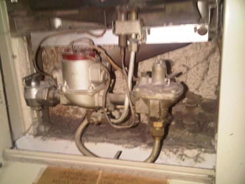

Hello,
This is probably something really simple but I can't figure it out.. All I'm trying to do is turn off the pilot light inside our new apartments wall heater. I have the thermostat turned all the way down but I still feel heat coming from the heater so I just want to turn it off. I tried searching all over the internet and watched some Youtube videos but every website I go to has a different wall heater and valve than mine..
The wall heater in our apartment is a Holly and from what I can see there is only one valve to turn.. it's labeled "MAJOR CONTROLS" and it only rotates 90 degrees from a ON position to a OFF position. Of course I tried rotating it to OFF but nothing happens. The pilot stays lit and I've left it in the OFF position for about 5 minutes and nothing changes.. I can still hear the gas even though I turned it to OFF. Is there another valve or something I need to close outside of the apartment? Here are some pictures I took. (I apologize for the links, I tried inserting image but it told me the pictures are too big)

Please let me know how to turn this thing off as it is heating up our living room every day! Thanks in advance!

Hi Drew, yea there should be a valve on the pipe that is leaving the regulator . It could be outside the furnace cabinet. The valve you are closing is on the outlet side of the gas valve. IMO that valve should be on the inlet of the gas valve.
I took a closer look at the pics, in the second pic I see a shut off valve just to the right of the regulator.

YES! Thank you so much everyone for the help! Mbk3 you were right! I followed the tubing and it was a very small valve behind it, it only turned 90 degrees but that did the trick! The flame finally went out.
Should I also turn the "MAIN CONTROLS" valve to the "OFF" position or does that even matter? Thanks again so much everyone for the help I really appreciate it!

Major control not main control as that's no main valve.
There should actually be a shut off valve just before that unit for servicing. I've never seen a valve inside a heater on the OUTLET side of a gas valve.
If you aren't going to use the heater it couldn't hurt to turn that valve off.
Please review the picture again, the regulator is before the gas valve and the aluminum supply tubing goes to the main shut-off or line valve. Look at the B-60 valve and you will notice the pilot tubing is on the inlet side of the valve and the the piping from the outlet side of the B-60 goes to the burner orifice.
