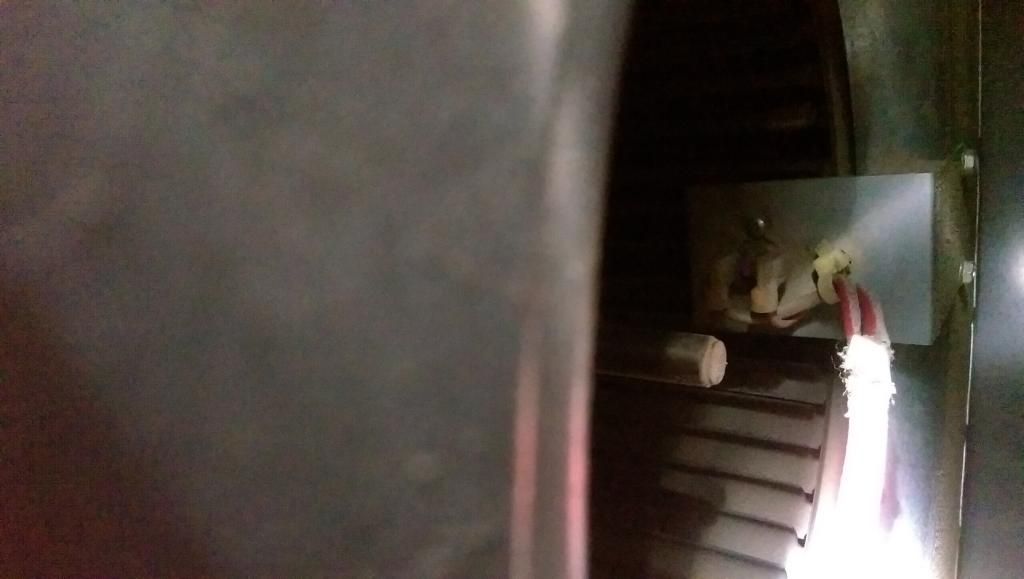

This is a pic of the wires and as far in as I could reach.

On some furnaces, when the blower continues to run it is because a limit is open. The auxiliary limit switch may very well be the culprit. Some Diamond 80 furnaces have two auxiliary limits.
In the photo you posted, is that not the reset button I circled in white and the leads on either side?

Well darn after looking at the pic, the switch is right there lol. Didn't even notice that. I'mtthinking with a mirror, a flashlight, and a coat hanger I might be able to trip it. Alls I know is thank God for space heaters. Thanks for all your help so far

This stupid pipe is not helping my issues Lol. Arm is too big to go in from the right and if only I had two elbows the left side would be fine.

Ok I was able to get to the switch andrreset it as far as I know. I pushed the center inaand out a few times. It is still kicking off. On a cold start it will run longer than after it faults out and I reset it. Wonder if there is another limit switch that I am missing or something. I am so ungodly boggled right now. I can't mess with it for hours each day just to get it to reach my desired temp. Thinking I should just replace the damn thing.

A limit switch opens because of an over temperature condition. I suggest you check the vent pipe at the exit point to ensure there is nothing blocking it such as a bird's nest or other obstruction. As stated earlier, a dirty/clogged evaporator coil will restrict the air flow and cause an overheat condition.

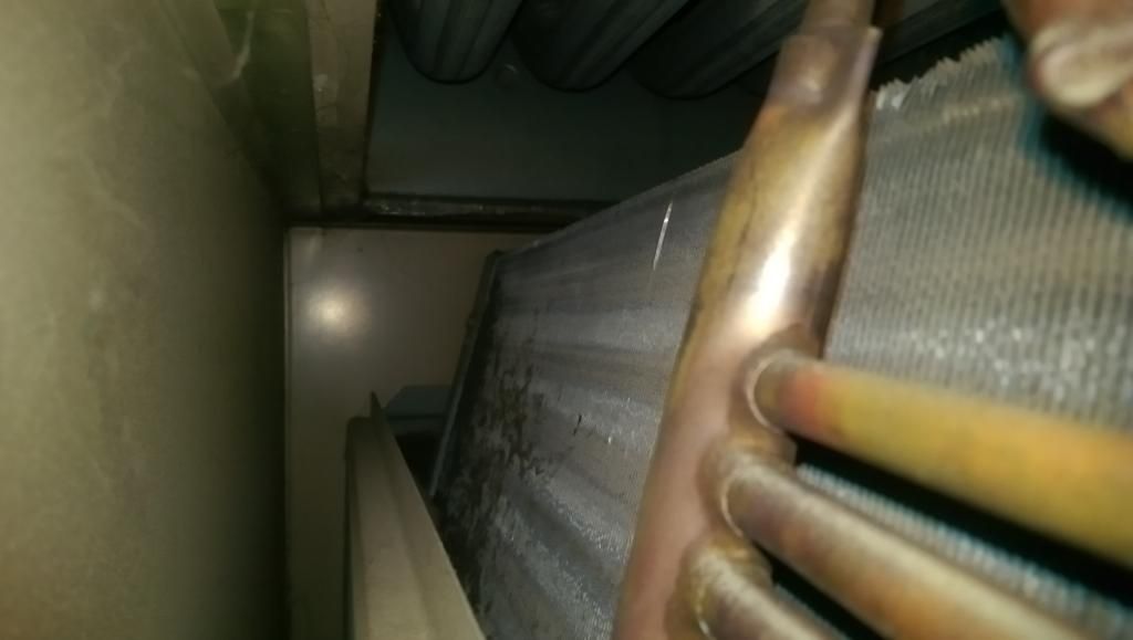

The a coil was somewhat dirty but not horrible. And I don't believe it's the exhaust vent because I unhooked it at the top of the furnace and ran it for a short time and still kicked off. I hooked the vent back up as I know that is not safe to breath it but I didn't have a ladder at the time to reach the roof so that was my only other option. Is there a proper way to clean the a coil? I took the leaf blower to it on high but dunno that it removed much of anything. Once again thanks for all your time and knowledge!

If up flow, buy a can of coil cleaner, I believe Home Depot sold it at one point. Take the cover off the front of the coil, then there will be a metal piece in the middle of the "A" in the coil. There should be a few screws holding that metal piece in place. Once you remove it you will be able to see the bottom of the coil. If it's dirty use that foam coil cleaner and a wire brush or tooth brush and go with the fins. That should do the trick if that's the problem. I'm not trying to be a dick but you have put a lot of time and money into this. I guess at least you got some experience and knowledge for next time at minimum.

It is a down flow with just one large cold air return at the top. I appreciate the helpI ddidn't think you were bring a dick. And I'm not trying to be either. I don't know what else I can try but I feel if I call in a pro it will be just to replace the unit. We have had issues with it every year since we have lived here. Just not as bad as this time. But I can't see spending the money for him to do all the stuff I have spent the last few days doing. Guess I could just have it checked and see what they think and an estimate to fix it. I'd I do need it replaced hopefully I can have it moved to the attached garage. We have a manufactured modular home and the furnace is located in a small closet in the hallway right next to the living room so when heat or air is running it's fairly loud. And having the large return duct right above the door doesn't help with the noise.

Here is a picture of the coil. It's not a great view but it don't seemed to be clogged. Definitely some dirt but I get strong air from the vents so I wouldn't think that would be causing the shut downs. Was trying to see if the leaf blower would remove the surface debris
