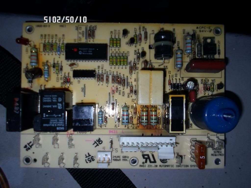

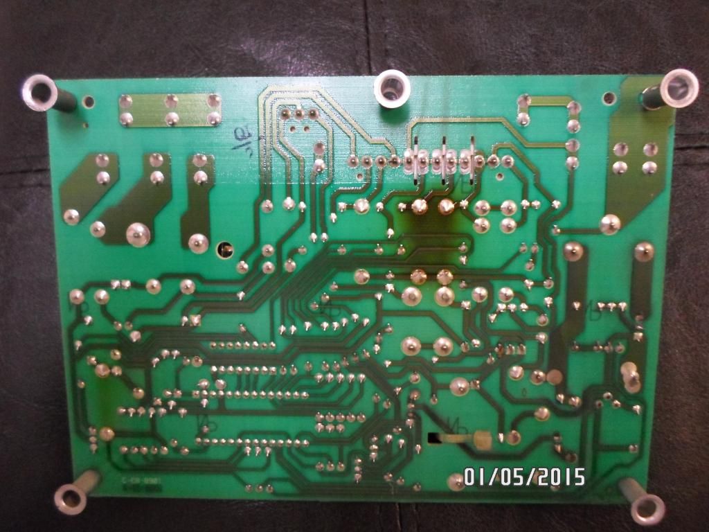

I've learned lots after this issue, but now I'm back to the same issue again... system giving me code 6 (inducer switch fault), did a few reset and sometime works and sometime doesn't.. I unplug the inducer connector and the fan would just run but no ignition, this way at least i know the switch is function as it should.
But once it work it would run to the setting temp, it would turn off as it should BUT would not turn back on when temp is below the setting, many refer this as a lock out and not really sure where to go from here.
Did a search and found this thread:
http://www.doityourself.com/forum/ga...w-hours.html#b
Listed the same issue that i have, so I just order a replacement board and hope that will fix this issue.
Also saw some discoloring on the on the board around the capacitors area.
Will update once i replace the board and see if this will fix it.
