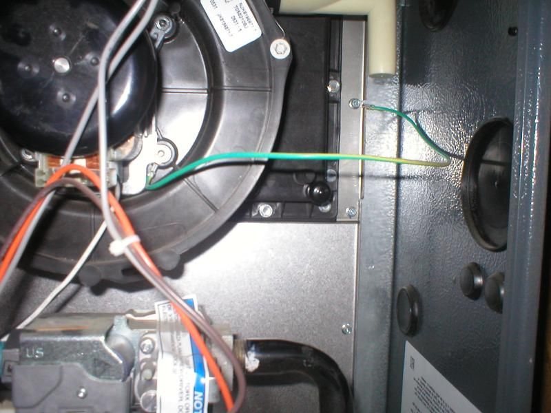

Back with pics. Bear with me as I try to figure out what to do here..
There is no trap set-up, in fact, I don't believe the drainage system is set up at all like it's supposed to be. As you can see in the pictures they have the drain running off the middle of the inducer housing. From the results I'm getting, that configuration is useless. Someone didn't know what they were doing on this.
According to the diagram in the manual, if I’m looking at the right one, it looks like I need to run lines off the elbow and the lower right corner of the back of the inducer housing. Is that right? The side with the elbow is exhaust from the furnace to the outside of the house. The tube running off the elbow needs to be drilled out or cut off to open it because it is dead ended. That is described in the manual linked above.
Do I need to buy the Goodman trap set up or can I rig up something from the local home improvement store?
Here is a close up of where the drain hose is connected:
Here is an overall view:
You are correct. The condensate drain is totally wrong and totally useless. It sounds like you have figured out what needs to be done to correct the situation. The drain trap is shown in the attachment. Here is a link to the parts manual:
http://www.goodmanmfg.com/Portals/0/...s/RP-GCH95.pdf
You might look around the furnace area and see if the installer left a plastic bag with the parts you may need to complete the job.

I've seen the pictures of that trap in my research and of course it's shown in the manual you linked earlier but I can't clearly see how it fits together with the tubing they show in the pictures or diagrams. I'm wondering if I can make it work with just some clear tubing.
Thanks, again.
Some of the black tubes you see already connected (incorrectly) were in the drain kit bag provided for the installation. Two of the tubes come out the side of the cabinet and go into the drain trap which is mounted on the side of exterior cabinet. The trap is secured with a couple of sheet metal screws. Yes, you can use clear hose for the condensate drain. You can take the existing "drain" apart and see if you can reuse the various parts. As shown in the parts diagram the black pipes coming out of the side of the cabinet and going into the trap have a 90 degree bend on one end. The trap needs to have water in it at all times or a vacuum will be created. So, once the trap is installed the trap needs to have some water poured into it to prime it.
Hopefully, the attached photo will help you see how it drains out the hole in front of the trap. Once the condensate level gets up to the inside lip of the drain hole it will enter the drain hose. A drain hose from the condensate pump will be attached there with a clamp.
