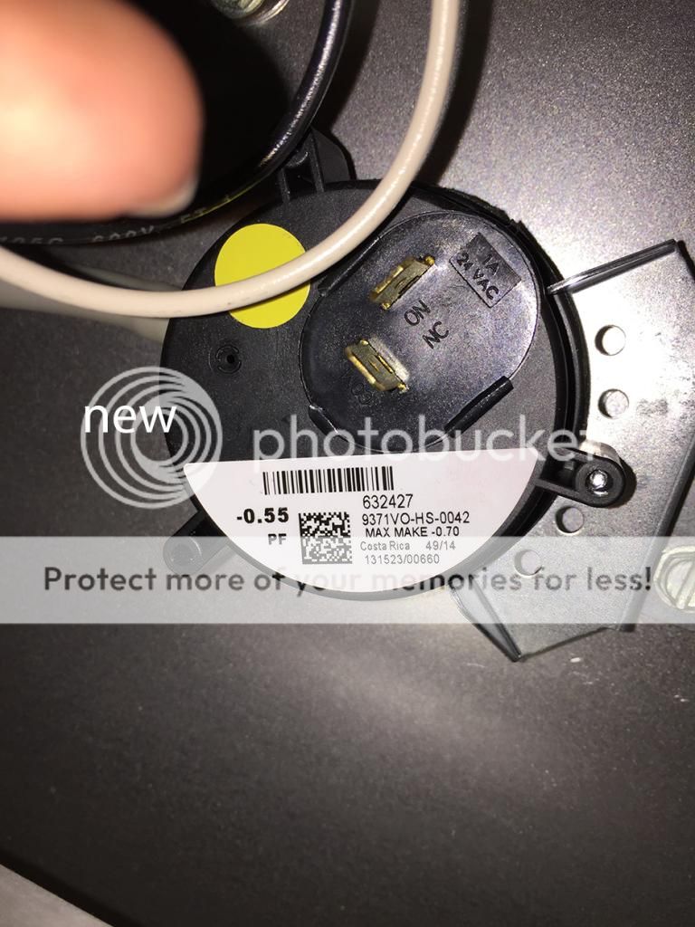

Old 02-13-15, 06:06 PM
Join Date: Jan 2015
Posts: 137
The heater was working fine for 3 days then was having the same problem again. I replaced the pressure switch with a new one and the heater is still not working.
Same red light is blinking 3 times = Pressure Switch Closed.
What else should I check? Thanks for any help guys!

Many pressure switches have 3 terminals...
Com
N.O.
N.C.
Verify that you are connecting to common (Com) and normally open (N.O).
  #26
Old 02-14-15, 04:00 PM
Join Date: Jan 2015
Posts: 137
pretty sure my connecting is right. theres only 2 wires coming off the switch.
  #27
Old 02-14-15, 07:34 PM
Houston204's Avatar
Join Date: Oct 2009
Location: Texas
Posts: 7,370
Received 10 Votes on 8 Posts
N.O and N.C are often right next to each other and easy to confuse.
The 2 wires should connect to Com and N.O.
It would be good news if you could correct this problem by moving a wire.
Does the new switch display a negative pressure number on it?
Did the old switch also display a pressure on it?
  #28
Old 02-14-15, 09:29 PM
Join Date: Jan 2015
Posts: 137
The new switch have the word "Com".
should i switch the 2 wires around? It won't damaged anything?
  #29
Old 02-14-15, 11:55 PM
Houston204's Avatar
Join Date: Oct 2009
Location: Texas
Posts: 7,370
The pictures that I see on Amazon show only 2 terminals an -1.74" wc.
Is that what your new switch displays?
Id that what the old switch displayed as well?
Or did you remove something more like a a -.5" and go back with a 1.74"?

NEW Switch
OLD Switch...
[/URL]

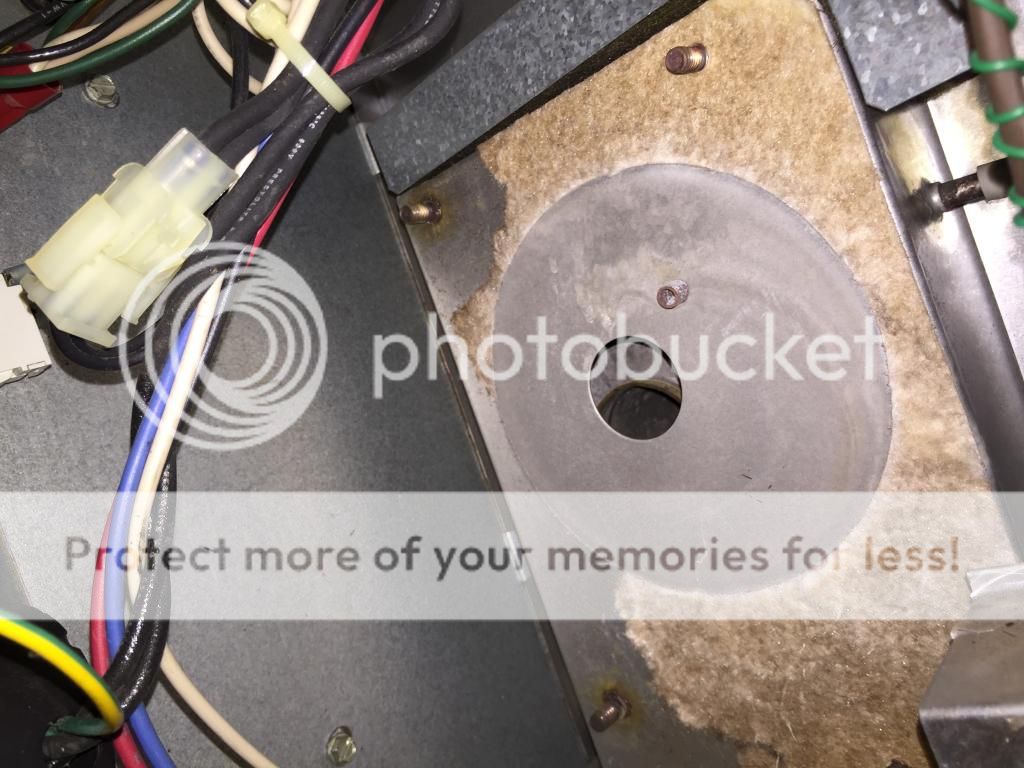

It almost seems as if debris is acting as a check valve somewhere.
If this restriction was in the vent pipe the vacuum would be broken by the heat exchanger side since this is an 80% furnace with metal vent pipe.
It seems like the debris must be in the inducer.
While I would really like to see a manometer tee'd into the pressure switch tubing, we could remove the vent pipe connection to the inducer and shop vac the induced draft assembly that houses the squirrel cage.

Does unplugging the hose to your new switch change the trouble code as it did before?
I suspect rust is in the inducer and it is acting as a check valve.
I would tape a piece of 3/4" hose to the end of a shop vac to clean it. The squirrel cage is fragile.

took the Inducer motor assembly out and vac the whole thing.
Still having the same issues.
let me know if you see something?

That is part of a broken float switch.
I didn't mean to disassemble the inducer, just take the pipe off and vacuum with a hose on the end of a shop vac.
It looks like you were able to accomplish this without damaging the gasket material.
I will have to go back and reread the 37 posts to find out if the pressure switch has been tested with a volt meter.
If we get 0 volts across the 2 pressure switch terminals with a heating demand but we measure 24 volts from one side to common, it is not the board.
