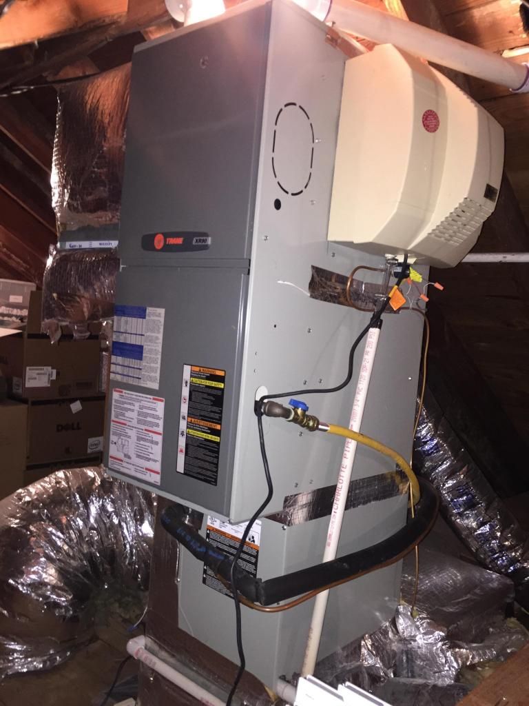

Hello -
First post here. Forgive me, I know next to nothing about HVAC. Trying to learn though.
I just bought a house. The furnace in the attic is a Trane model XR90. There is an Aprilaire 760 humidifier installed on the side. It has been incredibly dry in the house, so I checked it out and realized the saddle valve off the hot water line that runs up to the humidifier was turned off. I checked out the humidifier, read all about it, did the yearly maintenance that's recommended (replaced water panel, feed tube, etc.). The humidifier is getting water, the solenoid valve is working, water trickles out the drain tube during operation, and it actually humidifies the house. That's all great. But, every time the furnace (and therefore the humidifier) turns off, the humidifier leaks a bunch of water out of the base. I cannot figure out why it's doing this.
I think there may be a fundamental flaw in how it was installed. When I take the cover and water panel off the humidifier, so that I can see inside the furnace, I see... what I think is a draft inducer blower??? Um, I don't think that's normal, for a humidifier to be installed right against (what I think is) a draft inducer blower?
I still don't understand why that would make the humidifier leak, only when it turns off. But this installation seems strange. Is it? If so, could it explain the leaking at the end of each cycle?
Thanks in advance for any help anyone can provide. I have to get this humidifier to stop leaking so I can use it. Everything I touch in the house gives me a static shock. Ugh.
-dave

Welcome to the forums.
I hope that's a heated attic.
Can you post a picture of what you have there ? http://www.doityourself.com/forum/el...rt-images.html

Sure thing...
Front:

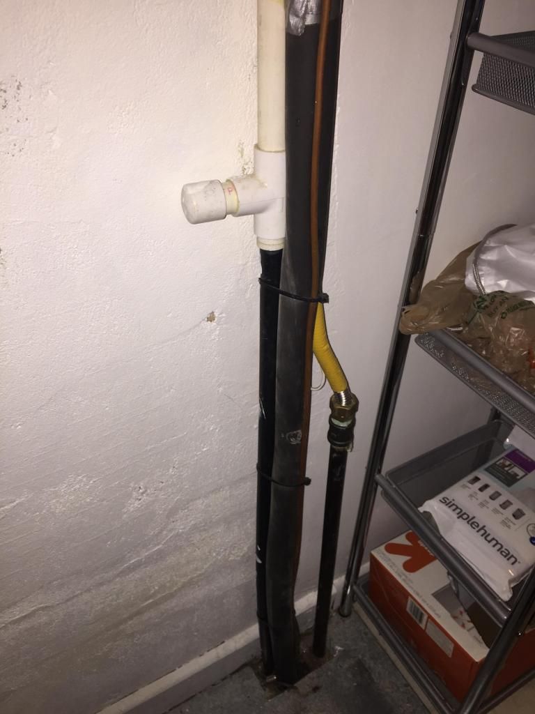

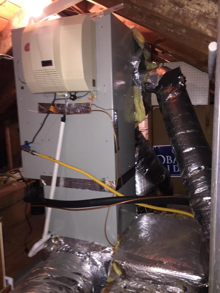

Front right:
Back right:

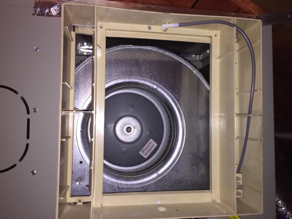

Looking through humidifier with cover and water panel removed:

Since you have water there you definitely don't want anything to freeze.
That is the main blower there. You have a downflow furnace. Your A/C coil is at the bottom.
Probably not the best location for it. What I can't figure out is why you get water when the blower stops running. I'd think you'd get water with the blower running unless the blower is creating a vacuum thru the humidifier and holding water inside the unit.
Thinking here about a trap for the drain.
Try this..... take a plastic bottle or bucket. Put a little water in it and drop the drain line for the humidifier into it so that the drain line is under water. Keeping the drain line submersed see if you have the same overflow problem.
I'm thinking the blower is drawing air thru the drain tube and preventing it from draining correctly.

Thanks for your help. Here is a video (sorry about the quality) showing it start to leak the moment the system shuts off (at 0:11 in the video). http://youtu.be/eXMJ_EmeXoM
The blower is *definitely* creating a strong vacuum. If I open the humidifier cover while the system is running, I can barely pull out the water panel because it is getting sucked back in toward the unit so strongly).
Is this just a completely stupid place for the humidifier to be mounted? I'm not sure there's anywhere else to mount it.
I'm wondering, if I just sealed the bottom of the humidifier housing with foil tape or something, maybe that will direct that momentary rush of water (that happens every time the system shuts off) down the drain spud, and this won't be a problem?

Wow, I think/hope that actually worked. Thank you! I put the drain tube down into a bucket under the water line, watched it for a full cycle, and saw two things... First, there was one continuous stream of water going down the drain tube, whereas before it would drain a little, stop, drain a little more, stop, etc. Second, at the end of the cycle when the system shut off it didn't leak!
I'll have to go back up there tomorrow and test it for several cycles to make sure. But, assuming that's the answer, what do I do now? I obviously can't keep draining it into a bucket. I assume I need to implement some type of water trap like you said, which I assume is basically a container of water where the drain tube coming from the humidifier is underwater, below the level of an exit tube that goes to my actual drain system? Are there premade traps for this purpose? And how am I going to mount something like that to the side of my furnace?

I would check and see if the AC / humidifier drain line is connected to the same line as the overflow pan.
The float switch is probably only wired to the A/C compressor which in your case is incorrect.
If you turn the water off to the humidifier there should be no further water entering the pan.
If that drain pan is filling with water then there must be a drain problem.
It looks like all the drains are sharing a common line leaving the area which is also incorrect. The lower drip pan is supposed to be on a separate drain line.
