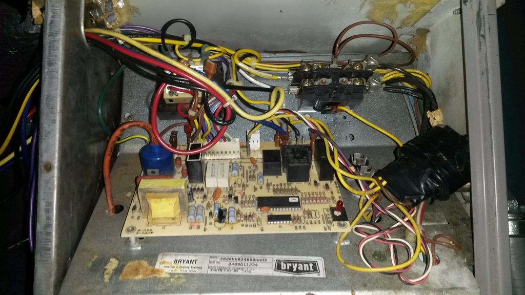

Fan on/off Delay Modified. I am sending a pic so I know I am testing what you are telling me to. I will use AC volts. I found J2 on the board it's a 12 pin plug? do I take the plug off when testing? What does the black test probe connect to and what does the red probe connect to? Please explain this part of the testing. I'm an IT guy with a little electrical knowledge, but I need more detail. thank you.
When I put a clip on both terminals doesn't that eliminate that limit switch by keeping it closed?(only while testing)
I tried to upload a picture of the board but it wouldn't upload. I tried to zip the file but to didn't compress it enough. I would be happy to email it to you. Looking at a board and looking at a diagram on paper are much different for me.
When I got home from work I turned the breaker on. I turned the thermostat up. Inducer started burners light, blower fan on for 8 minutes then everything off. I am watching for the red LED. Steady red. After 10 minutes the inducer starts, burners light, blower fan on for 9 minutes, then everything off. Nothing on LED, steady red. The furnace comes on one more time, runs about 10 minutes then shuts down. It cycled like this 3 times, no indicator on LED, steady red.
It has been over an hour now, I have left everything as is, thermostat calling for heat, nothing happening on furnace.

Aren't the limit switches wired in purple wire ? There should only be two purple wires on that plug.
At this point we don't care which switch it is..... we just want to know if it's that limit loop that is causing the problem.

Very carefully put your probes in the white plug with the two purple wires. It's AC. There is no polarity. You should measure 0v at all times. If you see any voltage there it means your limits are opening.
Name:  Furnace Circuit board1_zpskzhcmpzm.jpg~original.jpg

I have a fluke meter with the normal probes. If I cannot get the probes in those slots could I just use two pieces of small wire in the plug to put the probes on?

Two pieces of wire would be fine. You may have to fold it over to make good connection.

I put my probes in the plug and they did fit with the plug on due to slots in the front. I measured around .4mV
The furnace got voltage up to 2.2V and shut off the burners. The voltage went a little lower on one test. After about 15 seconds the burners came on. The other test the voltage got up to about 2.2v and shut down and meter showed 37mV. The burners came back on after about 15 seconds. The furnace randomly turns on and off. It started raining and I didn't want to get my Fluke meter wet so I stopped testing for the day. I will test again on Saturday. Any suggestions for Saturday.

FLAME SENSOR CLEAN WITH DOUBLE 0 EMERY CLOTh

I cleaned the original flame sensor. I then ordered a new one eliminating that as the reason. Thanks for your advice though.
That is showing that there is a problem in the limit circuit. That voltage must remain near 0v. I'm not sure at what point the board sees it as an open but apparently it's near or just under 2.2v.
This means you need to physically follow the wiring. You'll probably need to remove and clean the connectors on each limit switch.

I have cleaned all of the contacts/connectors for the limit switches and rollout switches. I double checked to make sure all of the wiring was reinstalled as it was by photographs.
I now have a new issue. The burners will not ignite. The inducer motor starts, the ignitor sparks for about 10 seconds, stops about 50 seconds, sparks again 10 seconds. During this time the inducer motor is on and the blower motor is off. After attempting to ignite about 5 times the igniter and inducer motor shut down. There is no indicator light for an error. It is solid red. I rechecked all of my connections and got the same results.

Additional from the post on 02/23/16. At the third attempt the burners did ignite, shortly afterward the blower motor started. After 3 minutes blower motor shut down. Indicator light blinked 5 times.
