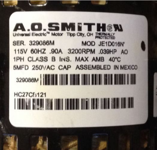

Taking the draft inducer apart isn't hard to do but there are gaskets that may break and parts that may not come apart.
I show HC27CB121 as the inducer part number and 326058-755 as the new replacement.
That inducer does feature a two speed motor. I don't normally rebuild the inducer...I replace the entire assembly.
The factory Carrier part is very expensive.
In the following link.... Repair Clinic shows a replacement blower wheel for that inducer.
Carrier Furnace Model 58MTB060-F-10112 (58MTB060F10112) Parts from Repair Clinic

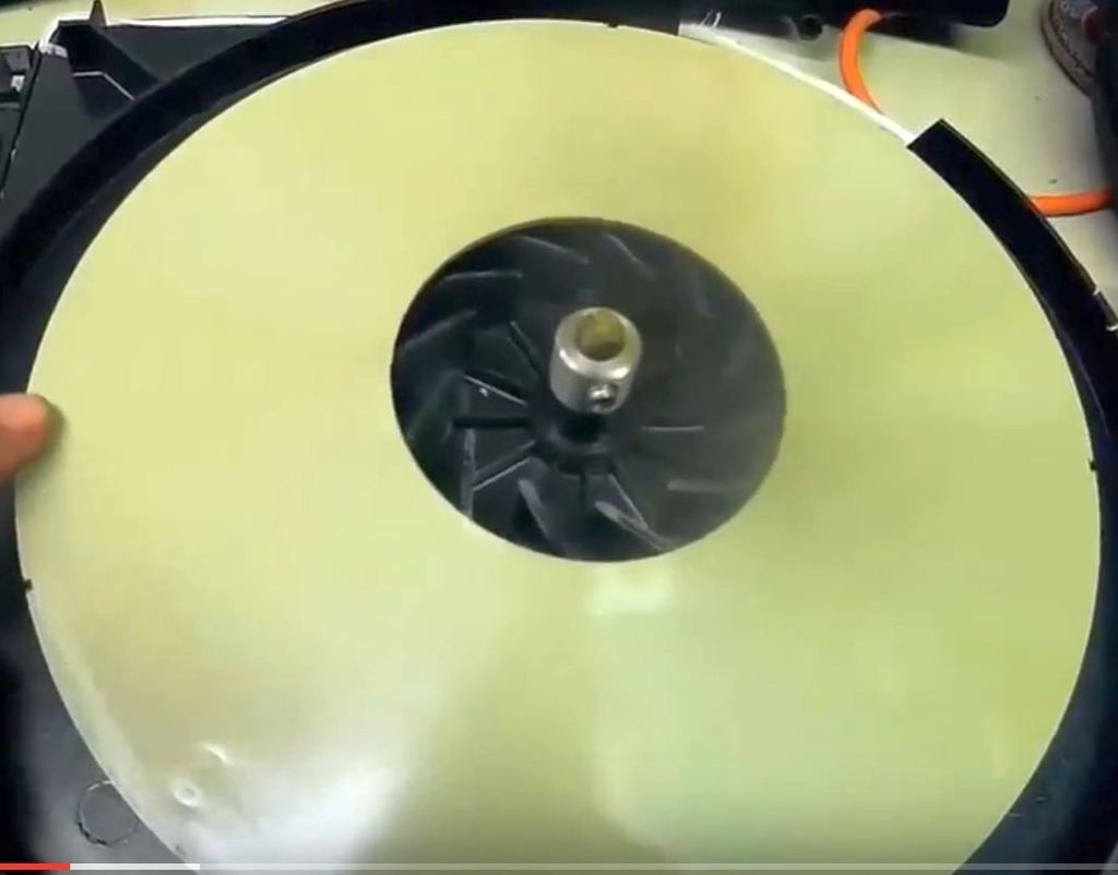

There is a similar Carrier inducer assembly (but with a different motore) being disassembled here:
https://www.youtube.com/watch?v=s684fW4RQvc
The fan is exposed at about 5:00 into the video, and at 6:30 into the video he states that the part number is "322592-701", which is the part you pointed out. Amazing Youtube.
After seeing that video, I believe that the shaft of the motor may be spinning inside the impeller at high speed (high air resistance) and not slipping at lower speed (lower resistance). I'll have to take the assembly apart to see what's what.
I'm sure my neighbor would rather buy the impeller than the entire assembly. Yes, that assembly sure is expensive.
I'll post again when I know what's what. If the shaft is indeed slipping, maybe I can do something to prevent that from happening.

The wheel looks to be high heat plastic. It may have cracked. Usually they are metal and are held on with a setscrew in a collar.

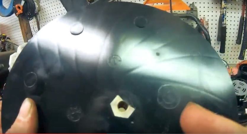

This morning I went over to my neighbor's place. In short, we disconnected maybe three hoses; removed the six screws from around the periphery of the front half of the assembly; pulled the front half right off the gasket and the back half of the assembly remained firmly in place.
It was not necessary to disconnect a single electrical connection.
Then we merely turned the front of the assembly around and removed the impeller. The impeller's set screw turned right out very easily and the impeller instantly, effortlessly slipped right off. There was no corrosion or buildup whatsoever.
The above surprisingly simple process took a total of maybe five minutes.
First we checked motor-shaft play and it was acceptable, so the motor is fine. I'd like to take this opportunity to replace the bearings anyway, but my neighbor is reluctant.
Then we examined the impeller. The hub of the impeller consists of the metal sleeve which penetrates all the way from one end of the impeller's hub and protrudes perhaps 3/4" from the inner end of the hub that is still inside the intake-side of the impeller itself, but faces the opening in the other half of the assembly.
The problem with this design is that the plastic impeller and its integral hub is molded around that central metal sleeve. In the inside facing the furnace, the plastic part of the hub "rides up" the metal sleeve perhaps 0.5 - 0.75" and is the same OD of the metal sleeve. IMO, the plastic that rides up should be much larger OD and the other plastic in that area should be beefed up or a different plastic compound should be used.
In that area there were three significant cracks that penetrated all the way up to the metal end of the hub, as well as all the way through the impeller to the side of the impeller that has the nut-shaped end of the metal sleeve. These cracks "fanned out" from the metal perhaps 1-1/2" and could be felt by sliding a fingernail over them. I could open up the cracks a bit by attempting to move the metal sleeve while holding stable the plastic part of the impeller. The is no doubt that these cracks will increase in size/length and the impeller will fail catastrophically during operation. In short, this part should have been made entirely of metal.
Because we are supposed to have some very cold weather over the next few nights, my neighbor actually wanted to re-install the cracked impeller and run the furnace, but, in the end, I convinced him not to. I understand that if the impeller breaks apart during high speed operation, the flying parts can irreparably damage the large plastic parts of the assembly and, in that case, the entire assembly would have to be replaced, again, at considerable cost.
So we have to acquire a new impeller. My neighbor is calling various Carrier dealers to determine if they have one in stock and, if they do, if they will sell it to a DIY person. Should any dealers have one in stock, there are ways to work around acquiring it.
