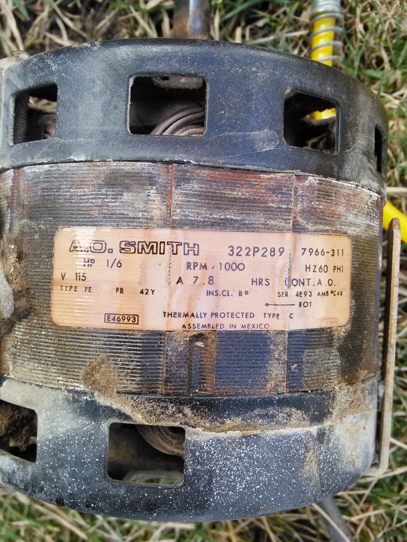

OK blower wheel was a bit stubborn coming off the motor shaft. used some penetrating oil and a small blow torch to heat the blower wheel a bit and it slide right off. The old motor is a A.O SMITH 322P289 1/6HP 1000RPM CCW ROTATION. Front of shaft I can see a silver metal ring that rotates with the shaft. I gave the front some oil but back is unnaccessible. I ordered a new motor though for under $100 it says long island development Model S1-7966-311P. Ill upload pics in a bit as I got to get them off my phone.

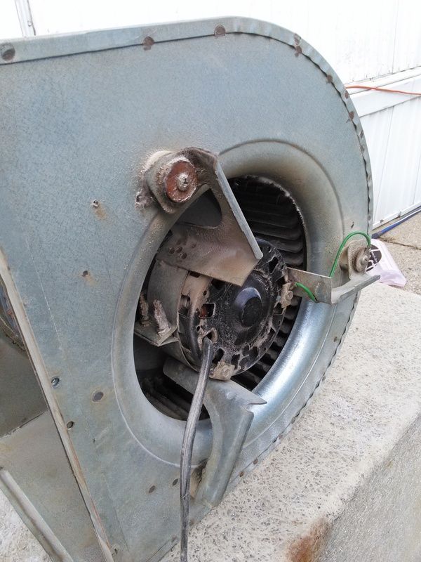

Pictures. You can see how dirty it was. I picked up a filter and will see if I can attach it to the door somehow with fishing line through the door vents. I oiled the front bearing with some penetrating oil and sprayed the rear bearing through the motor housing to at least get something on it for now. I did a test run after reassembling everything and it did not squeal but like said it won't last and the motor seamed a tad stiff without the blower wheel but started up without a load. A new motor has been ordered.
