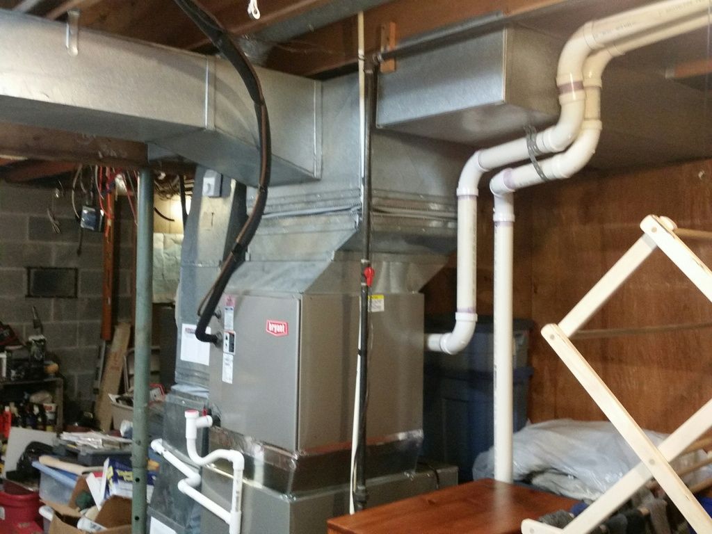

Please post a picture of the new install
Old 12-15-16, 05:58 AM
Join Date: Nov 2007
Location: MI
Posts: 2,612

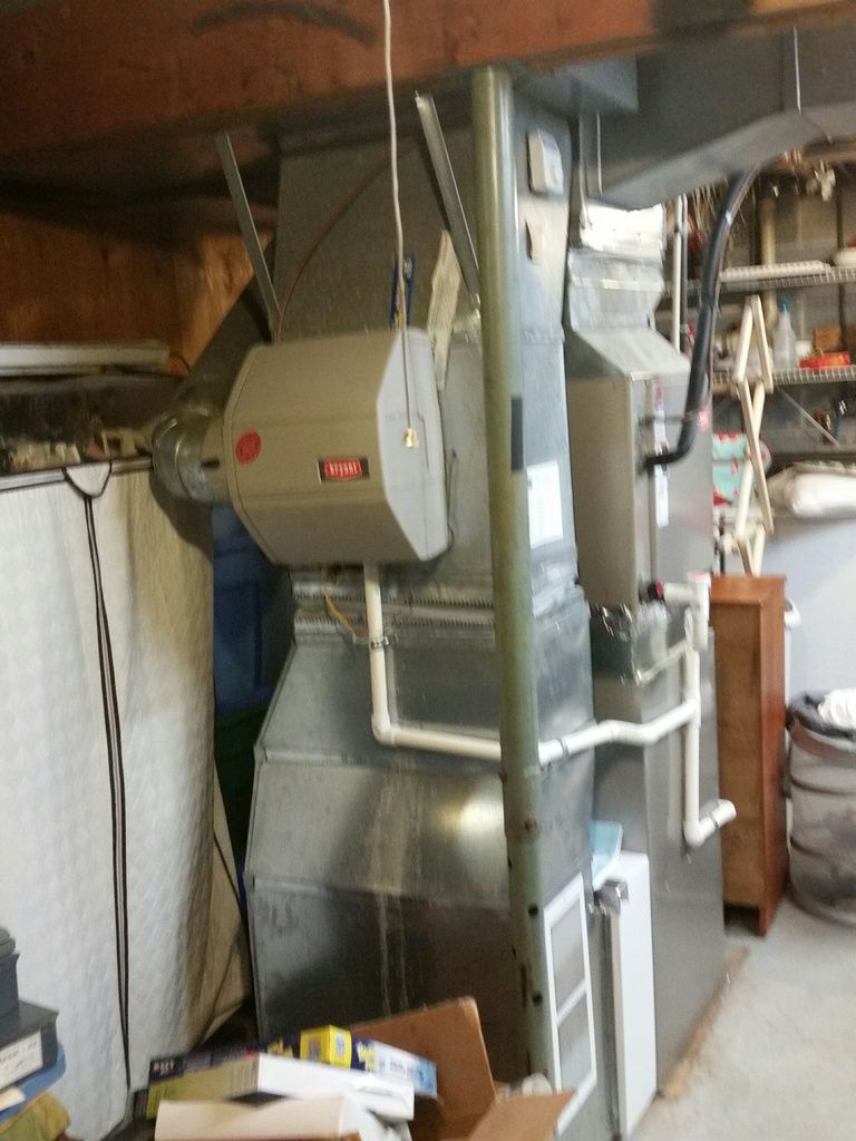

What are you looking to see? It looks just like the old install except shorter, with a little darker paint.
...And of course the "Red Green-inspired" piggyback blower, duct tape & cardboard that got me through the night is all gone ;-)

Do you want the long version??
Originally Posted by Muggle
...it's possible that there were issues with the original install or ducts which shortened it's life.
Originally Posted by Guy48065
...even though the Bryant was a POS I kept it going for 23 years.
Is 23 years considered a short life for a furnace? *I* would say yes but most the advice I read here is that it was way past due for replacement. My main issues were with the original installer that did nothing to match the furnace to the house. In 1993 they pulled out a 20 year old 100Kbtu oil burner and slid a 100K 90% NG unit in its place. No calculator involved. The previous owner had made changes to the floor plan which eliminated 2 hot outlets and 3 cold returns. You see the same thing on all the home improvement shows on cable--but they never show the rest of the story. I've had to deal with flow and balance issues since. The installers have been out numerous times, during the warranty and beyond, performing such clever "fixes" as opening up my basement outlets and cutting a big hole in the cold return right before the filter box. I removed my old SS chimney and used the chase as a cold return shaft for 2 of the 3 bedrooms affected by the removal of the wall on the 1st floor.
The Bryant has been short-cycling & hitting the high limit for 20 years but still soldiered on needing only the occasional ignitor. Also the various mfr. recall items like the controller board (2 different versions) and inducer assembly. Do I really consider it a POS? Maybe not but any furnace model involved in a class action lawsuit for bad heat exchangers doesn't deserve a recommendation, either. Ultimately that's what did it in. The blower quit but when I investigated that problem I found water on the floor under the cabinet. The HVAC company I had out verified the bad blower motor--and a cracked heat exchanger. I didn't feel it was worth sinking $1500 into fixing those 2 problems.
The salesman told me the variable speed blower on my new furnace will adjust to compensate for the flow problems and maintain correct static pressure in the airstream. I hope he wasn't snowing me or I'm going to have to assume ALL HVAC people are scammers.

Post some pictures of the install

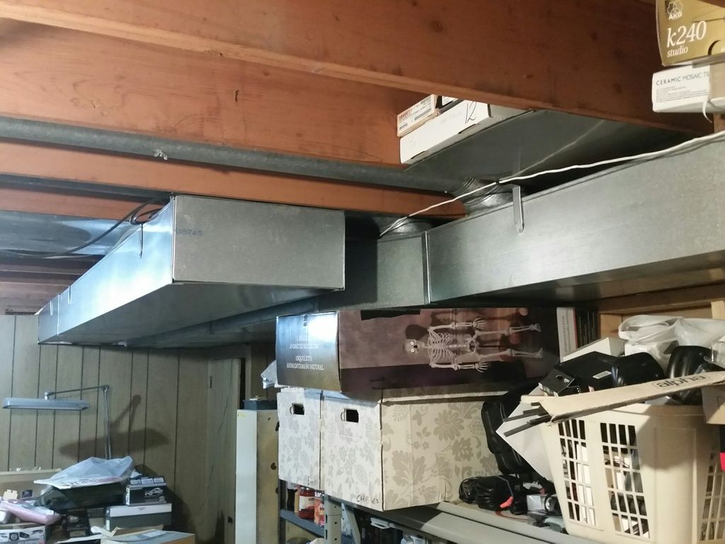

Ductwork and unit. Pictures are worth a thousand words.
The unit has a minimum distance to combustibles so items cannot be stored right around it.

I don't know what you can tell from these.

Question:
Do you have a natural draft water heater? pilot ignition venting into metal pipe with drafthood?
If yes, it's very unsafe to have a return air vent in the same area.
The return drop is very sloppy and small. I don't know if that was there before or they modified it to put the new furnace.
Most if it looks undersized - they put a transition to the correct size for the filter opening rather than putting the proper size drop.
I would want at least a 24 x 12" drop.
That may have contributed to the old unit cycling on limit and will contribute to higher than necessary electric consumption with the variable speed ecm blower.
Otherwise it looks okay but i can't comment on duct sizing. we don't know the sizes.
Doubt the ducts are actually sized large enough for 100k furnace.

That return duct hasn't changed in the 23 years we've lived here. All ducts are original to the original 100k oil burner
The filter box has always been the same dimensions--it's just gotten wider as media choices have changed.
Any transitions that have been made were to adapt shrinking furnaces to my bonnet.
Well, the small return drop definitely contributed to the limit tripping on such a big furnace and having return air grill right beside the furnace is dangerous with any atmospheric combustion appliances there.
A good contractor would have insisted on fixing that.
The drop should be the length of the filter.
