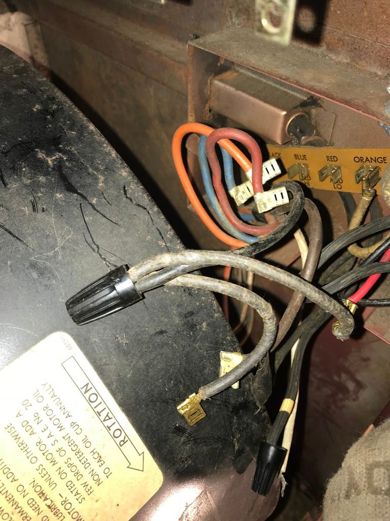

Is my Furnace Motor a 1,2, or 3 Speed?
i canít find it how many speeds this is. I would assume 3 because on this board it shows lo Med and hi, but a guy at a local shop thinks itís a one Speed because of the wiring. I have 6 wires out of the motor. Black, orange, red, blue, brown and white, plus the ground.
any idea?
thank you

A 3 speed motor usually has 4 wires exiting the motor as the neutral side of each of the 3 windings are connected inside the motor with one neutral wire exiting. There should be a legend on the motor indicating which colors go with each winding (speed) and the connection to line and neutral for a desired rotation. Only 1 winding is energized to run the motor. If you provide the manufacturer and model number, I can check further.

This is a one wiring method but there are others.
Like beelzebob mentioned... it needs to be confirmed.
red - low
orange - medium low
blue - medium high
black - high
white - neutral
capacitor connected across brown and black

I wish I had a legend.. itís destroyed with age, the my main problem with finding this information out. So on that little panel it says hi, Med hi, Med lo, and lo. This would be a 4 Speed right? Also my transformer has 240v on t so Iím assuming that tells me enough to identify the motor right? 240v 4 Speed motor? Shaft size and diameter of motor are typically the same right?

The attached picture of transformer is called a control transformer because itís secondary voltage is low voltage, 24 vac and low power 40 VA. The primary winding of this transformer has connections to operate from 120 or 208 or 240 vac . 120 and 240 are single phase voltages while 208 is a 3 phase voltage. It would be rare to find 3 phase voltage from the utility connected to a residential home. I am assuming this is the control transformer for the furnace utilizing the motor in question. There is no correlation between the AC voltage value supplying the transformer and the motor. The motor (I am assuming single phase) manufacturer designs the motor to operate from a single AC voltage. Some motors can operate from one of two voltages (user selected) and are more expensive. In a hot air distribution system like yours, normally a motor speed is selected for warm weather and a different speed is selected for cold weather by moving the line wire to the desired speed tab on the terminal strip. In your case, you can select one of four speeds for each season or change as often as you desire. What are you trying to accomplish?
