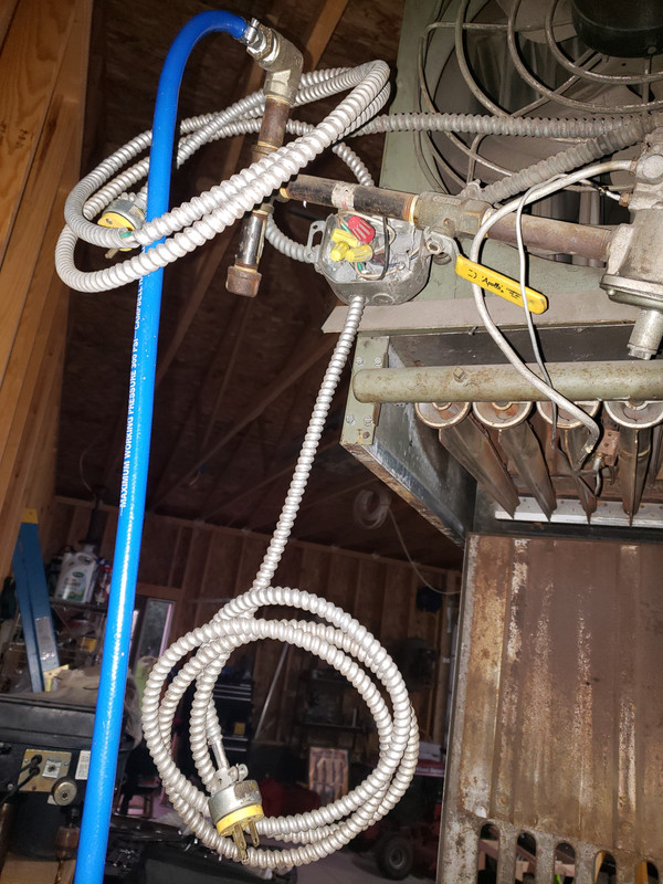

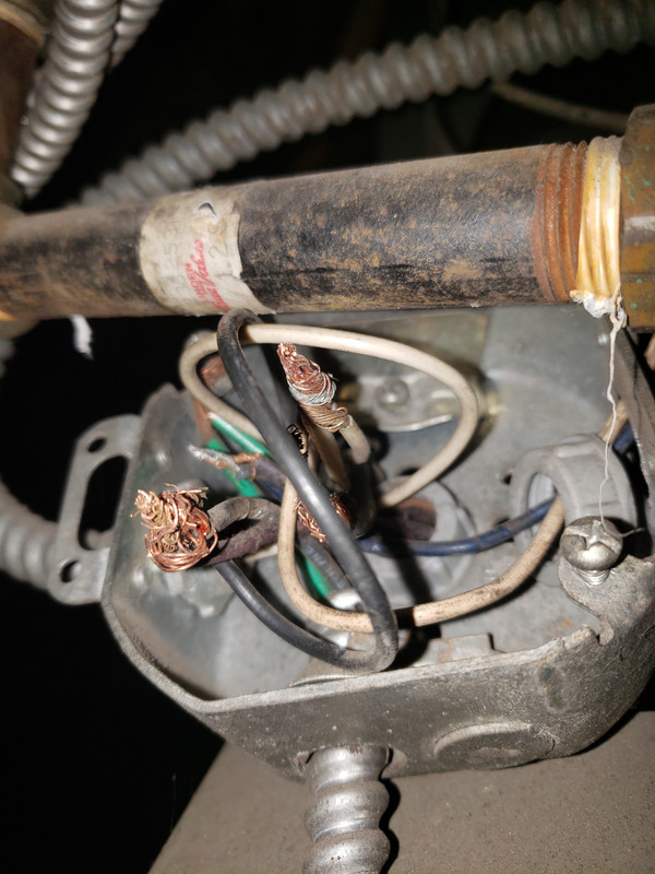

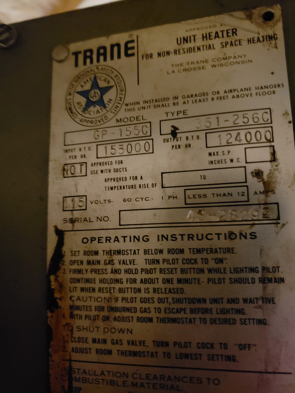

Hello all, I searched the forum best I could to see if anyone had issues with this particular unit heater but no luck.
I live in northeastern michigan, so yes we have cold winters and I wanted to install a heat source for my garage during those cold winter months. So long story short, my wife's cousin gave me a Trane Model GP-155C Unit Heater that I have been trying to get running. I'm not sure how old it is but I'm guessing at least 20 years since I can't find info anywhere on the web for it. Supposedly it was ran on propane for a number of years.

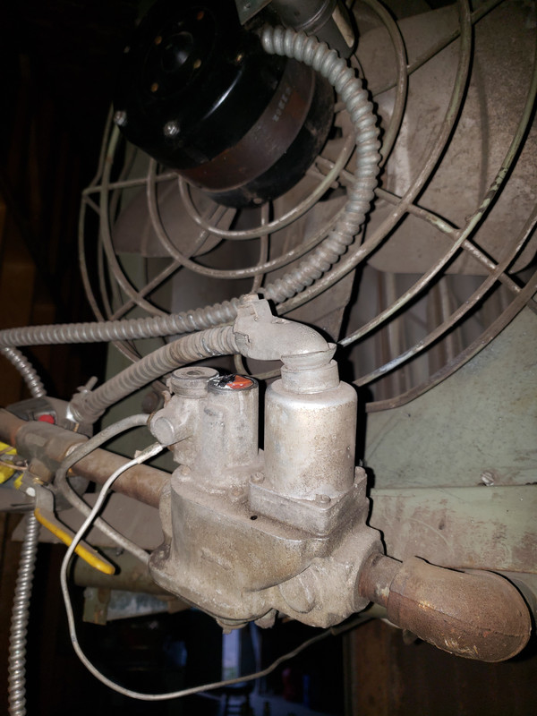

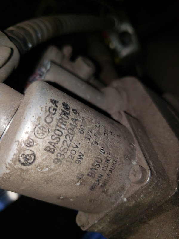

Anyway, at first I couldn't even get the pilot to stay lit but I managed to figure that out after testing the thermocouple and cleaning it. Now my problem is that I can't seem to get the Basotrol solenoid to open and actually fire up the furnace. I assumed maybe I needed to wire in a thermostat but not sure where to even start with that because I can't find any info for this particular heater. I'm sure it's simple but I'd rather ask someone familiar with it than rely on guesswork. Currently the blower (fan) has a dedicated AC power chord attached and then there is another power chord that is wired in. The fan works when plugged in but nothing happens with the second plug providing power and the pilot lit. Sorry if I am not proving enough info or using improper terminology. I have attached a few pictures that hopefully will help.

I cannot find any information on that heater. It may be quite a bit older than 20 years.

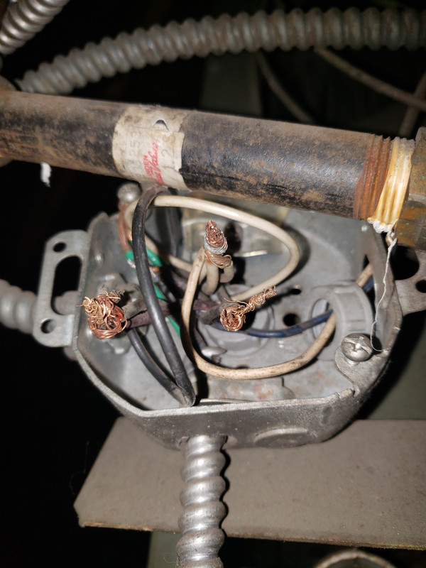

Ok. Your unit works strictly on 120vAC. No low voltage.... no 24vAC. That means you will need to use a 120v line voltage thermostat to run the unit.
Cable A = fan
Cable B = ?
Cable C = gas valve
Cable D = power ?
We need to identify the four cables in that 4" splice box.

B and D are 120 AC power

WHY..... are there two male plugs on BX on that heater ?

No idea, that's the way I recieved it. Glad I'm not the only one perplexed by it. Should I simply unwire everything and begin from scratch?

One of the two plugs most likely went to a line voltage thermostat connection. Not right or safe.

Let's assume that is the case, but when I have the pilot lit and I supply power to that line that would theoretically have been attached to a line voltage thermostat nothing happens.

You would supply power to one of those plugs and short out the other one.
You don't have to re-wire..... just pull the wiring out of the box and snap another picture.

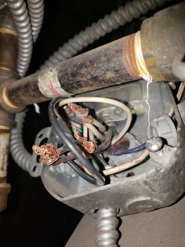

Not sure how helpful this will be since wires don't really have much slack:

I see more wires going out of the back of the box. Where do they go and how many wires are there ?

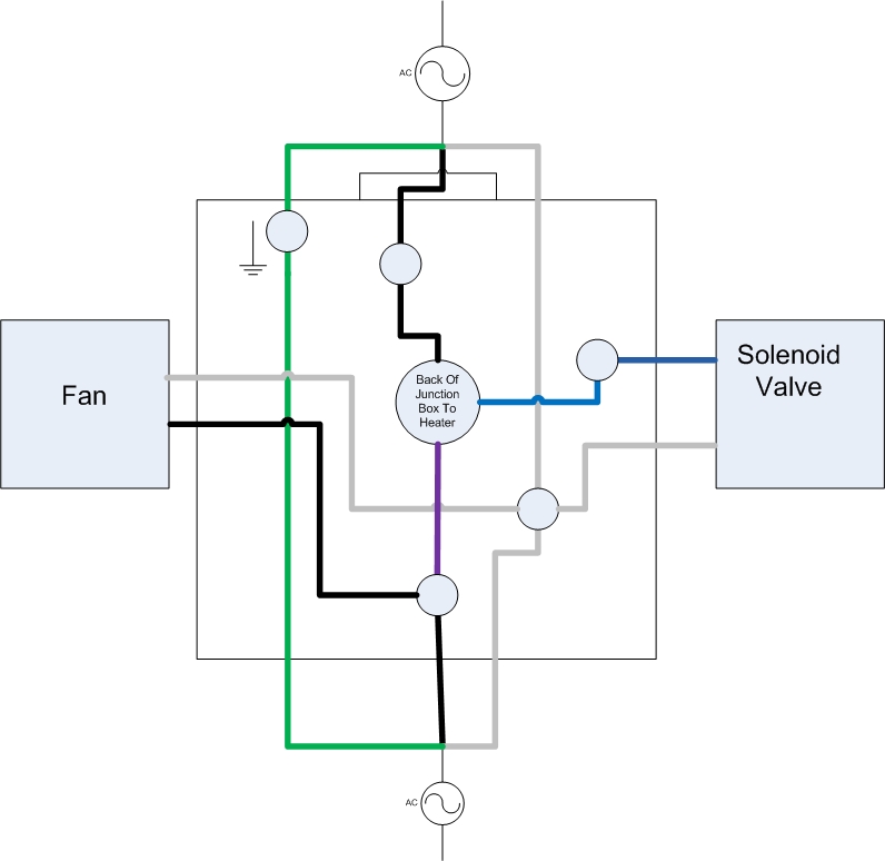

Yes, there are 3 wires running through the rear of the box into the side of the unit. I didn't even notice them previously, but I can not tell where they are going inside the unit without further disassembly. The wires are colored blue, purple, and black. Here is a rough diagram of wiring:

Yes.... there are too many variables here.
We see a 120v gas valve.
We see a 120v blower or fan.
We don't see an internal thermostat to cycle the fan based on heat.
We don't see any over heat safety sensors.
I suspect the missing items are at the end of those three wires but cannot guess.

The wiring running out the back runs to this sensor I believe:

Here's a very basic diagram of what you are trying to do. See if you can identify the limit/fan control on your unit. An ohm meter can help you to identify the normally open and closed contacts, no need to remove it. Get rid of the extra male plug for now, I suspect it was used for summer fan operation. If you want that option we can help later, first concentrate on the heating.

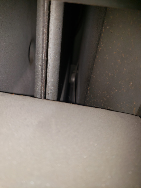

That last picture, is that a heat exchanger cell we are looking at? Is it split?

No sir, that is just the lighting.

Also, once I put the wiring back together to determine which plug powered the fan in order to remove it I can now here the solenoid valve opening when I plug in the one that does not power the fan. This didn't occur before so I assume there was a bad connection.

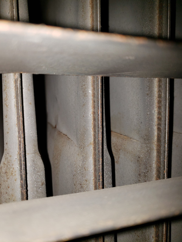

So I was trying to figure out how to get that thermal cutoff sensor out today and noticed what appears to be cracks in the heat cells. I assume this is not a good thing.

Your unit heater is dead.

Well, I wish I would have been more observant before wasting your guy's time. Thanks for all the help.
