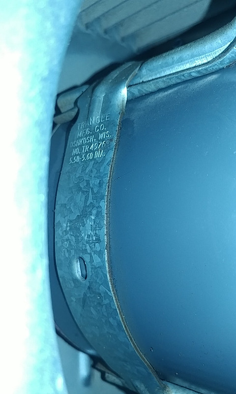

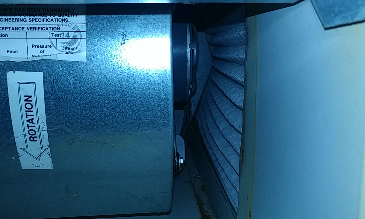

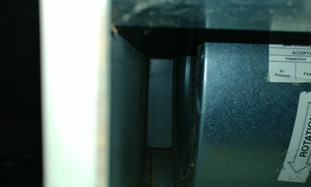

Hello, PJ Max:
Thank you for your reply. I could not find any lights in the lower most compartment where the blower is located. See below all pictures including the board.
I suspect it's the smartvalve as it works when I wiggle the wires on both the ignitor and main. It used to start by just flicking the main switch on and off ; and now I have to sort of wiggle the wires
