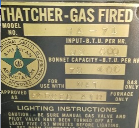

So guys, this old Thatcher Gas furnace stopped blowing air 2 days ago because the motor belt got busted which the tech replaced with a v-belt and it is up and running again.
However the Tech said would be best to get a new furnace since this one "can break down at any time" and doesn't make sense to keep spending money repairing this, that and the other every few years. For "peace of mind" and reliability I am thinking best to get a new one.
The current one shows 99000 btu, the heating output is good, I can't raise the thermostat to more than 75 degrees and only go that high on super cold and windy days otherwise I would need to open some windows:
This is a 2 family 60 year old house so not the best insulated. We don;t have much money so not being cheap so therefore I am looking into getting just a decent good one which will work for us.
So can you guys recommend brands and btu or any other specs I should shop around for please?

Brand doesn’t really matter, the quality of the installation will determine how well the unit runs. If you do an online purchase it should be noted that you’ll likely get little to no warranty coverage.
It starts with a load calculation to determine sizing. There is no rule of thumb here.
This is a free version of manual J-
HVAC Load Calculation - Maunualj - Whole House Loadcalc
Bigger equipment is not better. And your old furnace is likely oversized.

Those furnaces were very dependable and will run until the chamber cracks. If this was my furnace, I would replace the fan/ limit control which is probably the problem with the fan not working. If the furnace chamber is not cracked or deteriorated the only thing you will gain by replacing it is a lower operating cost. The teck that said that this furnace can break down at any time is telling the truth but he forgot to mention that a new furnace needs much more service and is prone to breakdowns due the complexity of the new electronic controls. If you want a lower operating cost and have the money, go buy a new furnace otherwise repair this beast and enjoy the cost savings

You did not ask this but let me say that in a colder climate like where you live the best money would be spent on; 1) wall and ceiling insulation. 2) windows 3) A new furnace in that order. Older furnaces are less efficient and usually require less attention than the newer high efficiency furnaces. There is nothing wrong with an old furnace that is used for heating only, as long as it is not defective in it's integrity and is safe to operate.
