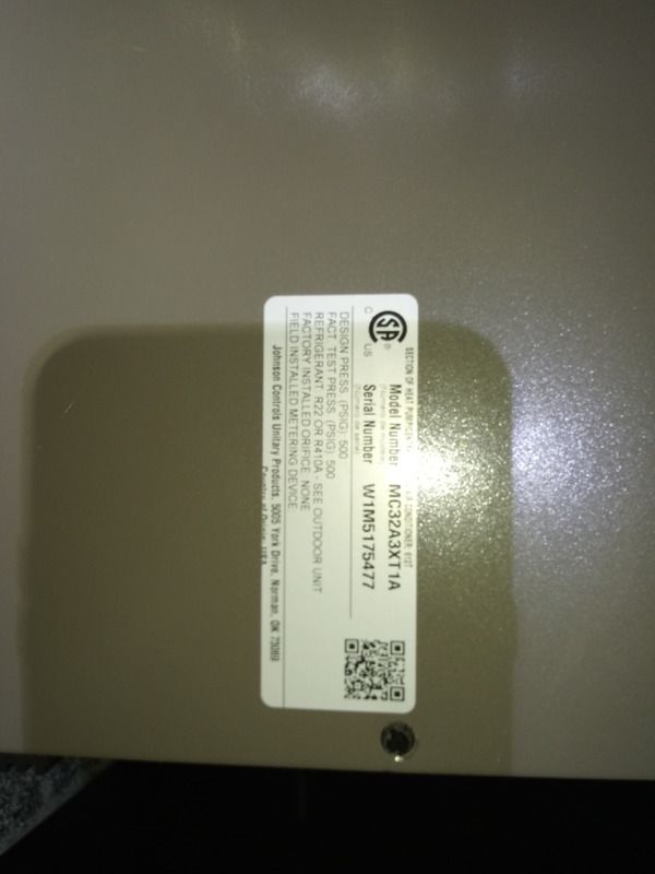

I got the model number wrong, it is actually: TG8S060A12MP11B

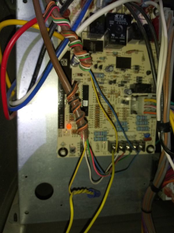

So I went down to the crawl space with an HVAC guy who is a friend of a friend. He showed me that when the pilot goes out all I need to do is hit a light switch to see if the pilot stays on.
We observed a light flashing 7 times. He took a measure of some motor and believes it to be slightly out of spec where spec is supposed to be .5 or .05 or .005 etc. and the reading is .6 .06 or .006 etc.
He also mentioned that some metal ducting going into the unit was experiencing drafts from the outside. The ducting lead to the roof and he mentioned that the cap was still on and that everything looked alright.
Poking around here there seem to be quite a few posts with the 7 flashing lights.
While waiting on the HVAC guy I'd like to know if anyone has any additional ideas.
Thanks.

So 800 bucks later, the HVAC guy cannot figure out what is going on. All filters have been identified. Flame sensor has been cleaned, Inducer Motor replaced, some switch, and the control board has been replaced.
It cycles up to 3 times and then blows cold air for an hour. Replacing the board just made the blowing the cold air last about 1 minute....obviously a firmware update.
This is definitely a York Furnace.
Help!

You need a new tech, desperately.
I haven’t a clue why you were told anything about a pilot light because your furnace has no pilot light. No such thing exists on your furnace.
An error of 7 red flashes should be an ignition lockout.
Has this guy checked mA from the flame sensor? Gas pressure? Cleaned the burners? Checked the propane regulator?

The manual does not have a parts list which includes part numbers.
Is there a way to get that parts list with part numbers?
Also, the manual does not show the below part from what I can see.
What is this part called and should it have this white area on it? Is this the ignitor? Is it also referred to as the "hot air ignitor"?

The pictured part is the ignitor, more specificly, hot surface ignitor. That partcular one appears to be made of silicon nitride (lucky for you). Had it been silicon carbide, it would hve broken when you used sandpaper. The white is not unusual.
Most service manuals for furnaces don't have part numbers in them.
Part number listing for TG8S furnace
That igniter is OEM part # S1-02545231000. That is the one part that it is advised to have a spare of. They can crap out at the drop of a dime. You can search using that part number.
