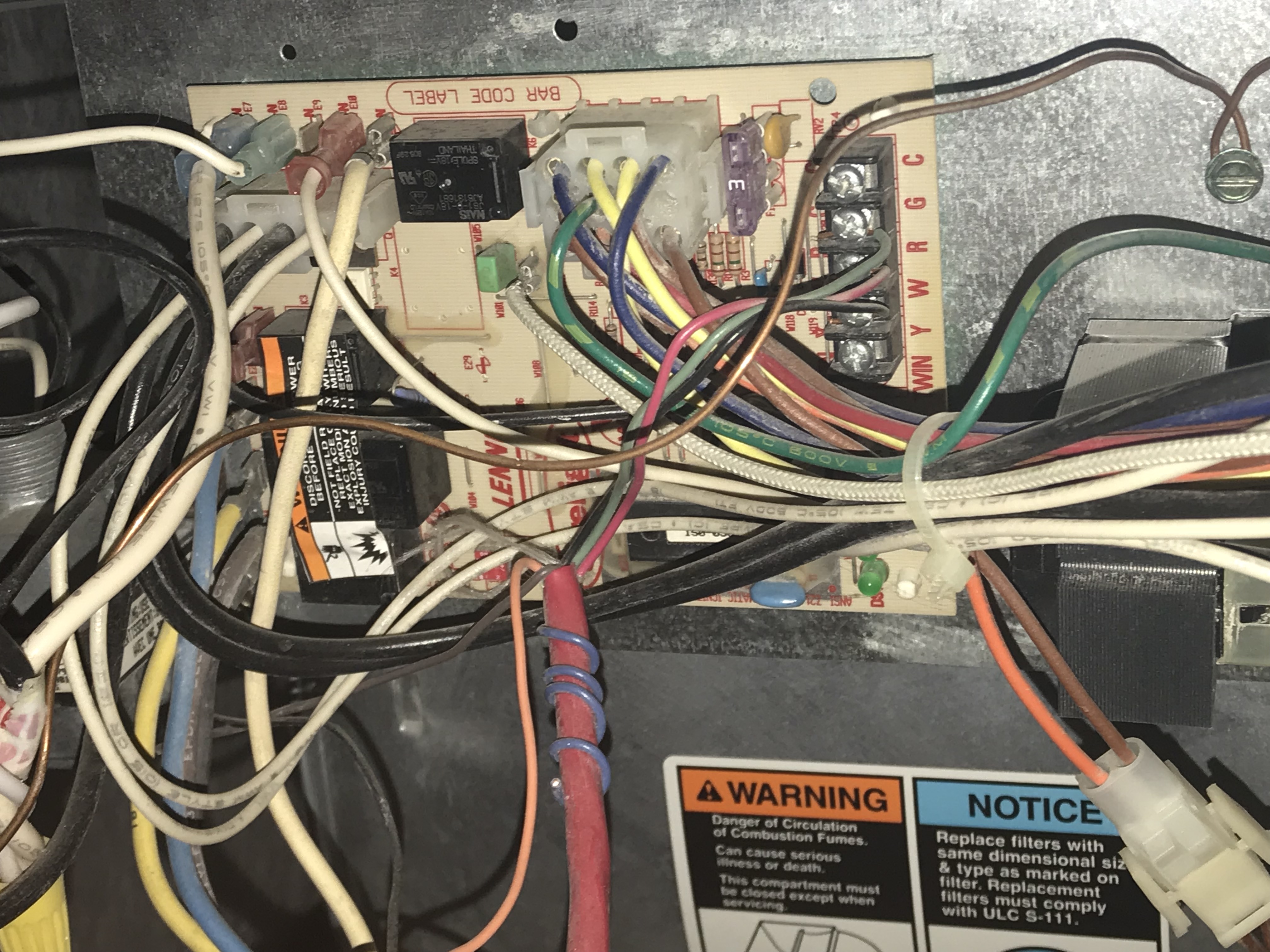

Hi, which control board do you have?

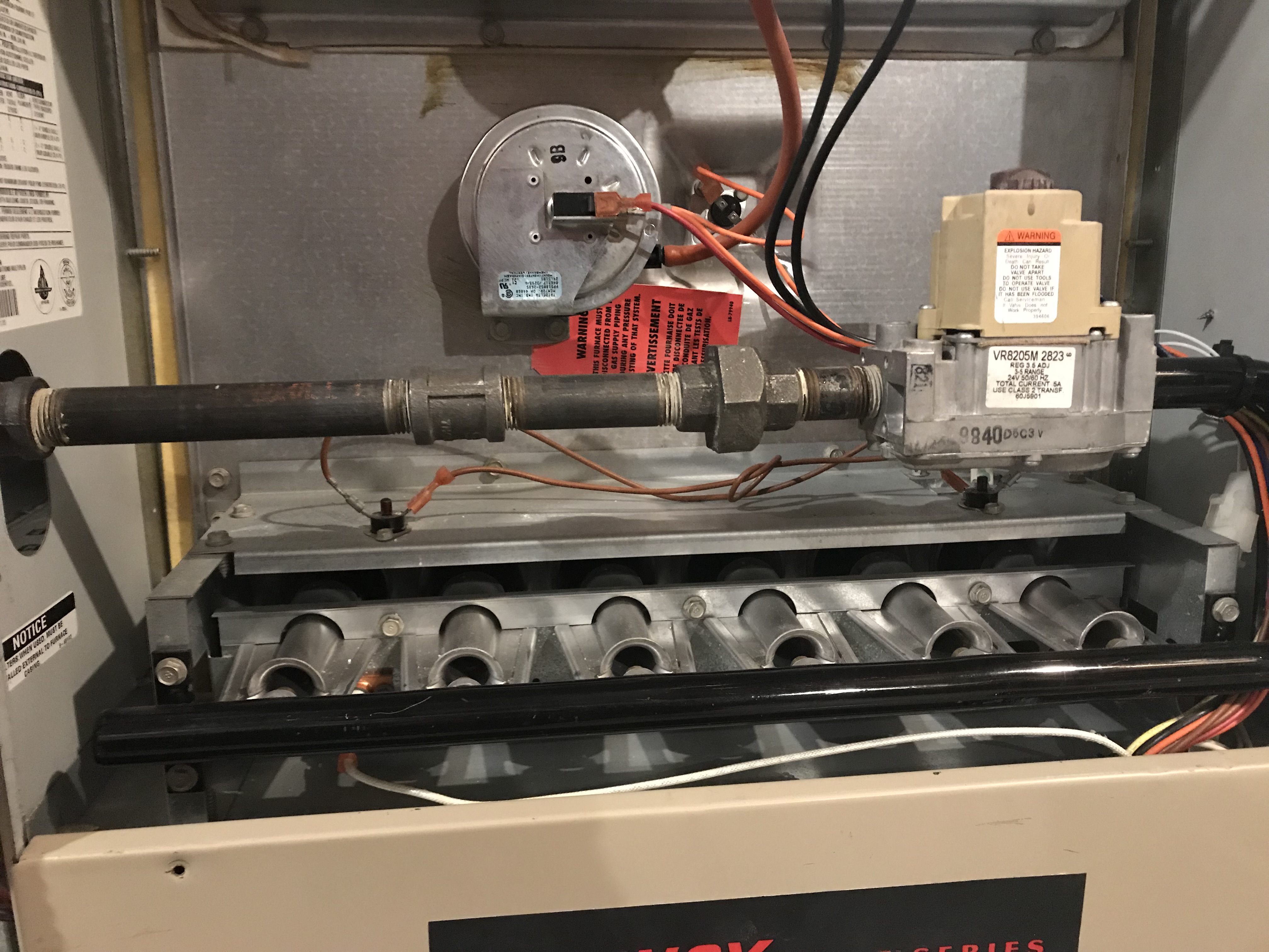

I am not sure what model it is, it's 20 years old..I have pictures but don't know. When I called my LENNOX dealer he said the model I need is Y7761 which is probably an updated version. The Furnace is 80UHG3/4-120A-2
and here's an image of the upper section showing the Limiter Switch and the Rollout Switches:

One suggestion you may try, get an inline fuse holder and a 1/2 Amp fuse and put it in parallel across the limit switch , do one switch at a time, if the limit switch opens it should blow the fuse, proving the switch is bad. This is called a Tattle Tail

I called a service company to come in, and he came and did a little diagnostic for $69... Bottom line is: the 12-pin harness's socket on the board has something loose inside. The harness itself is good, just the socket on the board is actng up... If we wiggle it a bit, it's solving the problem and the furnace is working normal... I may be able to prolong the ultimate solution which is to replace the board, but eventually I will need to change it. The technician said the original part number written on the board is 12L69 (there are other universal versions) which should cost me around $280-$300 from the local supplier. They wanted $879 to replace it.... I guess I will have to do it myself or find someone to install for some cash...

Good, glad you found the problem, could be a bad solder joint behind the plug on the board also.

It is very possible that plug has corroded pins. It's a 50-50 tossup of poor solder or corroded connections. You can get a can of contact cleaner and spray the plug part with the wires. Plug it in and remove it a few times. If no improvement..... use a little more spray. Don't spray the plug on the board.
