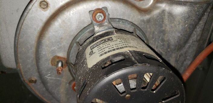

The burners are not coming on so there is no heat. I can hear it cut on, fan/blower is running, but no flames. I checked it hours later after leaving it running and there was a flame right in the middle(red circle) but not in the burners.

Just FYI..... gas furnaces need routine maintenance. That looks like it has a water leak and that needs to be addressed. That furnace is more than 2-3 years old. I highly recommend professional servicing every other year. Your local gas supplier usually has good cost effective service people.
I hijacked your picture. The yellow arrow should be pointing to an ID tag where you will find the model number and probably the age too.
The red arrow is pointing to the draft inducer and a rubber line.
The white arrow is pointing to the pressure switch and the other end of the rubber line.
Make sure that draft inducer is running.
There may be a sight glass in the blower door where you could look into to see a fault LED flashing.
Carefully remove the rubber hose. Make sure it's clear and clean. Check for it connects at the draft inducer. There may be a microscopic hole inside the fitting. That hole must be open. A pin or small piece of wire should work.

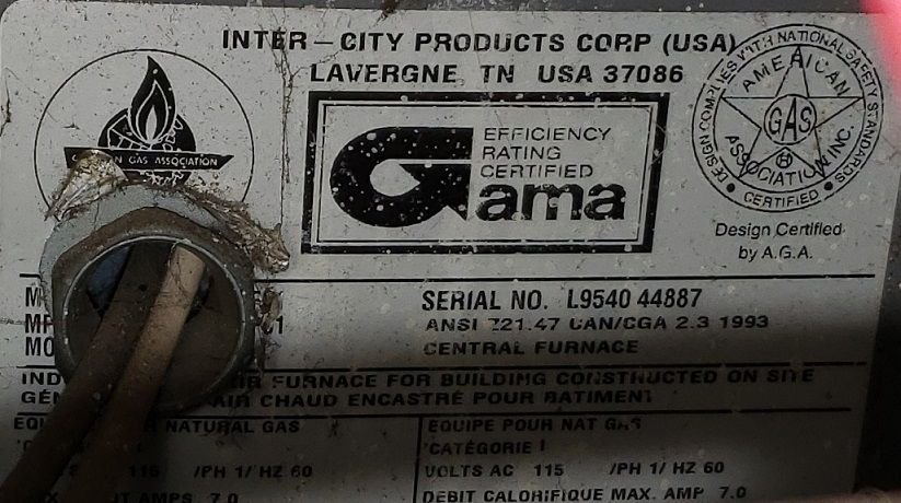

Unfortunately the installer drilled thru the model number unless from a different angle you can see it.
That looks to be 1993-1995 vintage. +/- 25 years old. That furnace needs to have its heat exchanger checked for rust thru which would allow CO into the home.

I'm fairly certain that the L9540 = 40th week of 1995 or October 1995 for date of manufacture.

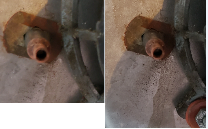

I messed up ... I went to clean the part that you indicated and broke off the teeth of an old cheap comb since I didn't find safety pins at the Dollar Tree store. I cleaned it and then decided to try going as far as I can and now its not stuck in there. Its my fault since I know the comb teeth wasn't that long and shouldn't have done that. I've tried using tweezers to get it out but it just got stuck deeper.
Any ideas on what to do? Should I turn it on hoping it will blow out OR would it even start if the red hose is not connected? I'm upset at myself ... I had bobby pins that I should have used instead ... completely forgot. I feel sick ....

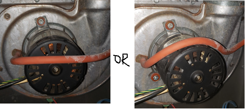

draft inducter part, before & after
Which one is preferred?

Shouldn’t be a huge issue but I wouldn’t want plastic in there that would melt. Just pop the inducer housing off and get it out.
That nipple isn’t so small that you need a comb tooth. It’s a bigger passage then that.

I was able to get it out ..using 2 safety pins. Whew! The stuck teeth-comb part was now preventing the furnace from starting and I could smell the burnt plastic ..... forgot to mention this earlier so I went from a furnace that works 80% to not at all. It's running right now but no telling when the flames will go off and refuse to cut on again.
PJmax I have completed cleaning the part, this time I used a safety pin. What's next? Here are more close-ups
If the comb piece had fallen in it would have just melted. Wouldn't have been a problem.
In your picture we are looking at the part where the hose attaches....the nipple. If you look back at my diagram you'll see a tiny hole down inside that fitting. Your fitting may not have that tiny hole but if it does.... it needs to be cleaned. If your fitting is completely open..... try putting something thru there. A skewer, a piece of wire, a finishing nail..... something that will go in about an inch. If it only goes in a little bit..... you have that tiny hole. If it goes on in at least an inch..... you should be all set.
The hose over the motor is good.

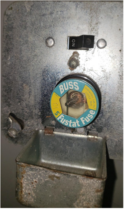

I don't see no unit that displays an error ( I have pics in the 1st post). It looks like this is a 1995 model.
This is what the Power switch looks like ... just turn if off and on ... do I have to do anything with that Buss Fuse ..button? Or are you talking about something else.
The board will be in the blower compartment.
I’ll second what was said previously in this thread, that the heat exchanger needs to be checked before proceeding. A furnace that old has a very high likelihood of having a crack or rot, which effectively makes the furnace unusable and puts occupants of the home in danger of carbon monoxide poisoning.
That’s just a fuse, not a button.
