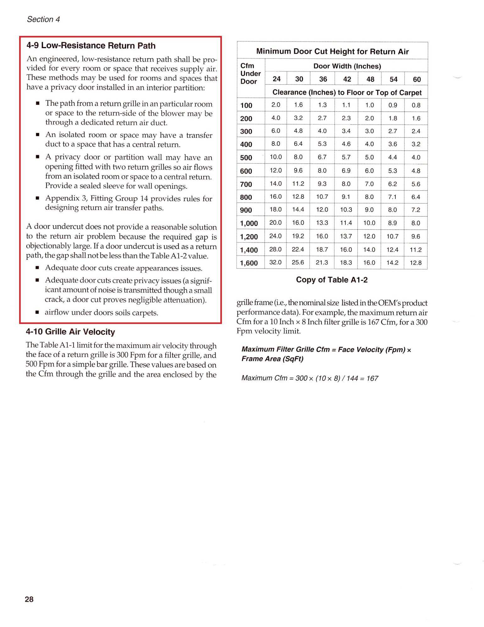

You'll also need to establish a Manual D "Low Resistance Return Path" at every large room separated from the return grilles by a door, too. AND why two returns? A single central return will be fine with the Return Path.

Lastly, we only have two doors, one for a bath, and one for a bedroom. The bedroom door is rarely shut. Would either of these rooms need a jumper duct?

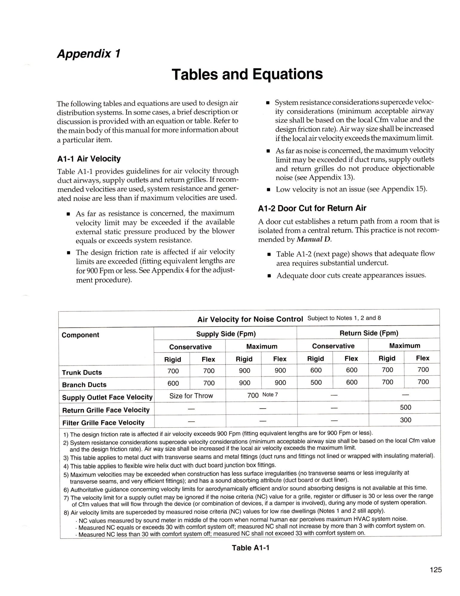

The 16" is too small, you need 18" to comply with the velocity requirement. Any competent Manual D practitioner should know about velocity limits.

"Rarely shut" is no different than "always shut" when it comes to designing duct systems. Do provide the required return path at the BR. Bath will be fine with the normal door undercut.

Manual D requires a friction rate of 0.60-0.180. Your designs are 0.104 and 0.116 which are in the middle of that range and should be able to handle a MERV 13 filter. Most people are quite happy with the mid-efficiency filters too.".

"Manual D requires a friction rate of 0.60-0.180." That's total BS. And they probably meant 0.06, not 0.60.
My Manual D (2014) is a 276 page book, and there's a more recent version (2016). Ask them which edition they're using, what page the friction rate requirement is on, and why they're not adhering to the velocity limits. OH...AND think about another contractor.

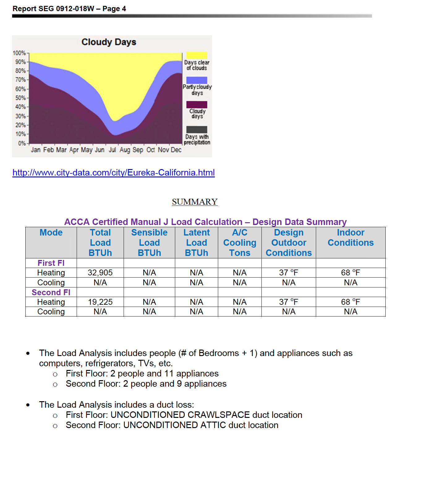

Here is a screenshot of the page. I do have an email saying the following, "We recommend a 60-65k output furnace with 2 stage if 2nd floor is not to be conditioned for some time.". I have not done anything to the 2nd floor as yet.
In the "Bad Old Days" we took window U factor as 1.13 for then current single pane double hung windows: Heat loss would have been U x A x TD = 1.13 x 1SF x 31F = 35.03 BTUH/SF in your climate using their 31F TD (It's actually 32F because they used 37F outdoor instead of 38F and 68F indoor instead of 70F). Today's window U factors are routinely 0.35 or thereabouts. So you gotta wonder about the "glazing" at 28.2 BTUH/SF, meaning they assumed 0.91 U factor!
Infiltration is calculated at 8,611 BTUH divided by (1.085 x 31F) = 256 CFM for the 1st floor sounds high.
I'm feeling much better about the 40!
And do your window rough openings total 6,729/28.2 = 239 SF? Strange but true: I ran across one practitioner who took every window rough opening as 15SF regardless of actual size!
