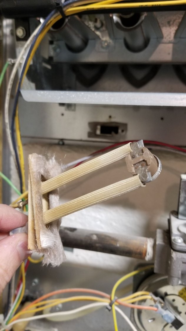

Good Morning,
Woke up this morning and the house was cold to notice the schedule was on for the thermostats. Went down to the furnace and I could hear the furnace fan running and could see on the zone control a call for heat from certain zones. I could not see the flames however.
I have run through some what i believe to basic checks. I checked the fuse on the board and that looks good. I checked to see if i could hear the inducer fire and I believe I can. I never see the ignitor glow. I don't know much about the multimeter but did try and disconnect the ignitor and poke the ends in to check for voltage when a call for heat but I don't see any.
I have attached an image of the ignitor and I think it looks ok or not?
Also i checked to see if any voltage being sent to the ignitor and you will see that below. The image however is the voltage where only the fan on. When the call for heat comes in it will quick spike to about 1.1 then drop to between .6 and .7.
Any ideas why this wouldn't be coming on?
Thanks for the help in advance.

No voltage will be applied to the ignitor when it’s sitting idle. And looks like you also had the door switch open when testing.

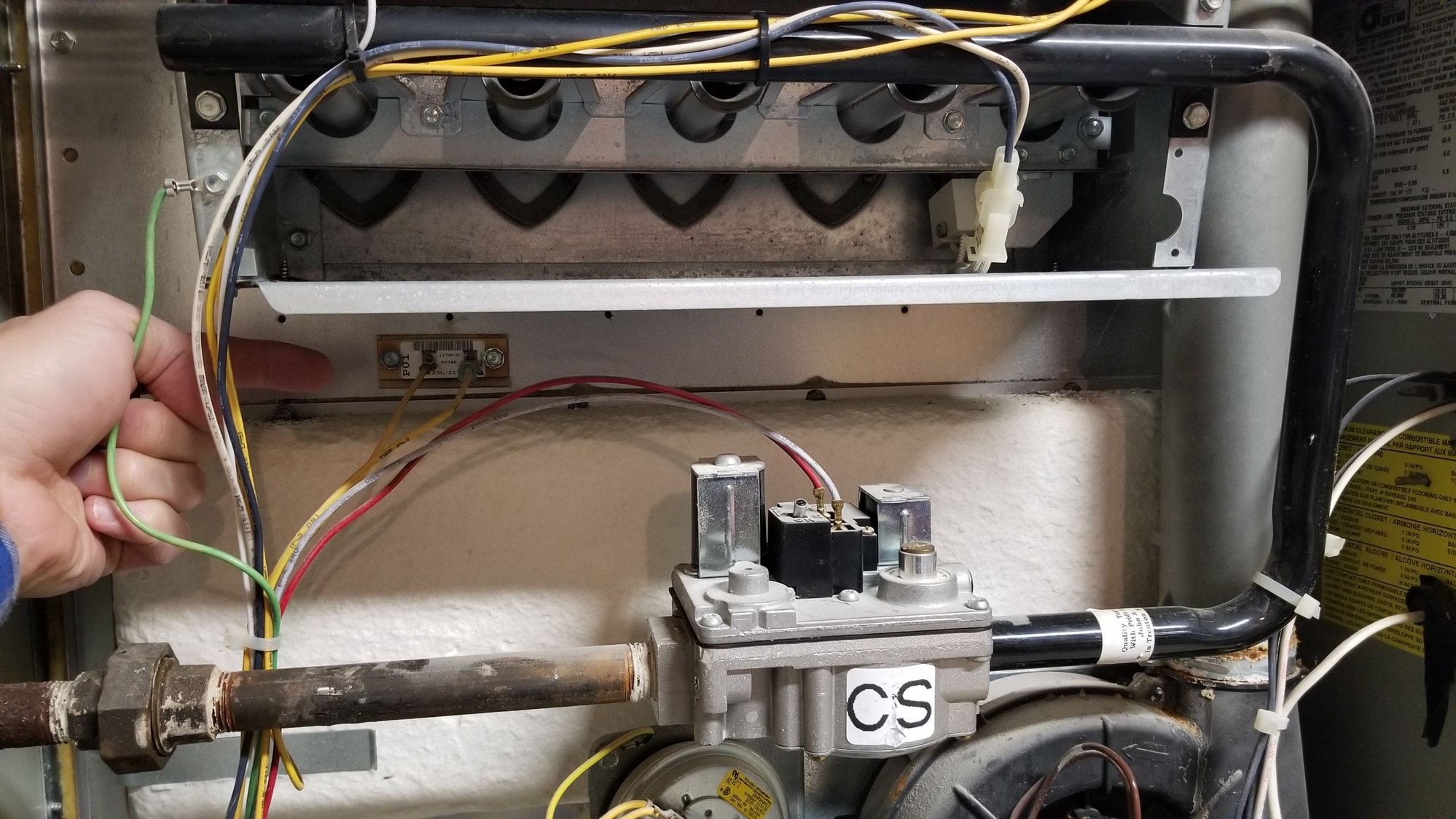

Is the below it? Is there a visual way of telling if not working right or it needs to be replaced?

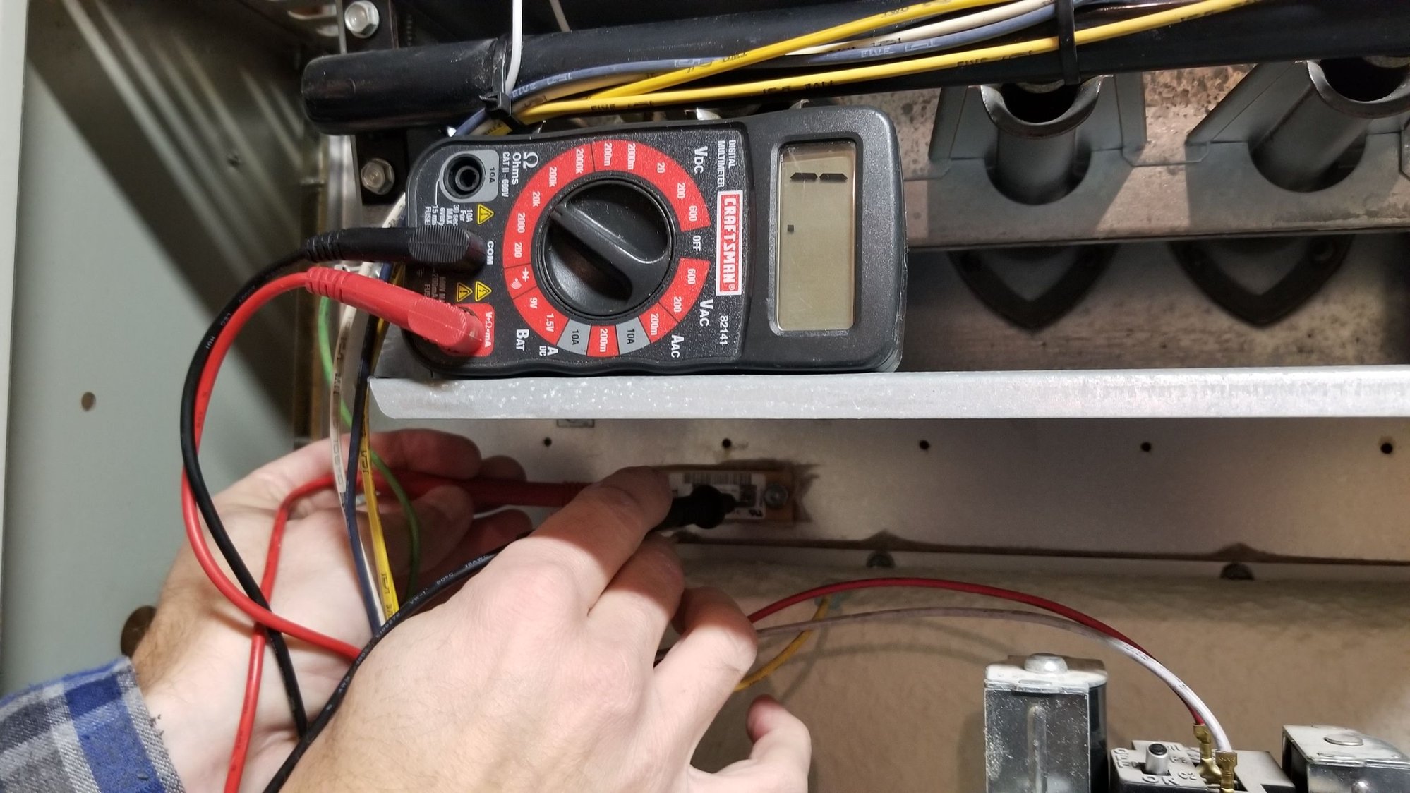

Can you tell me a bit more how i would test it with a multimeter? red and black to each wire?

That should be it. Test across the switch with your leads with live power. Or turn power off and ring the switch out with polarity/resistance.
You’ll have to figure out why it tripped. Take heat rise across the furnace when it’s running again. May be over fired. Are you using a very restrictive air filter?

Hoping this helps a bit. Here is the reading and my settings without power doing what i believe to be a continuity test. If i touch the black and red together i get a near zero reading so i believe this to be broken? Would that be correct?

Power applied to a working switch will measure 0V across the terminals. An open switch will measure 24V.
It would appear your issue is with another limit.
Looks like you may have found the problem. That sensor should read 0 ohms, shorted, have continuity, when it is cool.

I tested continuity and not voltage. not sure if you noticed that or not? Not clear how to test for voltage. If you can help clarify that I can get that for you?

So the sensor seems to be the problem. I did like Trying2Help suggested and it all fired up.
