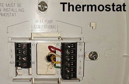

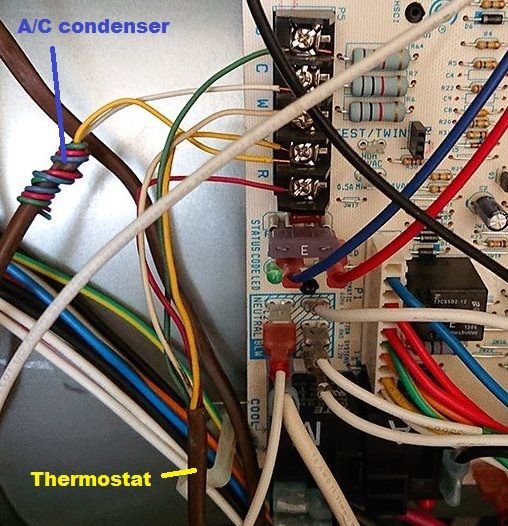

I currently have a thermostat that does not have a C wire connection. I was given a smart thermostat that says it is designed to work without a C wire but in some cases one will be needed. I checked the circuit board on the gas furnace and there is a wire coming from the C wire connection. Will the C wire be in the wall behind the thermostat? Why would they have it going from the gas furnace but not to the thermostat? The gas furnace was installed in 2014. I assume the thermostat was as well (seems like a fairly recent model - Honeywell). The house from the early 70s.
Please post pictures of your wiring....... How-to-insert-pictures.
We need to see the wiring at the thermostat and the furnace board.
If you look at the wire currently on the C terminal..... you'll probably see that it goes to a two wire cable. The other wire in that cable would go to Y. That is going to the A/C condenser outside.
As I described..... you have two cables at the furnace.
One goes to the thermostat and one goes to the A/C condenser.
The four wire thermostat cable is....
Red - R
Yellow - Y
Green - G
White - W
The five wire A/C condenser cable is.....
White - C
Yellow - Y
Blue, red, green are spares.
If you look at the condenser cable.... you'll see three wires wrapped around the jacket. Those are spares since it's a five wire cable and only two wires were needed. To bad they didn't run the same wire to the thermostat.
