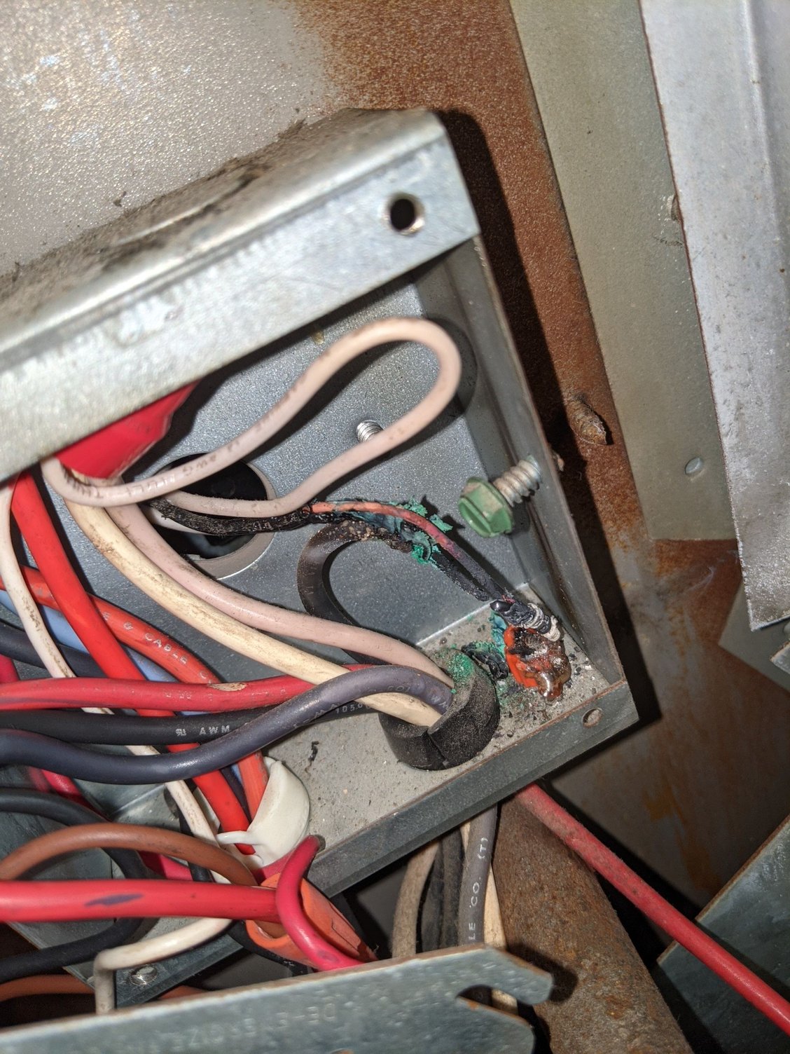

When I see voltage issues with those old consolidated furnaces I usually start with the door switch. The 16 gauge wire connected to the door switch is often melted.

Door switch wire melted
When I see voltage issues with those old consolidated furnaces I usually start with the door switch. The 16 gauge wire connected to the door switch is often melted. -From houston204
YES. Power to switch melted on my unit. Unit is almost 30 yrs old. Replaced control board couple years ago.
In picture you can see
that it melted in the box at the wire nut. Really melted! Why would this happen? Would this indicate that transformer is bad?
Old 08-20-21, 11:02 AM
R
Join Date: Oct 2016
Posts: 2,135
Received 185 Upvotes on 169 Posts
It doesn’t. It would indicate a loose connection.

So the wire nut was not tight and over time it eventually melted? (That's what I wanted to hear)
Meaning I can just replace wiring and all should be good. Right?
