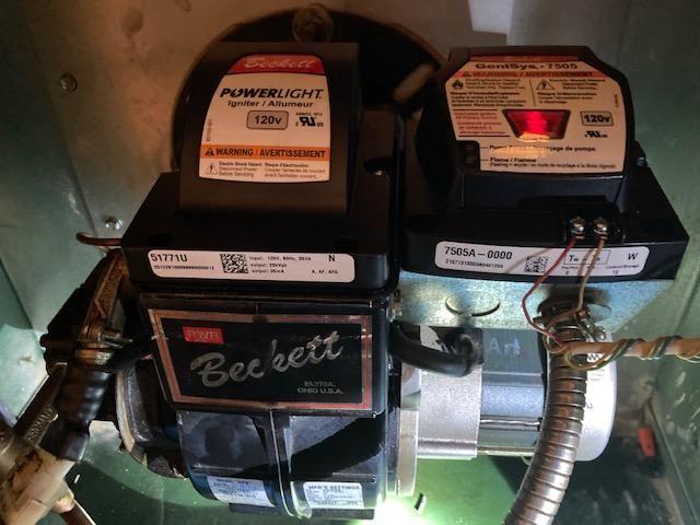

Hello, my oil furnace is 18 years old. I have it serviced every year, last winter I had to reset it a few times so I called in a technician to diagnose why. They replaced the flame censor and made sure the airflow was good. He said it was in good shape and running efficiently. But I still needed to reset every couple of days. I had that company come back at least 5 times until they finally said, "sometimes you have to wait for it to completely fail for you to know what is really going wrong." So this fall I had it serviced by a different company and explained the problem. This company said it was an old relay and changed it. 5 days later I've reset it 4 times. Any idea what can cause this? I have honeywell control board and honeywell thermostats in my 2 zones.

Can you provide some details on the equipment? Make & model of furnace or boiler, burner brand (Beckett, Carlin, Riello, & Wayne are the most common)
Old 12-02-21, 11:20 AM
P
Join Date: Jun 2007
Posts: 12
Received 0 Upvotes on 0 Posts
Old 12-04-21, 07:28 AM
Grady's Avatar
Join Date: Jan 2005
Posts: 12,667
Received 39 Upvotes on 37 Posts
The type of motor on that burner is not noted for having intermittent starting problems, nor is the ignitor. I should note that I am not at all fond of the primary control. As far as the zone control panel: Once there is a call for heat and it sends a signal to that effect to the primary, it's job is done. If your tech has the tool, he/she should be able to read fault codes from the primary control.
