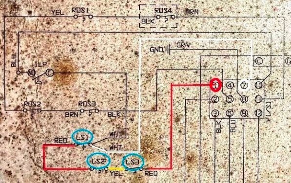

If you get a chance... post the wiring diagram on the back of the blower door.

Hope you have enjoyed the holiday. I got more info about the issue and share a few pictures and two videos here:
https://photos.app.goo.gl/vKCwMoxDK165Q2NB6
The wiring diagram is in the shared album, a bit dirty but I had it in high resolution, you can zoom in and see it clear, if not, please let me know.

Your furnace has three flame rollout sensors and three limit switches.
You replaced one of three limit switches. I've highlighted them on the diagram.
They form a loop from pin one to pin seven. Any one switch opens cause a high heat code.
You need to trace the wiring to locate the sensors.

Thanks Pete! I traced the cables and found the other 2 limit switches in the blower(lower) section of the furnace. Please see the 5 attached photos below for the switches(LS1 is the one I newly replaced). "1" in the diagram is labeled "HLO" on the circuit board, "7" is labeled "HLI"(also see the photo below).
I looked up the parts at https://www.repairclinic.com/ProductDetail/1385456 for my York furnace, and found the same limit switch here: https://www.repairclinic.com/PartDet...321700/2332741 (looks the same), however, the part is marked "Flame Rollout Limit Switch", I would guess it was mistake on the website, but please correct me if they are the same stuff.
Please advise what's next. Thanks again!
LS1 in the upper section (newly replaced, but the old one could be still good)
LS2(right) and LS3(left) in the blower section
close view for LS3
close view for LS2
red cable and white cable connect to the board (HLO and HLI)
