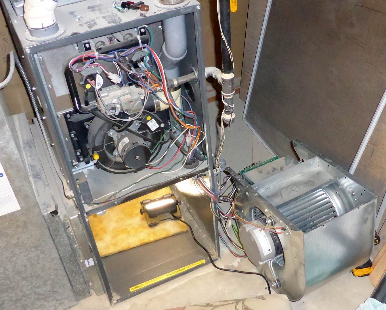

Because of their age, my wife and I recently examined the secondary heat exchanger of the main-level unit. Below are a couple of photos of the furnace with the fan assembly removed and a couple of the heat exchanger looking upward toward the bottom of the furnace (from where the light is looking upward).
I am no expert by a long shot, but I think the heat exchanger looks more than acceptable. The inlet/outlet temperature rises in both furnaces are perfect.
The reason that I've started this thread is that I'm presently buying spare parts for whichever indentical furnace will inevitably have problems in the future. (The availability of parts may become an issue and I cannot afford to be without heat at -36 or even lower. What better to invest in than spare parts?) I have already purchased a new furnace control board and new gas valve. In the next few days I intend to buy a new igniter, maybe new draft-inducer assembly, two pressure switches and maybe new ECM motor -- all shown in the first photo.
1. The ECM motor 0131M00270S) is very expensive new. I have access to the same part-number, but 5-year-old motor which is supposedly in good condtion. It is no longer in a furnace, so it's impossible to know if it will actually operate correctly. The asking price is a bit over $400CAD. Would you buy that motor and, if so, what would be a reasonable offer for it? Is there a quick and easly way to test it with a multimeter? The electronics in the end bell of the motor is embedded in epoxy. Is it possible to get at and repair the failed electronic components in that end bell? (I understand that 99.9% of the time it is some component in the end bell that fails, not the motor itself.)
2. The inducer assembly (0271F00126S) is a pricey little devil, too. Most of the time, what is it that fails in this type of assmebly - the motor? the impeller disk inside? what? Can I use another part that looks virtually identical to the assembly in our unit, or do I have to stick with Goodman OEM?
3. Can I use non-Goodman pressure switches that have the same pressure specifications as the Goodman OEM (020197308 and 011177113)?

I've betten the bullet and bought a bunch of new OEM parts, so I have no more need for any advice.
So now I should be able to handle any part failure, even if parts are no longer available on the market due to "supply chain" issues, and even if it's -40 outside. That's a pretty comfortable feeling going into our next winter (around here, sometimes beginning in the month of September!).
