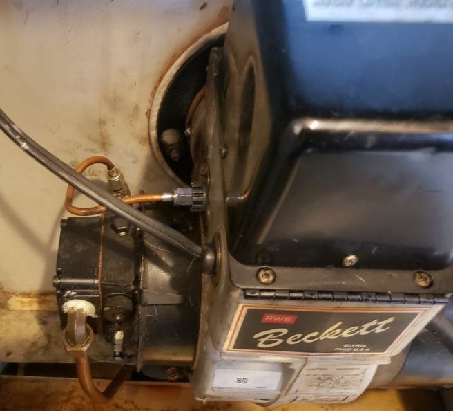

Unfortunately a non contact tester only checks for hot. You could have an open neutral.
Everything will check hot but with no neutral nothing will run.
I added an arrow to your first pics.
The motor reset mentioned may be on the end of the burner motor where the red arrow is pointing.
It could also be somewhere on the side as shown below.

Thanks! Found it. Pushed it several times... nothing

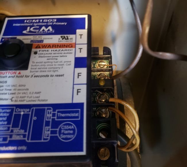

I forgot to add. In my second picture down from the top, the little yellow light where the cad cell and thermostat is wired is lit up when I push in the safety switch on the door, without actually closing the door. Not sure if that is supposed to be lit up or?

I believe that's the CAD cell status LED. Locked on indicates no flame or is in lockout.
It's covered in the pdf manual I left you.
That LED indicates you have 120v and that the limit is ok.
No firematic device.
