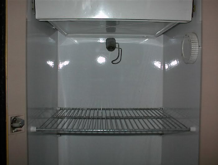

First off, I don't recommend trying to defrost a fridge in a 20° garage. Took me almost 3 hours using a 1500 watt heater and a heat gun.
Never thought of the socket but I was worried about the wire going to it. It seems it is rubber on the outside, haven't seen the wires yet.
Greg,
Condenser? I've no idea. All I can say is the back is just steel, no fins or anything and I don't see anything in the bottom kick plate.
This picture didn't turn out too good but the tubes from the freezer go into the top of the fridge. Any ideas about that and where the condenser might be?
Thanks once again,
Baldwin

Ok, I was thinking you had a modern fridge but yours appears to be 60's vintage.
Drill away!
You might be ok if you use a 15 - 25 watt bulb..........It would likely not be on a great deal of time.
