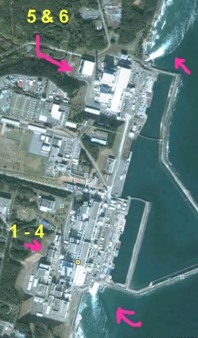

Not sure what you mean by this. From what I've heard, once seawater is put in the reactor itself, the reactor is unusable, TU. Now, seawater may be used to cool after it is turned into steam, but not in the reactor itself. Picture below from 2004 shows water outlets to sea and I don't see any huge cooling towers like we see at Three Mile Island. So, I'll guess they use seawater somewhere in the cooling process.

Well....maybe you should. Take a look at the first picture, showing reactors 1-4 on the 12th, four days ago. Since then there has been an explosion or two and fires.
Satellite Photos - Japan Before and After Tsunami - Interactive Feature - NYTimes.com

Here's a much better photo I just found.....
