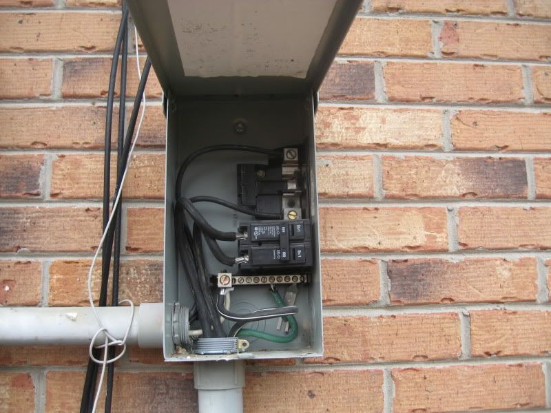

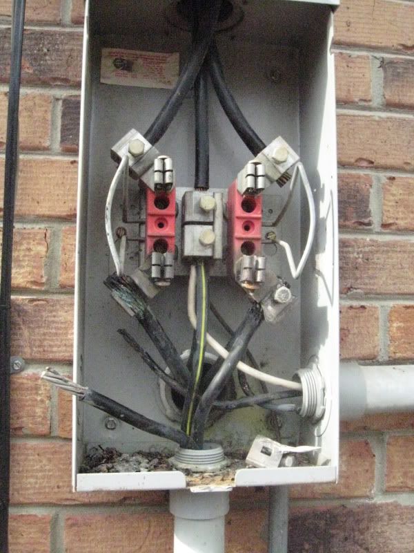

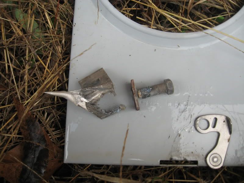

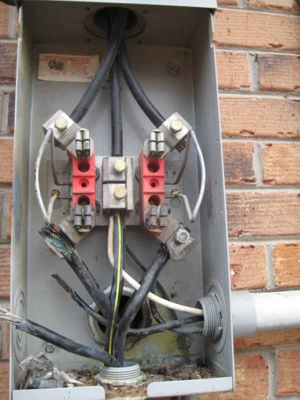

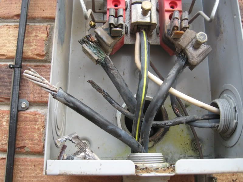

A lady from a Christmas lights forum sent me these pics of her meter base after losing a leg and having to call an Electrician. She hired the original "electrician" a few years ago to install the Aluminum line to her Garage and a panel for her lights. I figured I'd share these with you.

I'm not real swift on electrical. Can you explain all the offending situations here? My guesses are that you shouldn't be tapping in at the meter base like that. It looks like the one lug blew off. The other panel looks like a suspect ground connection to the neutral bar.

Subpanel looks OK, with the exception of the two grounds under one screw. No wait, is he energizing the subpanel with the smaller wires??? Then feeding with SE? You can't tap into a meterbase, period. I can't tell if this is from underground or not. If so, they tapped into the hot side. If overhead, he illegally pulled the meter to do this. If he was an electrician, he should have his license pulled and prosecuted for reckless endangerment and made to pay for the retrofit.
The two neutrals under one screw, the smaller one is CU, the larger is AL. This a service disconnect for her lighting panel. Also note the BR breaker in the Siemens panel and lack of a grounding electrode conductor.
He tapped 2) 100A panels off this 200A meterbase.
It's an overhead service, he tapped off the load side of the meter to feed the garage panel. Also note the tap for the garage is aluminum with the other conductors being copper.
This was done by a liscenced EC that worked for a large company. She is working on prosecuting him now.
