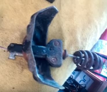

Now just in case I'm doing something wrong, here's a video (short and simple) of the lift mechanism and safety device I'm dealing with. When the tire is all the way down and on the ground, that flange and safety device are under the wheel. When together the flange and safety device will not fit up through the center of the wheel. The wheel has to be tilted up enough to work under it and drop the safety device below the flange. Then the flange can be turned vertically to fit up through the center of the wheel.
https://www.youtube.com/watch?v=pV3DLNgGIn0
Any tips or tricks for this specific arrangement?

Okay, now I see your heartaches. Mine looks more like the new one he bought. If you want to go without the safety latch just cut it off??

I know I have old truck but I have no saftey latch or spring in the end period. I dont remember any on my chevy trucks having it...
I have to say the truck I have now is the newest I have owned,,, 1996 so dont know when they changed that...
Sorry..
If I did have that and issues as stated I would be doing this I think...
PU of course.. van , suv, IDK...
But I guess all you guys with the latch have got to lube it....
Who knew....
https://www.youtube.com/watch?t=11&v=qhZ2LP7nfLU

Sorry, didn't see the forest for the trees.
When the tire is all the way down and on the ground....
So, you can't get all this junk through the center hole in the rim once it's down. Hmmmm...good question.
Maybe you need to unwind the cable more to give you additional slack?
Curiosity question: how is that supposed to work? Lower the tire till it stops, crank it up a bit to release the catch then lower it to the ground? I watched both videos a few times and still don't get it.

It's a PITA, my Dad had an old GMC and it was similar. Lower the tire, then a bit more, lift the end of the tire and flip the bracket to slide through. I think my '98 Dakota was pretty much the same thing.

Baldwin, in that picture in post #21, spring to the right with the safety mechanism poking through the metal flange to the left. On the right end of that safety mechanism there is a button of sorts sticking out that the spring pushes against when the weight of the wheel is there.
When that button is pushed in the latch on the left end of the safety mechanism is retracted. If the cable were to break, button pops down and safety catch pops out and hopefully prevents the wheel from falling more than the length of the safety device, about 3 to 4 inches. Apparently that will pop out at some point and not retract so even when trying to lower the wheel the catch will prevent it from coming down, thus the many YouTubes explaining how to get out of that situation.
@GG, "Lower the tire, then a bit more, lift the end of the tire and flip the bracket to slide through."
Easier said than done. At 68 years old a 275-70-17 wheel is not something I can easily lift, at least by reaching under from behind the truck. Only way for me is on my back in beside the wheel, now on the ground, two hands to tip it up and hold it there with my left arm while spitting out old rust that is falling in my face. Then with my right hand, fiddling with that safety mechanism and bracket to get it up through the center hole. And the ends of that bracket are shaped differently so only one end goes up through.
I actually don't know how long the cable is as I was reluctant to unwind it all the way. That assembly does not come apart so a tangled cable inside would mean a new assembly.
But then there is getting the shaft of that cranking mechanism onto the square nub, as previously described. Took a deep breath and back under the truck to guide the shaft onto the nub. I have seen in some videos of some brands where they have a tube that guides the crank shaft. I may have to fabricate something of that sort.
