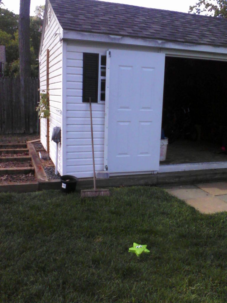

I used 6x6x12 treated lumber.
My shed 12X16
Filled with 4" gravel base.
Bolted the wood together, and good thing I did. The weight of the rocks and the shed tend to push the gravel outwards.
I think you should do the wood. Its pretty attractive IMO. I also used the same to make my ground level deck.
Here is a pic to help you decide. Best pic I have of the shed.
[IMG][/IMG]

Old 05-11-12, 03:59 PM
lawrosa's Avatar
Super Moderator
Join Date: Dec 2010
Posts: 15,984
Received 79 Upvotes on 71 Posts
Here are more pics of my boxed shed.
Also next to the shed I had a deck but I took it apart today. I am making room for a chicken coop.
But you can see how its boxed is the same with the shed but filled with gravel. And of course less the 3 ties in the middle.
Hope this helps.
Mike NJ
