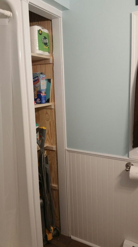

I need a special door hinge
I have a narrow closet next to a shower that's framed for a 16 inch door, with the jamb flush with the wall. I'd like to mount a towel bar behind the door. To do that properly I need a hinge that would kick the hinge edge of the door in a couple inches so the face of the door doesn't hit the bar.
Is there such a hinge?

European cabinet hinges have an extra knuckle that allows the door to swing way out of the opening--without hitting the strike jamb as it opens. This is opposite what I need but it's kinda why I think a complex movement might be out there if I knew what to call it.
Way back in the dusty corners of my mind I seem to recall seeing big doors on a commercial building (bank, museum, etc) where the hinge side of the door dropped back a few inches and then swung open when you tug the handle.
CT might be on the right track to a simple solution, if I understand his pivot suggestion. Move the "hinges" (pivots) 2 inches toward the center of the door and the hinge edge will swing IN and when the door is at 90 degrees it will be 2 inches from the wall.

Wow--now that IS a special hinge! It's pricey at almost $200/pr (and I'd need at least 3 hinges) but I'd seriously consider it if I hadn't already framed and trimmed for an inset door. There's a 3/4" thick molding trimming out the shower and I think an overlay door would look clumsy covering part of that, and covering the edge/trim of the beadboard on the outside wall.
I might actually install a piece of ply or particleboard on bi-fold door pivots to see if I like it. Might also consider an accordian, or a curtain, or a *very* narrow bi-fold that opens left. A bi-fold gives me more room than a left-swing full door which would have me backed into the toilet to retrieve something from the closet.
